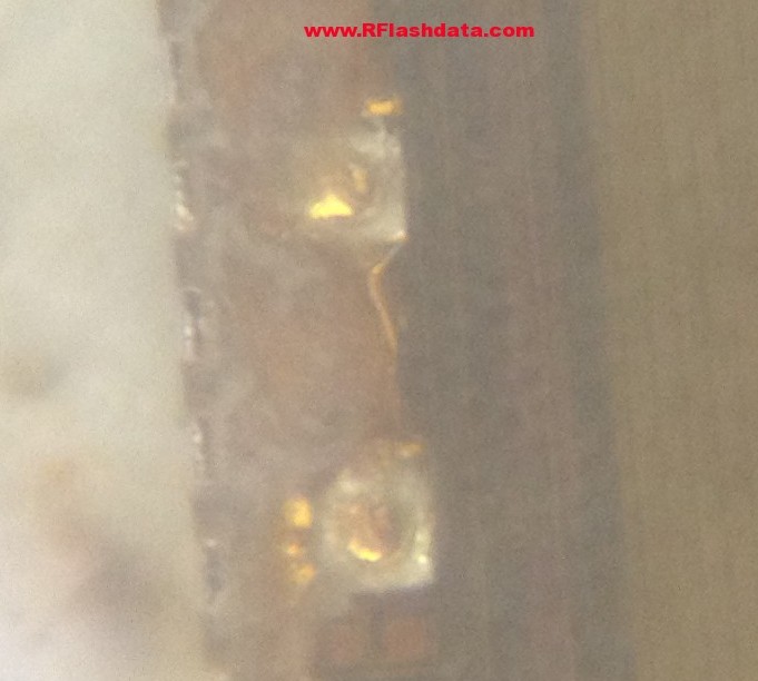

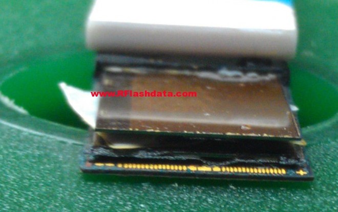

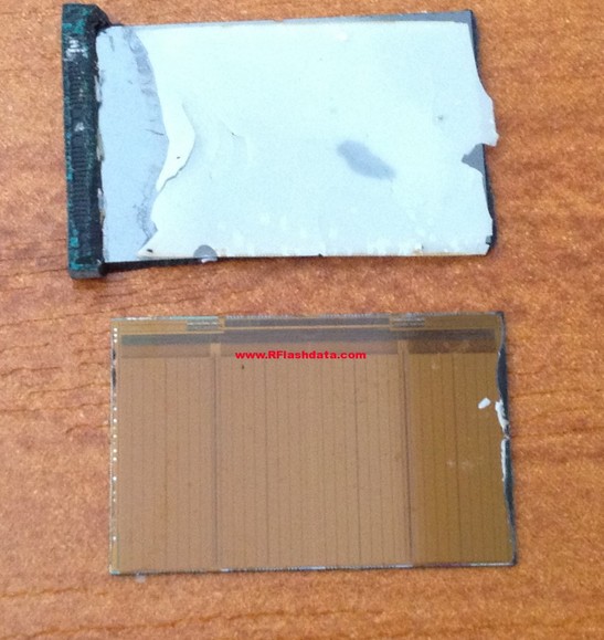

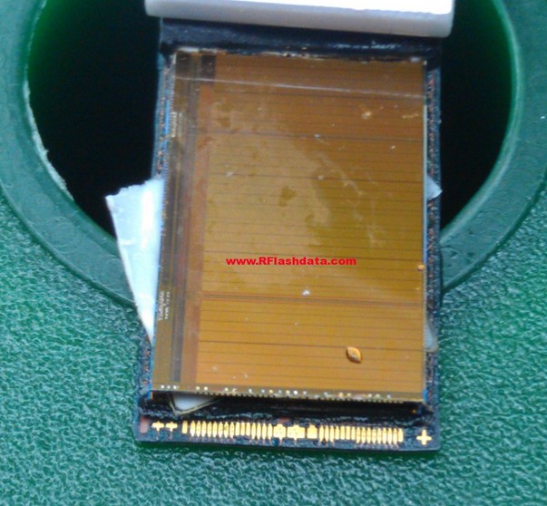

 Post subject: disassembly monolith flash drive
PostPosted: August 2nd, 2013, 22:26
Posts: 1151
more details photo http://www.rflashdata.com
File comment: monolith pinout
File comment: monolith flash drive data recovery
File comment: monolith data recovery
File comment: disassembly monolith flash drive
File comment: disassembly monolith flash drive for data recovery
disassembly monolith flash drive for data recovery 1.jpg [ 88.56 KiB | Viewed 8372 times ]
data recovery service[/b]
 Post subject: Re: disassembly monolith flash drive
PostPosted: August 2nd, 2013, 23:09
Posts: 3973
Nice :-)
data surely not recoverable after this.. this is a demo of what internals look like isn't it?
What magnification is that at around 100-200x ?
really cool!
PostPosted: August 3rd, 2013, 2:30
Posts: 1151
i think data still can be recoverable. as chip no damaged.
for this case. it's bad donor drive. pinout made. but i have problem with read dump so i want to check inside connection.
how many X i am no sure. around 60~80X only
PostPosted: August 3rd, 2013, 2:39
Posts: 3973
I hope you can get data, good luck.
So how do you connect wires to something so small. I thought it was hard enough to connect to the regular row of 40 pads on the outside of the monolith, but this is a whole different level.
It is really interesting to see things Ill never see in the flesh, so thanks again.
PostPosted: August 3rd, 2013, 22:56
Posts: 1151
this case connect wire easy.
http://www.rflashdata.com/kingston-1g-sd/
it's hard for me. i make this solution with luck. need improve skill for process such case. as many case like this.
