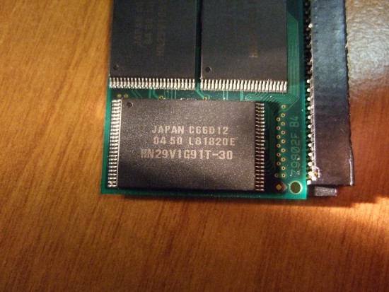

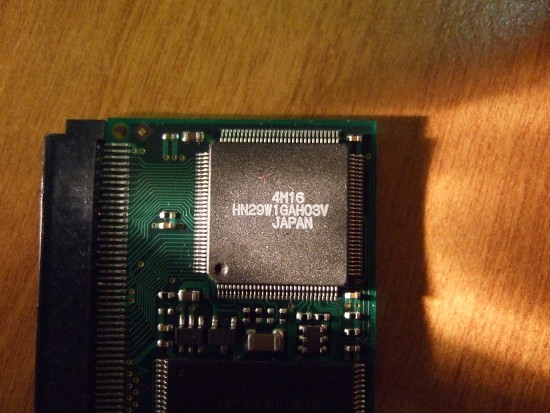

I have a case with an HN29W1GAH03V controller and 4 HN29V1G91T-30 chips :
File comment: HN29W1GAH03V
File comment: HN29V1G91T-30
I managed to find that there is a bitwise inversion and the page transformation :
Page size  2112
Sector size  552
Structure*
0-512;2080-32;512-8;
520-512;2080-32;1032-8;
1040-512;2080-32;1552-8;
1560-512;2080-32;2072-8;
But then I'm stuck.
I found something in the FE old forum (link) but I don't have FE so I'm not used to it.
If someone could help me or at least give me direction to solve this with PC3000 Flash, that would be great.
Thank's
