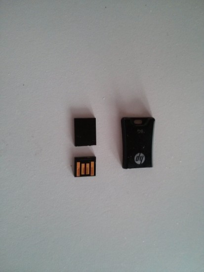

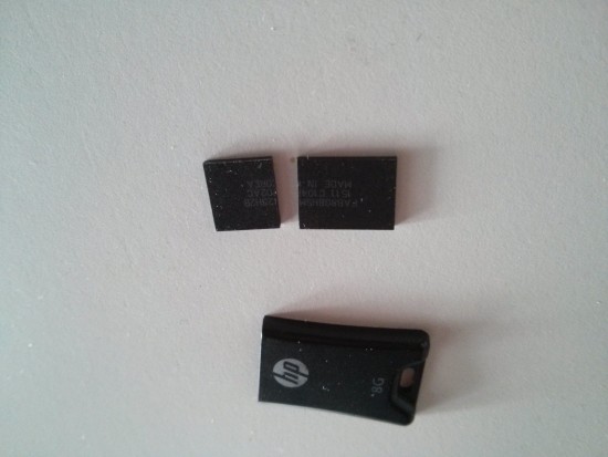

I have this flash drive from a client like the photos can show.
Is there any change of recovery?

Probably no. But please compare traces under top layer with photos here: http://www.odzyskiwanie-danych.com.pl/m ... abase.html
Which layout have your case?

i think it no chance to recovery. chip broken

There might be some chances, but it's a very complex job for sure.

Thanks Guys.
Gotta to outsource it.

Nand broken. 100%.
