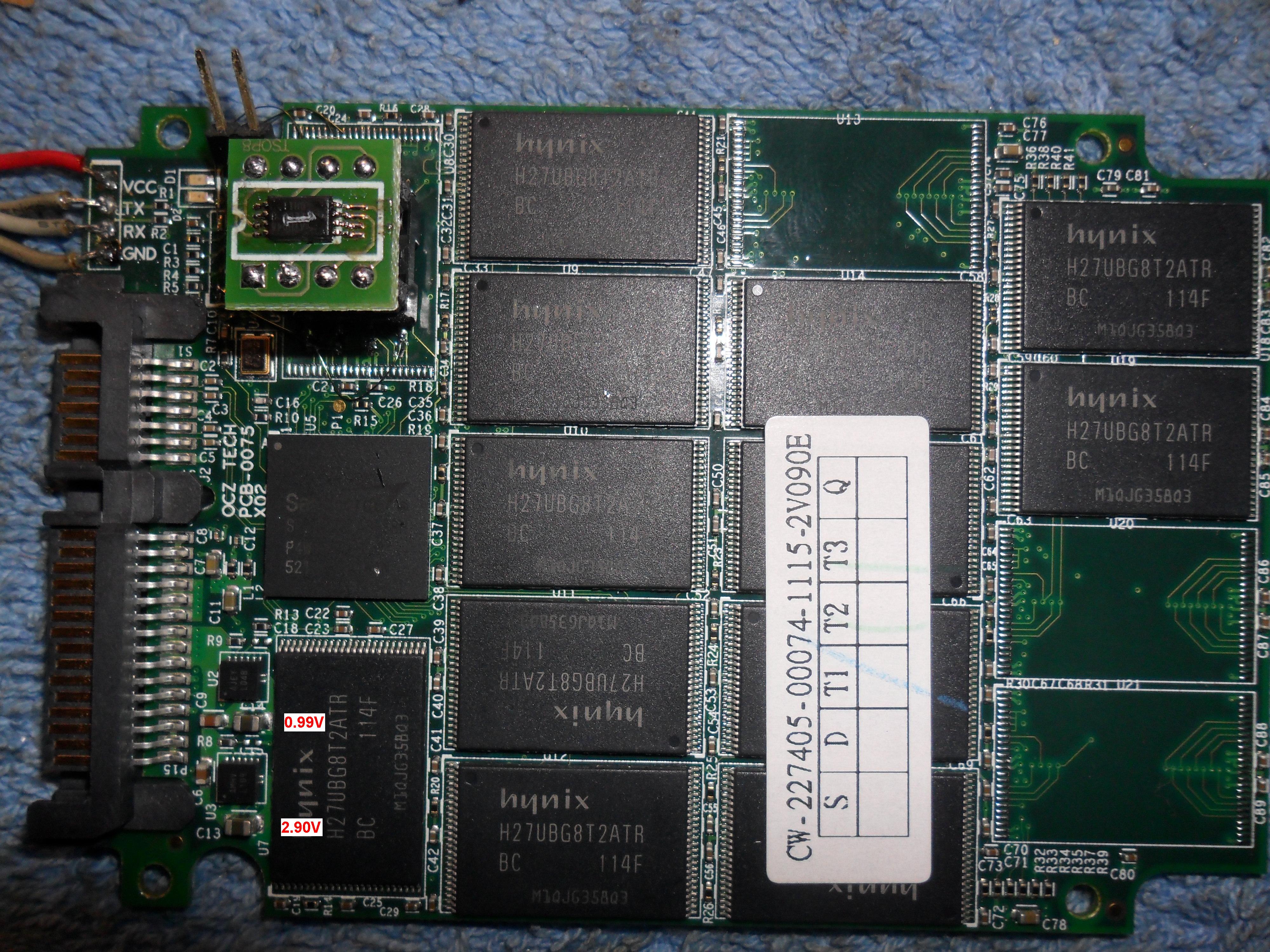

Hello.
OCZSSD2-2VTXE90G
BIOS will not recognize SSD.
Console:
CLI> PINRST
*** ROM 106 Mar 12 2009 20:29:35 ***
FW_SRC 0 SHA PASS!
*** EEPROM 207 Jan  3 2011 18:36:43 BuildServer:FW_Common_Critical_Fixes:P1_EEPROM_2_0_7_drop-290232 ***
Hynix Timing EPch
*** Patch 1.4.1 Apr  8 2011 00:57:34 BuildServer:P1_3_6_1_MP4_Patch1_20110408:P1_3_6_1_MP4_Patch1_20110408-305073 ***
Hynix Timing EPch
RCPch SAK0+Fmgr
˙ýŢŤĂţ
Can anyone decipher consoles dump?
Has anyone 24C256 EEPROM content?

Can you post full terminal log after this ˙ýŢŤĂţ ..... ?
Why you interested in EEprom content, how it is going to help you? Better tell what is your goal about this ssd drive and what condition it is now (busy ?, Id ? safe mode? ) ?
MCU sf-1222 or sf-1281 ?

I'm trying to run this drive, the data are not necessary to me.
SF-1222TA3-SBH
Log output is xor ?
File comment: EEPROM AT24C256

 Post subject: Re: OCZ VERTEX 2 90GB not work
PostPosted: August 20th, 2013, 3:06
Posts: 3973
have you tried different term settings? it looks like the baud rate might be wrong even though the initial bootup is seen ok
PostPosted: August 20th, 2013, 3:48
Posts: 17226
Those hynix parts are specified for 2.7V - 3.6V with a nominal operating voltage of 3.3V. Assuming that the 2.90V reading is correct, and assuming this is the flash supply voltage, then these parts are being operated at the bottom end of their design range. It's curious because there was another thread involving a dead Vertex 2 SSD where the flash supply was 2.8V.
H27UBG8T2A Series 32Gb (4096M x 8bit) NAND Flash:
http://www.szyuda88.com/uploadfile/cfil ... 220663.pdf
I wonder if the reduced flash Vcc could explain why OCZ SSDs appear to be significantly less reliable than similar products from their competitors?
PostPosted: August 20th, 2013, 8:41
Posts: 3593
Location: Chicago
I don't think so
Moreover lowering voltage of NANDs could improve reliability
Also could you please provide statistics on what you based this conclusion "OCZ SSDs appear to be significantly less reliable than similar products". Such statement seems strange to me

Log out:
We ELF header :)
