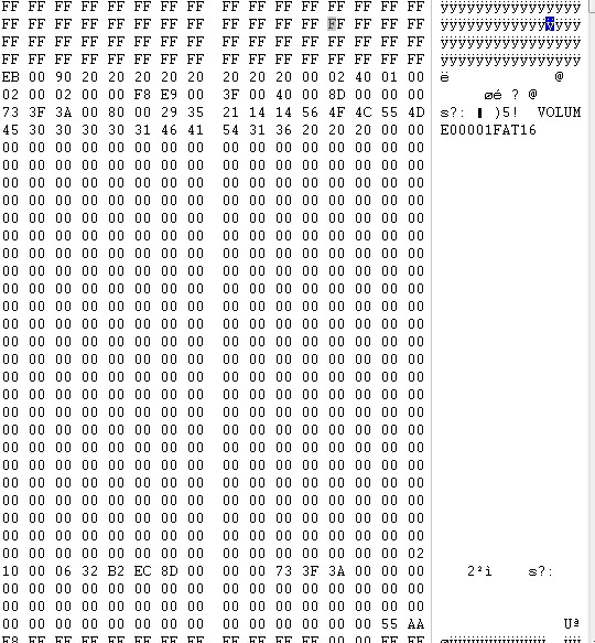

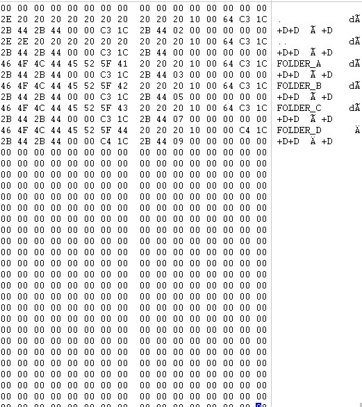

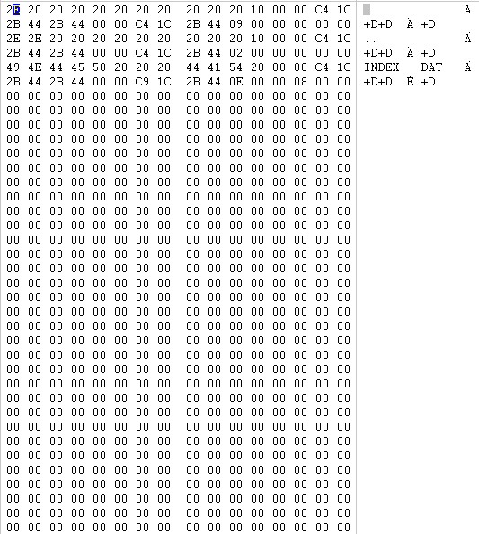

data recovery service[/b]

AFAICS, OLM.jpg is a standard MS FAT16 boot sector with a standard MS partition table at the end. That is, it is a boot sector and MBR in one.
http://averstak.tripod.com/fatdox/bootsec.htm
The partition table contains a single FAT partition (type 0x06) beginning at sector 0x8D and with a size of 0x3A3F73 sectors.
The BIOS parameter block at the beginning of the boot sector indicates that the sector size is 512 bytes, cluster size is 64 sectors, and that the volume begins at physical sector 0x8D and has a size of 0x3A3F73 sectors.
0x3a3f73 x 512 = 1 954 473 472
It would appear that the card has a capacity of 2GB.
The first 16 bytes of the next sector are consistent with a 16-bit FAT, namely "F8 FF FF FF FF FF FF FF FF FF FF FF 00 00 FF FF".
OLM1.jpg looks like a regular FAT root directory.
OLM2.jpg is the FOLDER_D directory.
ISTM that the clusters are assigned as follows:
Cluster #   contents
02          root dir
03 - 04     FOLDER_A
05 - 06     FOLDER_B
07 - 08     FOLDER_C
09 - 0A     FOLDER_D
0B          FOLDER_A\INDEX.DAT
0C          FOLDER_B\INDEX.DAT
0D          FOLDER_C\INDEX.DAT
0E          FOLDER_D\INDEX.DAT
I presume that the card was formatted on Jan 11, 2014 and that FOLDER_D contains no data. If so, then all the file system structures appear to be consistent with a FAT16 volume.
ISTM that one would simply mount the FAT16 volume beginning at sector 0x8D. As a precaution, I would write zeros to the partition table so as not to confuse your data recovery software.
In short, I don't see anything special about the file system. Does it look any more complicated when voice recordings have been saved to the card? Is that where the difficulties lie???
