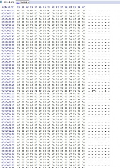

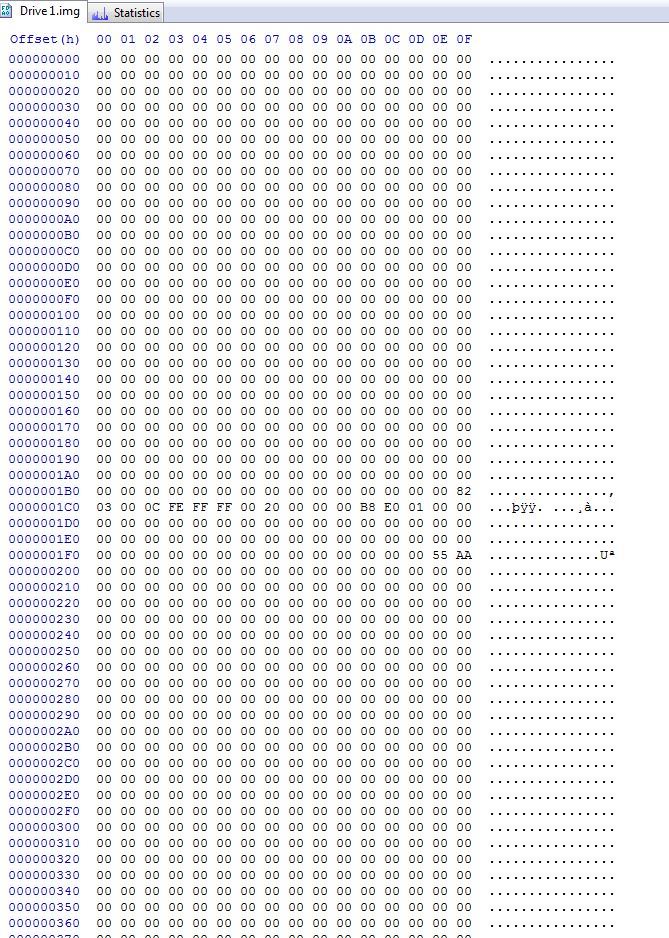

I tried HxD Editor and the attached shows the results, all zeros except the middle section in the photo. Does that mean anything? I guess my low level format was a high level format which wiped out the data. It only took 8 seconds when I formatted the card so I was thinking it was a quick format and not a complete wipeout. I immediately ceased using the card and tried data recovery. I do not know anything about data recovery but I knew this was a good place to ask. Any additional suggestions are appreciated.

Sector 0 contains a partition table with a single FAT32 volume beginning at sector 8192 (= 0x2000).
The size of the volume is ...
0x1E0B800 x 512 = 31504384 sectors x 512 bytes per sector = 16 130 244 608 bytes
AFAICT, the GetDataBack report is telling us that cluster #5 (logical sector 8384) is the last cluster of the newly formatted file system. Since the cluster size is 64 sectors, this means that the user data must start at logical sector 8448. That's physical sector 16640 (= 8448 + 8192). I'd start looking there.

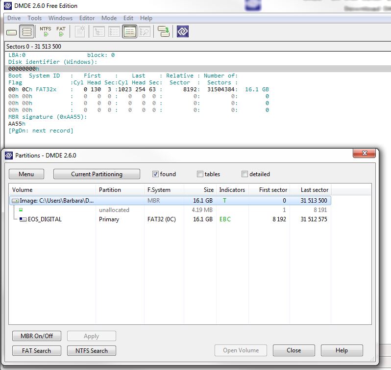

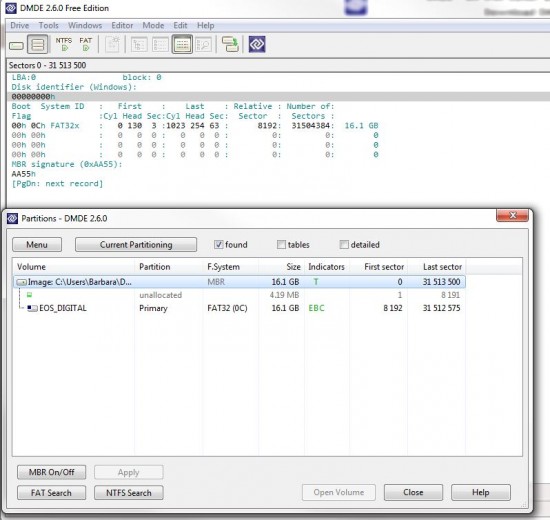

Wow, I am thankful for the suggestions but you are getting over my head. However, I did run DMDE and attached are the results. Did this give any additional insight? I'm going to work on digesting the remaining information you have provided. It's like Greek to me but I'm eager to work through this.
 Post subject: Re: SD Card Accidental Format
PostPosted: November 18th, 2013, 0:31
Posts: 17335
pcimage asked you to search for non-zero data. You have responded with a dump of sectors 0 and 1. You now need to scan through the remaining 31 million sectors.
