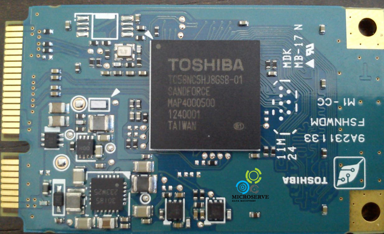

Hi,all
i am facing Toshiba 256GB ssd issues like Dead or Not Detected anywhere.as per my guess Toshiba Controller/associated components as per attached picture Can be faulty?if the problem with memory chips it will detect at least Controller?anybody having Data Sheet for same SSD or Controller itself to detailed analysis.
 Post subject: Re: TOSHIBA 256GB SSD-DATARECOVERY SOLUTION
PostPosted: February 14th, 2015, 5:34
Sandforce :-(
PostPosted: February 14th, 2015, 7:43
Posts: 922
It is Sandforce controller (rebranded by Toshiba) as pcimage write above. No solution so far.

it will not work simply replacing with proper tools San force Controller if Controller is faulty?as per symptoms no detection/Dead
PostPosted: February 15th, 2015, 4:36
Posts: 922
No. Not work.
PostPosted: February 15th, 2015, 8:18
Posts: 3977
In almost all cases, Flash Chips are "married" to the controller. Meaning once the unit is put together, mass production tools will look at the flash chips and information about them will be configured in the firmware. Things such as timing, bad blocks etc. Simply being the exact same parts is not enough. There are a lot of different ways flash and controller chips are setup to become a storage device, and I doubt there would be many cases where a controller could be switched out.

Thank you all supporting advice.anyway we are going to ready for SSD.i all ready discuss with Acelab for Quote of pc-3000 SSD kit&adapters.Thanks again all

Hi HaQue,
Does the information below apply only to SSDs ? I used to believe that Controllers for Flash Drives (not for SSDs) can be replaced by exact match ones as long as the original controller did not use dynamic XOR. Am I missing something here ?
PostPosted: February 19th, 2015, 17:41
Posts: 3977
No Matiw, mostly applies to flash drives as well.
