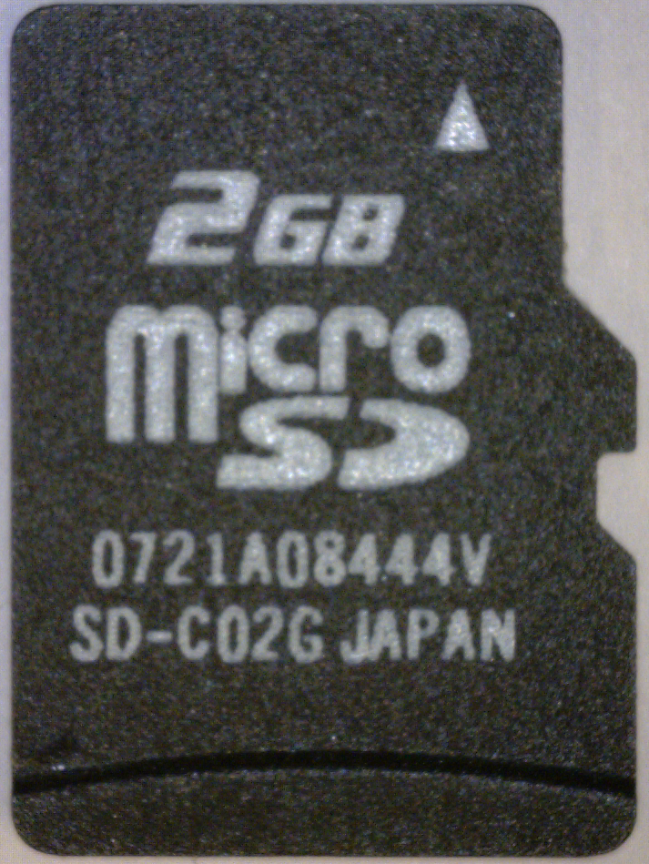

You probably know this, but if you can get the datasheet for the chip, it should have a breakdown of what the Chip ID means. I havent looked at it for a while but each bit in the ID means something.
The Chip ID is interesting, could you possibly post a picture, or say the chip manufacturer and Part number please?

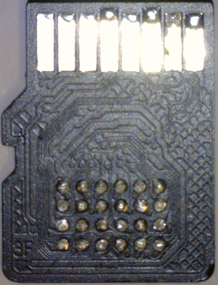

Here are the pictures :
Lemmy

100% sure it wrong ID. It may internal problem if you confirm connection correct. I can do deep analyze for such case.

Posts: 3973
I was going to say the same thing.
Btw, all the Kingston MicroSD cards Ive seen have the Kingston brand on them. Is it possible this is a fake?
I remember reading a writeup of a well known hardware hacker, bunnie, that investigated fake cards, went into quite some depth. It may or may not be the case here, but interesting anyway to read http://www.bunniestudios.com/blog/?p=918

you need change page size to 2144. last sector bigger then 532. it contain ecc and markers. it is kingston card.
some nand chip used only in mSD and difficult find datasheet, if you see page filled all with data try change page to bigger.

I'm not giving up so a quick update :
The µSD was resolder again (not by me but by a coworker) and I still have the same ID and same dump... So same not so good result in the end.
I found that on the Ace Lab help (http://www.pc3000flash.com/eng/help/hel ... d_read.htm)
AceLab wrote:
Byte 1 describes the chip manufacturer (Vendor ID).
Byte 2 describes the memory chip itself as a device (Device ID).
Bytes 3–n describe in vendor-specific format the settings of the internal memory chip structure including memory page size, memory cells type, presence of several segments, etc.
So I'm starting to think that the ID could be right.
I tried that and the result is that every byte afer 2112 is the same as the 2112 one so i'm guessing 2112 was the correct page size.
