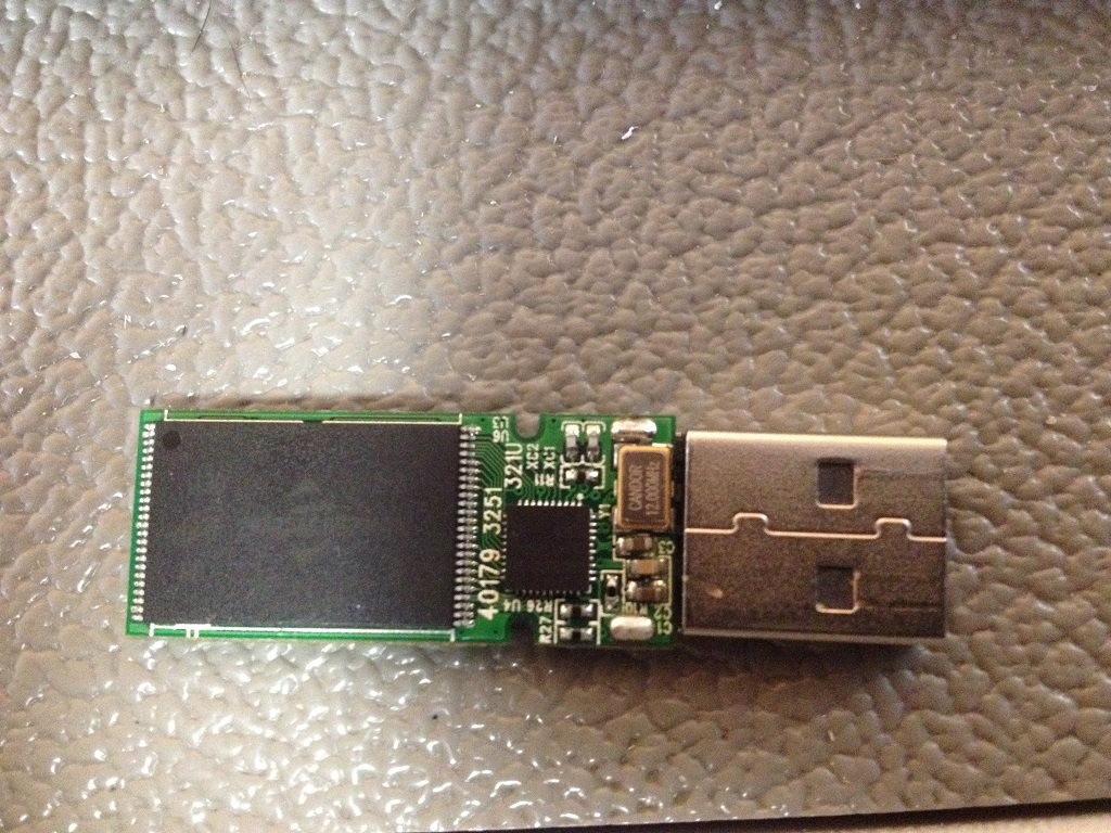

I have a 64GB Lexar USB flash drive. When connected to the USB port, it is typically not recognized at all. If I insert it slowly (LOL, that sounds wrong), I can get a message from Windows saying a device connected to the USB port has malfunctioned. If I twist it around (why does this sound so dirty?) I can sometimes get the LED to flash about 3-4 times, then it shuts off and the unit still isn't recognized.
I don't have any 12 MHz crystal oscillators (four-pin) but in the past I've had some units with similar symptoms where replacing the crystal (two-pin) has revived them. Worth a shot in this case?
Any ideas?

I looked at some other flash drives, I found a 12 Mhz oscillator but it is physically too large. I could solder some leads between the oscillator and the board, but ug.
So I looked at Digikey. They have five types that are within the size range I need, but I'm not sure what type this would be.
The units at Digikey are: MEMS, SO, TCXO, VCTCXO, and XO (Standard). Do I need the XO (Standard)? It can't be that simple, can it?
The types of output are "CMOS," "HCMOS," and "HCMOS, TTL." Any idea?

If you show me a photo of the board, I may have a matching one, or be able to tell you which USB Drive you can buy that might have a matching XTAL.
flash controller data sheets say to pay attention to how the circuit is laid out. They also mention which layer of the PCB some traces should be on, so for them to mention this, ISTM that it is not a good idea to wildly change the layou, such as using wire to join XTAL to board. It may or may not matter.
Also the capacitance of the XTAL might matter, for example some need a matching capacitor. You might be able to find the datasheet of your controller at places like flashboot.ru or usbdev.ru.
I am not convinced it is the XTAL..
Sounds great, I've included a pic.

That doesn't appear to be an oscillator. The existence of XC1, XC2, and R11 would suggest that the device is a quartz crystal. BTW crystals do come in 4-pin packages. Also, if the device were an oscillator, then it would have a power pin.
Okay thanks. So then we know (thanks 2 u) that it is a crystal, but has four pins that I can see. Any tips on finding a replacement that will be compatible?

Here are two datasheets:
http://www.vishay.com/docs/35064/xt35.pdf
http://www.adrirobot.it/datasheet/vari/ ... 2020pF.pdf
Obviously you would need to compare dimensions and pinout. I don't know about load capacitance, but I would expect that if you stick to a standard value, then you will probably be OK.
I would search Digikey, Mouser, Newark, Farnell, etc. Otherwise HaQue's suggestion re pilfering one from another flash drive might be the easiest solution.
That said, if the LED is flashing under control of the flash controller, then this would suggest that the crystal is oscillating. It could be operating at the wrong frequency, though. Like HaQue, I'm not convinced that the crystal is the problem.

This appears to be the datasheet for your device:
http://www.candor-co.com/UpFiles/articl ... 96%B09.pdf (CSX-3225)
