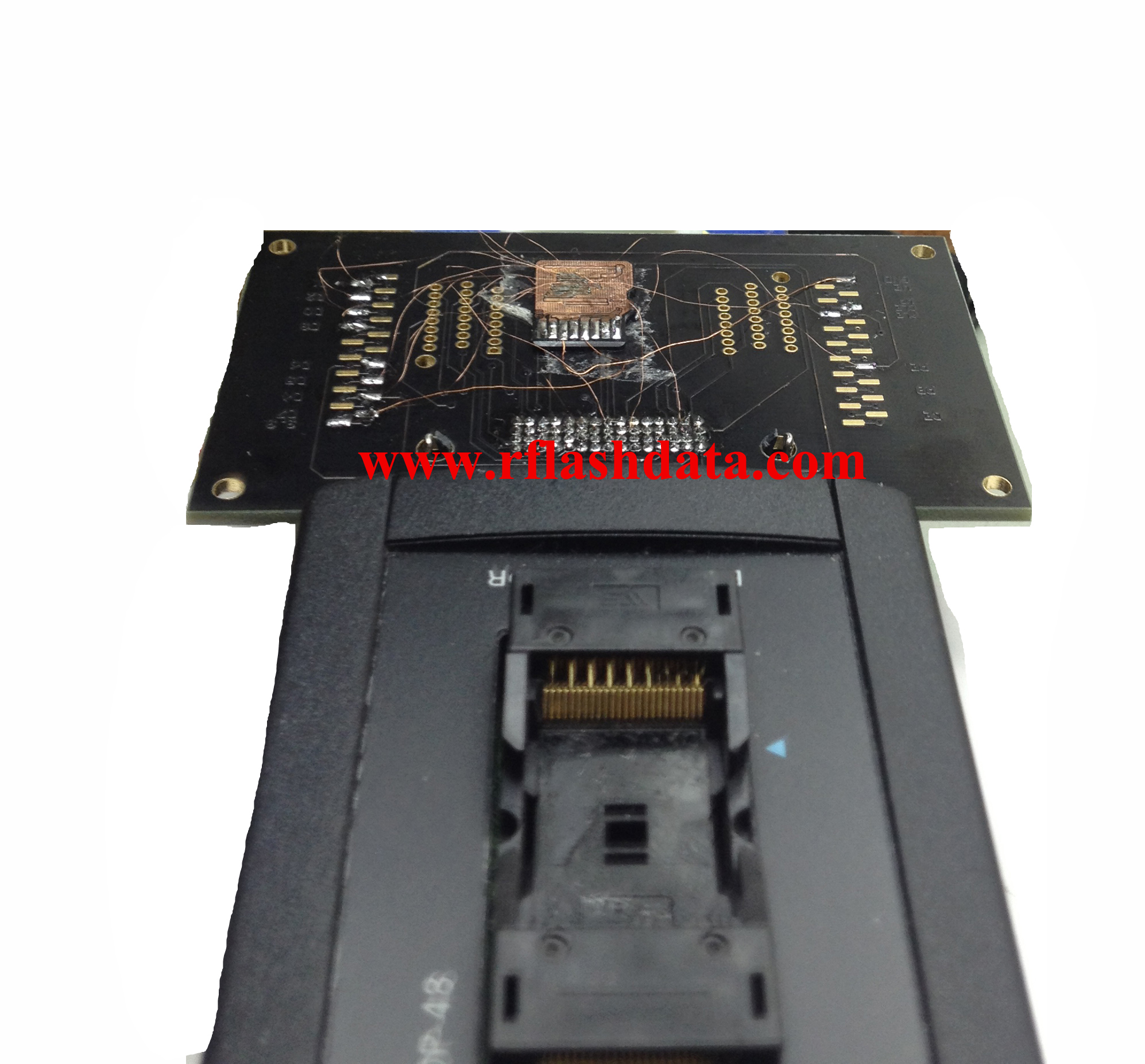

3.0 is good for me
it's the details of microSD which connect on wire adapter
http://www.rflashdata.com/ea2b063256685 ... g-microsd/
File comment: ACE 3.0 reader with wire adapter

Did you produce special adapter for monolithic by yourself?
Vladus
 Post subject: Re: PC3000 Flash (hardware ver 3.0)any good?
PostPosted: February 5th, 2014, 4:09
Posts: 1151
yes. it's rough version only. will do some change in next version of adapter.
data recovery service[/b]
PostPosted: February 5th, 2014, 4:19
Posts: 922
IMHO better way is modify adapter to standard ZIF48 socket. It is the most reliable and handy solution.
Show some photos would be great if possible.

networkpc3000 wrote:
3.0 is good for me
Are you selling the adapter yet?
yes.
