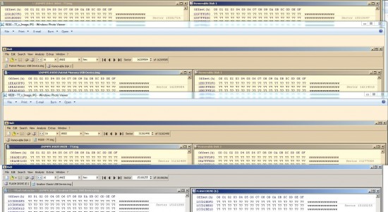

Possibly a dumb question that I havent thought about enough.
1. I write a pattern to the whole disk.
2. I tak an image of that disk with Partition Find and Mount.
3. I run HxD as administrator, and open both the image file and the physical Flash Disk that is still plugged in.
4. Tile both windows and scroll them both to the end.
Why is there a size difference?
in every instance there has been a huge size difference. sometimes drive shows bigger sometimes image.
Whats going on?

AIUI, PF&M would be taking an image of the partition (logical drive) rather than the physical drive.
I would examine sector 0 in each case. Is it an MBR or is it a boot sector? Does the capacity reported in sector 0 match the size of the PF&M image?

The capacity of the flash drive is being rounded down to the nearest whole cylinder.
63 sectors per track
255 heads per cylinder
15197490 = 946 x 255 x 63
(15 204 351 - 15 197 490) / (255 x 63) = 0.427
16209585 = 1009 x 255 x 63
16214016
31262490 = 1946 x 255 x 63
31277056
15101100 = 940 x 255 x 63
15100256
15502725 = 965 x 255 x 63
15515648

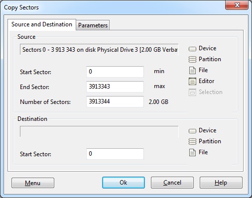

So the DMDE image shows the same last sector as the Physical Disk as I think it should. For some reason the Partition Find and Mount image is different. I don't know it the PFaM people have a different take on what to image, or if it is a bug. I will send of a question to them with my results and ask if that is by design, or if they have any insight. It is possible they don't support what I am doing, as the software is about finding partitions, not working in the absence of one. Or that the do something along the lines of what fzabkar has said. The do have a caveat after all..

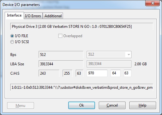

This is the Physical disk opened in HxD Hex Editor, and the next pic is a comparison of the 2 images I took, first PFaM and secon DMDE.

Size of physical drive = 3 913 344 LBAs
Using DMDE's two CHS combinations ...
243 x 255 x 63 = 3 903 795
970 x 64 x 63 = 3 911 040
It appears that PF&M is using the first set of CHS values. IIUC these values are coming from the SCSI driver.
