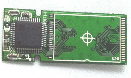

Not sure if you can see anything on these pictures, they are not the best quality. I took the connector off that I had soldered on in case it was masking any issues with the board itself. It does look okay to my untrained eye, so could have been some bad soldering on my part. To recover the data would you suggest a new connector (as the pads seem good), or attaching wires to the connector then to the board.

The 2R2 resistor (R25) appears to be in series with the +5V supply. If you measure the voltage across R25, this will tell you the current draw of the PCB.
Capacitor C5 appears to be the filter capacitor for the 3.3V supply for the NAND flash. Measure the resistance across it. This will tell you if anything is dragging down the controller's on-chip 3.3V regulator. Also measure the voltage across C5.

and yes, the soldering looks like it shouldn't have been an issue. Leaves other problems as the culprit.
a DR Guy should be able to read NAND and do normal DR.. IF the NAND isn't the one that is faulty.
Voltage across R25 is 3.3V. Resistance is 153.1 (with meter set on 200).
Voltage across C5 is .68v
The red light flashes on briefly when plugged in then goes out. It did stay on once for about 5 seconds before going out. Point you in any direction?

I think the flash drive is now failing. I noticed the controller chip no longer gets hot as I was testing it.
Voltage at R25 is now 4.3V
Voltage at C5 is 0.02V

Your readings don't make any sense. AFAICS, R25 is a 2.2 ohm resistor, so if there were 3.3V across it, it would be dissipating approximately 5 watts. OTOH, if its resistance really were 153 ohms, then it would limit the current into the flash drive to 30mA.

If the measurements are reversed, ie if the measurements for R25 are in fact the measurements for C5, then that would make some sense.
A voltage of 0.68v across R25 would amount to a current draw of around 300mA. My SanDisk 4GB/32GB Cruzer Blade/Edge flash drives are rated for a maximum current draw of 100mA, if you can believe what they report via UVCView or USBDeview.

So with my flash drive drawing 300mA, I guess that would explain why the controller chip got so hot. Is there a fix for this such as replacing R25 or C5?
 Post subject: Re: 4GB Lexar Controller Chip Getting Very Hot
PostPosted: February 25th, 2014, 19:56
Posts: 17396
The controller is dead.
You need to desolder the NAND chip and read it in a chip reader. Then submit the image to an appropriate tool that understands the LBA translation algorithm. This tool will then reconstruct the logical drive. Such tools are not free.
