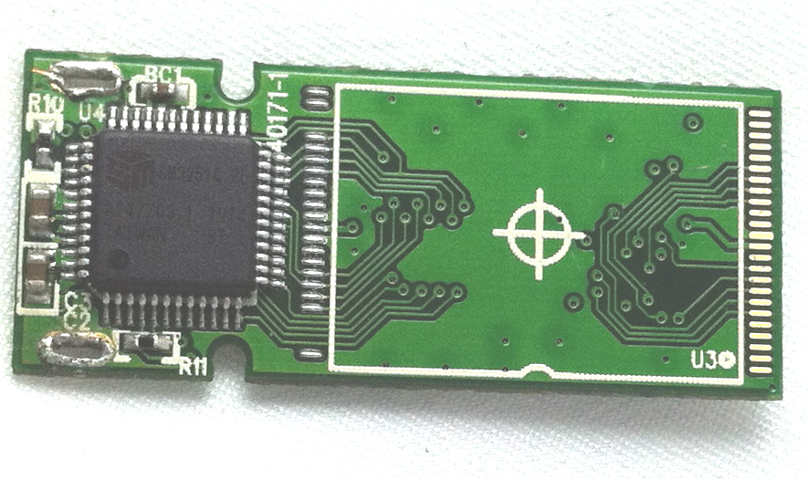

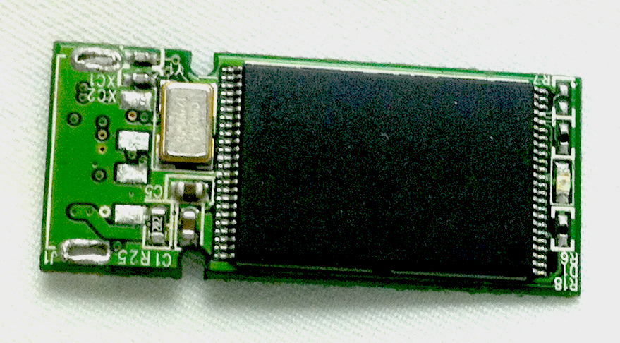

Not sure if you can see anything on these pictures, they are not the best quality. I took the connector off that I had soldered on in case it was masking any issues with the board itself. It does look okay to my untrained eye, so could have been some bad soldering on my part. To recover the data would you suggest a new connector (as the pads seem good), or attaching wires to the connector then to the board.

The 2R2 resistor (R25) appears to be in series with the +5V supply. If you measure the voltage across R25, this will tell you the current draw of the PCB.
Capacitor C5 appears to be the filter capacitor for the 3.3V supply for the NAND flash. Measure the resistance across it. This will tell you if anything is dragging down the controller's on-chip 3.3V regulator. Also measure the voltage across C5.
Voltage across R25 is 3.3V. Resistance is 153.1 (with meter set on 200).
Voltage across C5 is .68v
The red light flashes on briefly when plugged in then goes out. It did stay on once for about 5 seconds before going out. Point you in any direction?
