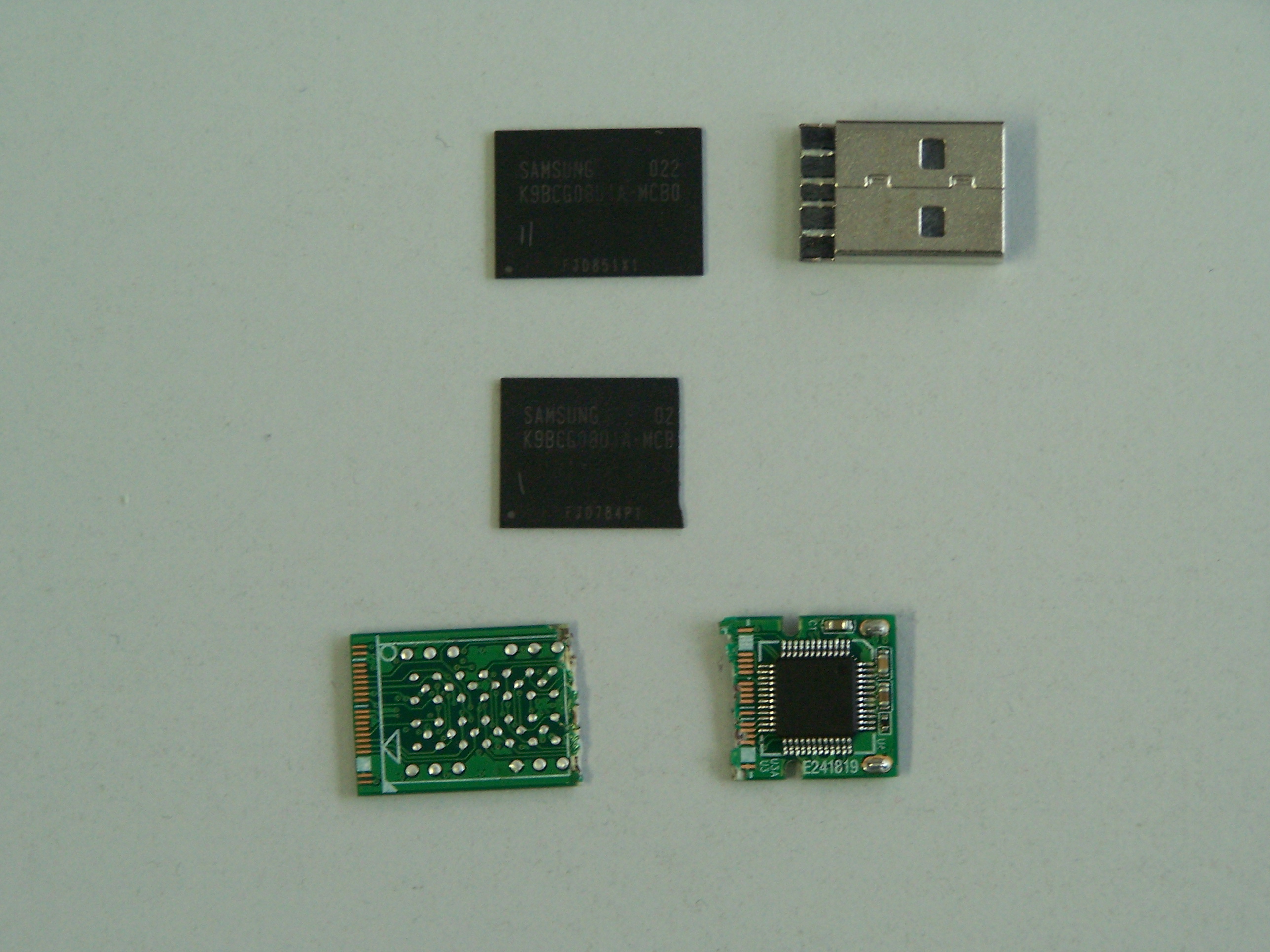

Hi everyone, i'm dealing with a recovery case but the nand chips on the flash are not supported or gives alot of bits errors by F.E or PC-3000 SSD version, the NANDS are:
SAMSUNG K9BCG08U1A x2 and the microcontroller is a Silicon Motion SM3255Q-AB the NANDS are TLGA-52 if someone has this board working please PM ME.
i bought a couple of new ones but they have different nands and microcontrollers.
Regards.
Rafael.

I'd take a photo of the damaged pcb and if you see one of the nands is also damaged, but i was able to read it, and gave me around the same bit errors that the another, i might still be lucky if i found the correct pcb.

second chip is broken. please show me high quality images of broken one both side. please double check it to see it possible to recovery or not. had to think about it. BTW. i every week have some SM3255Q come here. you can try with TSOP48. sorry about last BGA one. customer had to take it back.

I was able to read all the banks from the broken nand, none of the pins has been broken and as i said before i got around the same bit errors like the other, i need a board to test, let me know if you find the proper board.
