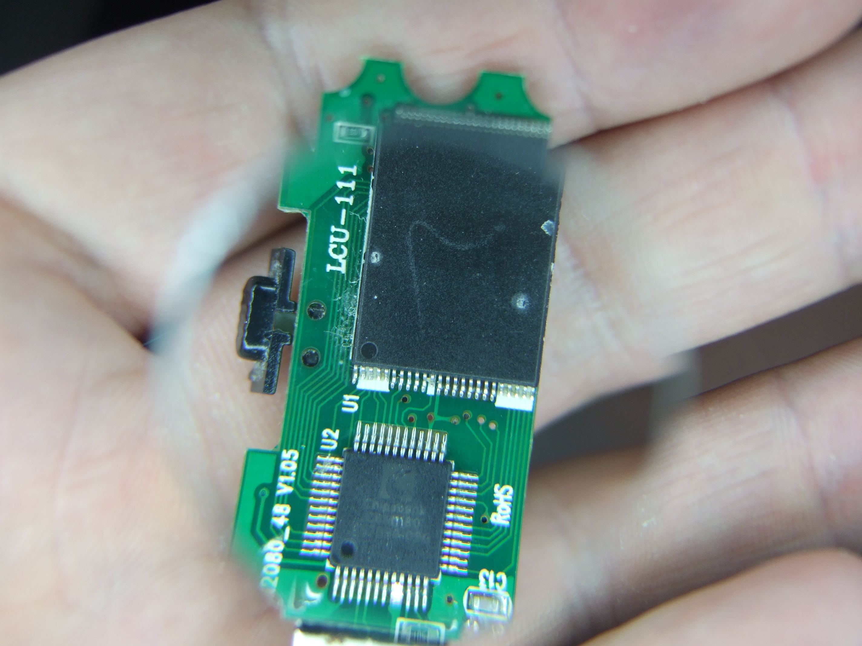

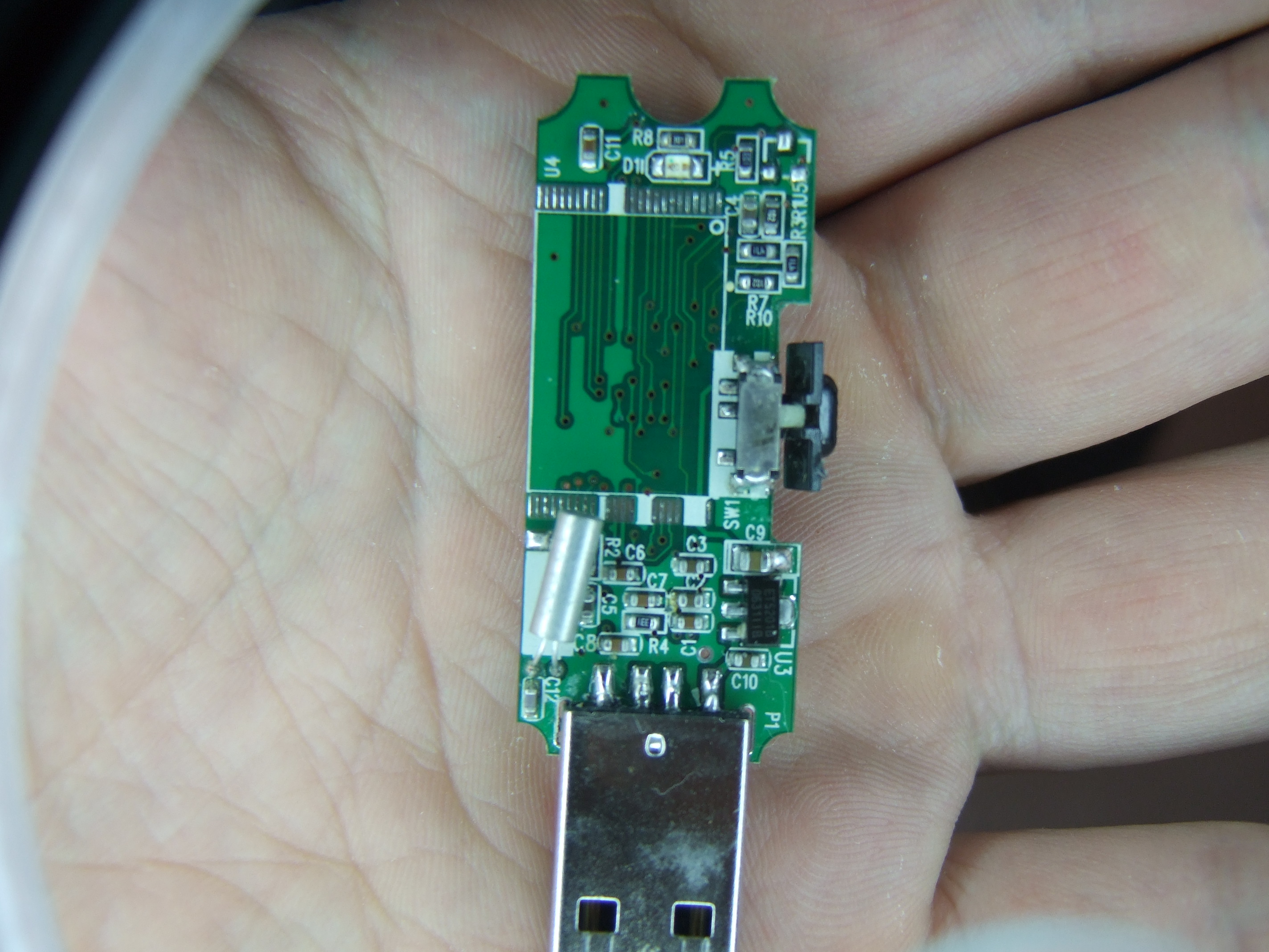

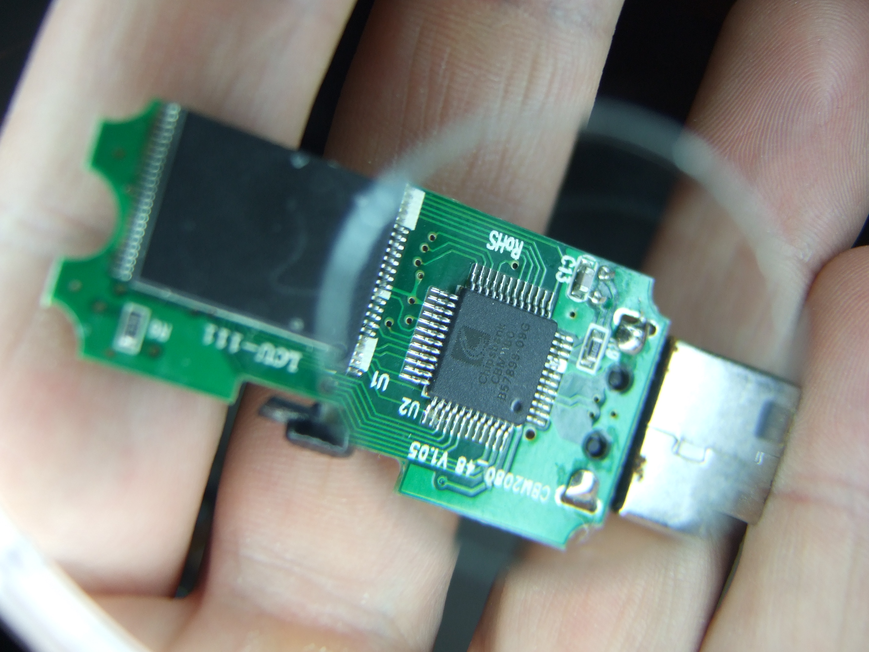

I have a client who gave me his old 256mb generic thumb drive with corrupted docx files on it that he needs. The drive is 256mb and only showing up as 30mb. I can find the files but they are corrupted and will not open. The chipsets look good, but maybe I'm missing something as I don't have much experience with recovery other than logical and some soldering on these things. Any suggestions? I'm thinking its a corrupted file issue and he's out of luck. Here are some pics of the drive.

It could be a problem of the controller..
You could try to unsold the NAND memory chip, read it and rebuild it's content.
If you don't know ho to do you could send it to a datarecovery company

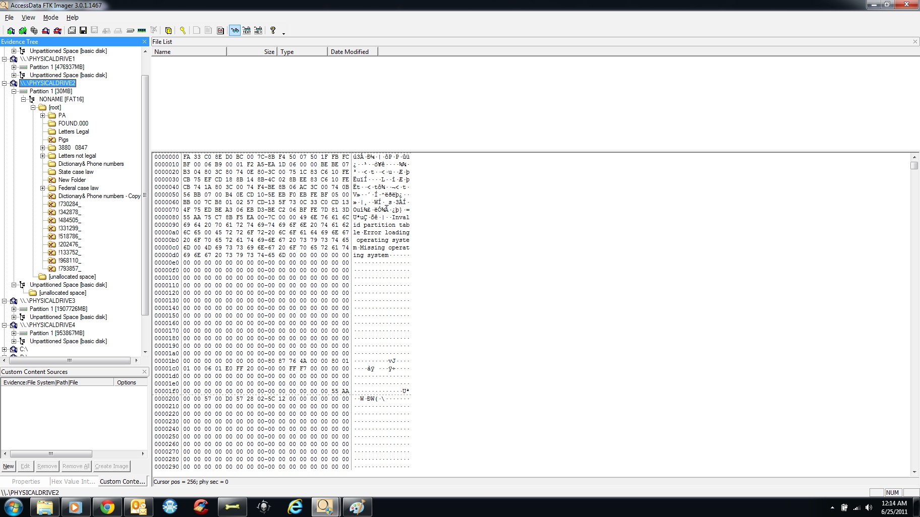

http://www.lynx-india.com/index.php?productID=11664
What do you guys think of something like that? Or is it always better to find an identical flash drive and swap the nand chips? Like I said before I don't have much experience with flash drives, but would like to get my skills up. I use the DDI for hard drives, but flash drives are not supported with the DDI. What tool is the best for recovering flash drives?
Thanks for your help.
File comment: Screenshot of the drive reading 30mb in FTK imager. The files are there, but most are corrupted.

Despite your criticism of my help, I'll give you one final comment - this answer is to your very general question of "Any suggestions?": Try different file carving software, from a disk image that you create. But since you haven't said which recovery software you've already tried, I don't know which alternatives to suggest! OK, I'm done here - good luck :)
 Post subject: Re: Need help old 256mb usb flash drive showing up 30mb corrupt
PostPosted: June 25th, 2011, 20:48
Posts: 17256
@MrAndersons,
The partition table contains one partition whose data are as follows:
80 01 01 00 06 01 E0 FF 20 00 00 00 FF F7 00 00
0x80 = partition is bootable
01 01 00 = partition begins at head 1, sector 1, cylinder 0
0x06 = partition type is FAT16 ("BIGDOS")
01 E0 FF = partition ends at head 1, sector 32, cylinder 1023
20 00 00 00 = partition begins at LBA 0x20 (= LBA 32)
FF F7 00 00 = partition size is 0x0000F7FF sectors, ie 32,505,344 bytes
Clearly the reported capacity is reflected in the partition table, which tends to confirm that the corruption is purely logical.
That said, ISTM that there is a discrepancy between the reported partition size (0x0000F7FF) and that which is suggested by the starting and ending CHS values. If we assume that the [logical] number of heads is 2, then the calculated partition size would be ...
(1024 x 32 x 2) - (32) = 0xFFE0
If I were you, I would investigate the above error in the partition table before doing anything else. To this end, I would use your disc editor to search for the boot sector of the first partition. The first place to look would be LBA 32. I'd also examine LBA 63. If you could upload a hex dump of the boot sector, then we could compare its volume information against the information in the partition table.
My instinct tells me that the CHS geometry for your drive is being detected as 2 heads, 32 sectors per track, and 1024 cylinders. If so, then ISTM that 16 heads would be more appropriate for a 256MB capacity. I wonder if your client used Microsoft's FIXMBR on this drive.

Great now we're getting somewhere. It was not my intention to criticize you, the recovery is probably more important to me then to him so I can learn from it. The software I use are getdataback , rstudio, and ftk imager.
The client stated the drive read 256mb in windows and now only reads 30mb. So i'm assuming that the partition used to read the full size of the drive.

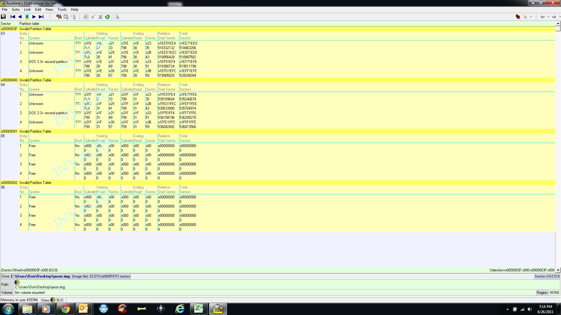

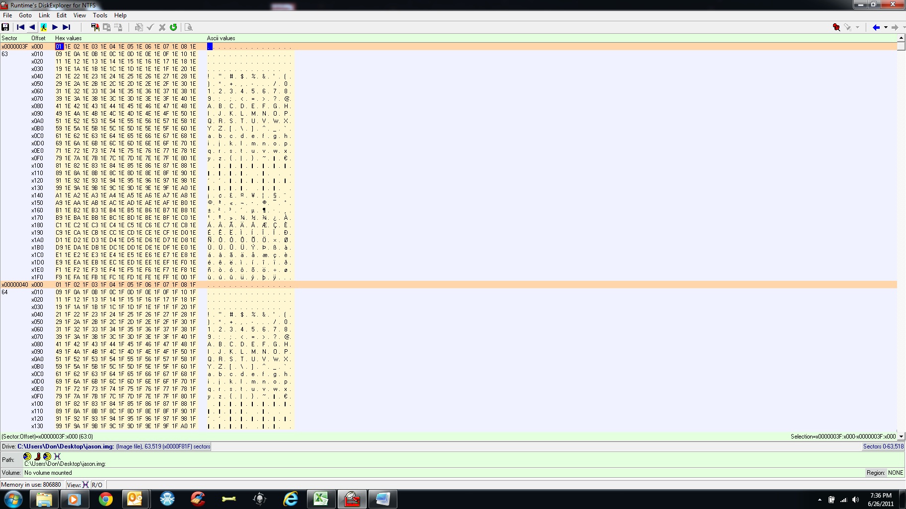

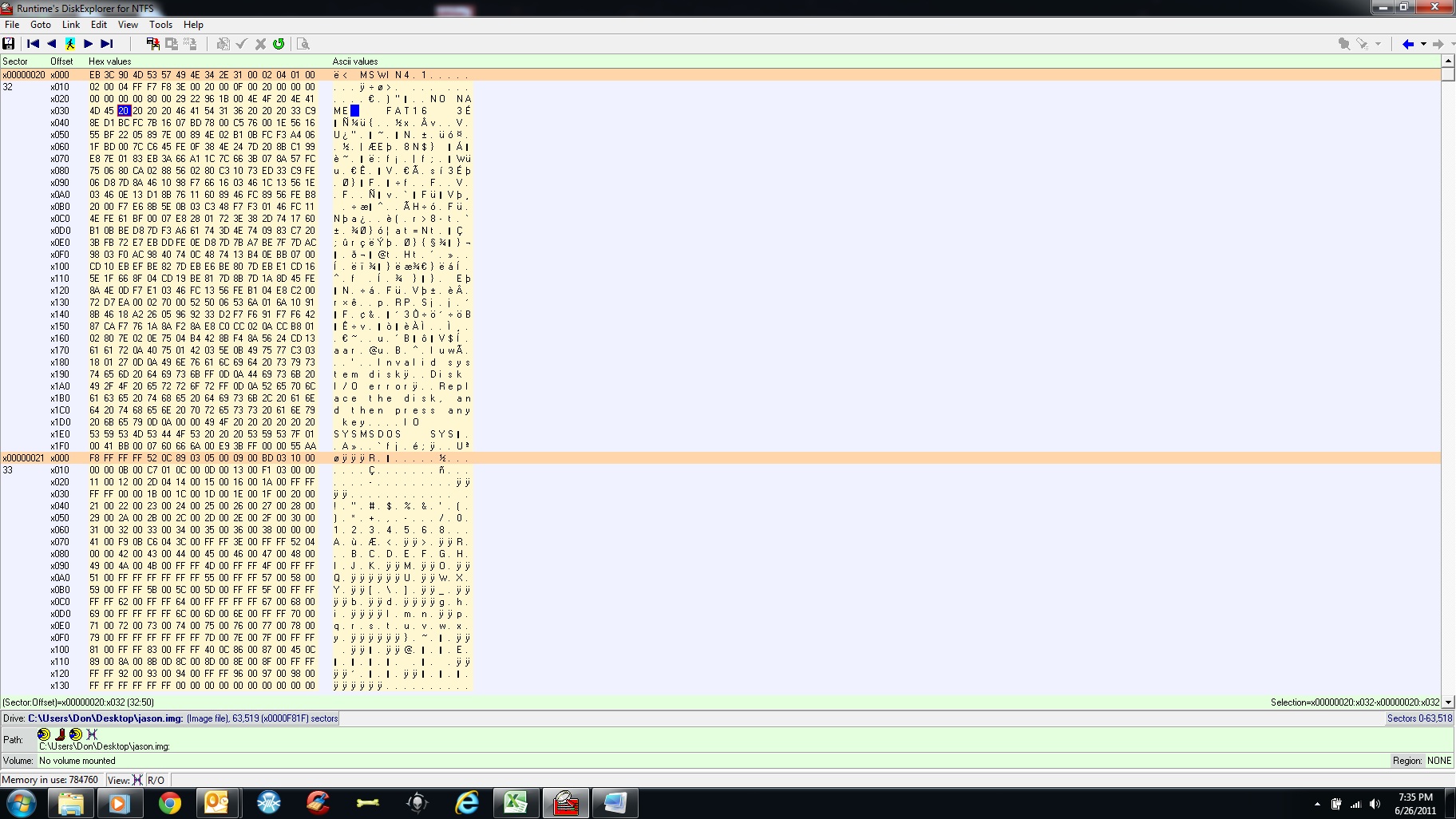

To this end, could we see the contents of sectors 32 and 63?
PostPosted: June 26th, 2011, 19:06
Joined: May 26th, 2011, 13:22
Posts: 76
Location: Philadelphia, PA

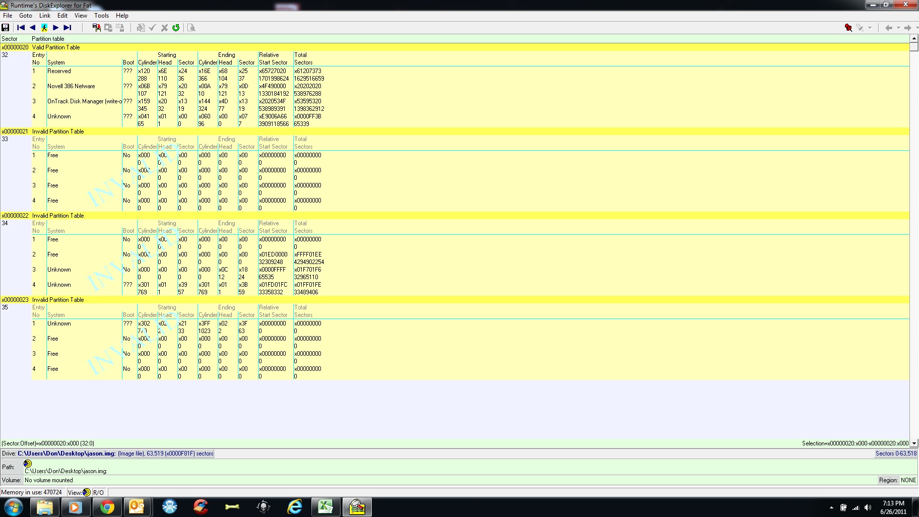

Sure, here is sector 32 and 63 in disk explorer.
Mr. Anderson
TriStateData.com
PostPosted: June 26th, 2011, 19:07
Posts: 76
disk explorer
Mr. Anderson
TriStateData.com
PostPosted: June 26th, 2011, 19:34
Posts: 17256
Sectors 32 and 63 are not MBRs. Therefore it makes absolutely no sense to interpret them as such. Hence the nonsense.
Once again, please upload the hexadecimal contents of each sector, ie something similar to your previous upload:
download/file.php?id=3780&mode=view
We do not want to see any interpretations of the data. We want the RAW data.
PostPosted: June 26th, 2011, 19:41
Posts: 76
sorry
Mr. Anderson
TriStateData.com
