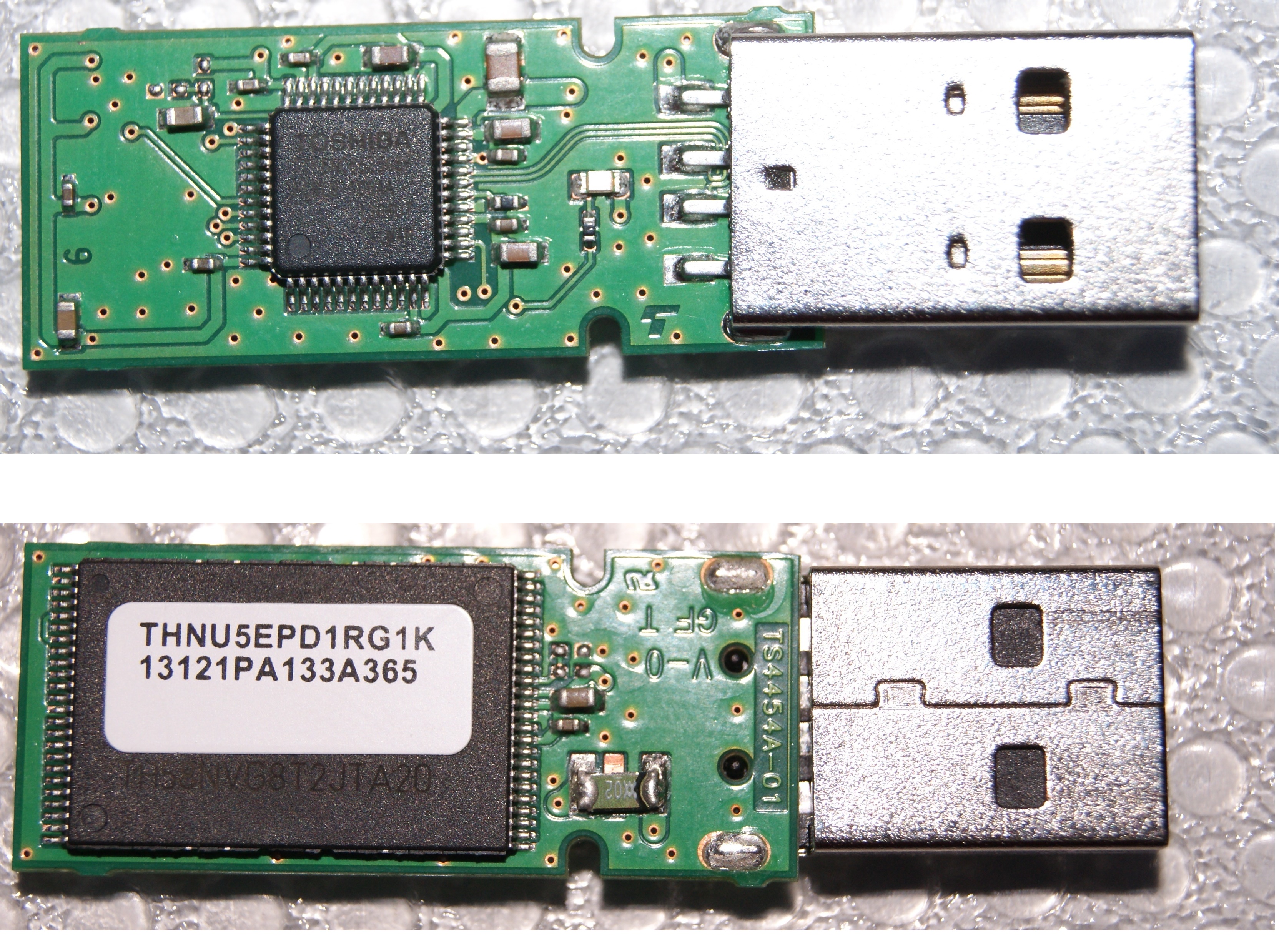

for example how we can test if any electronics component is in bad condition.
i attach pics from a case to test.
Thanks in advanced.

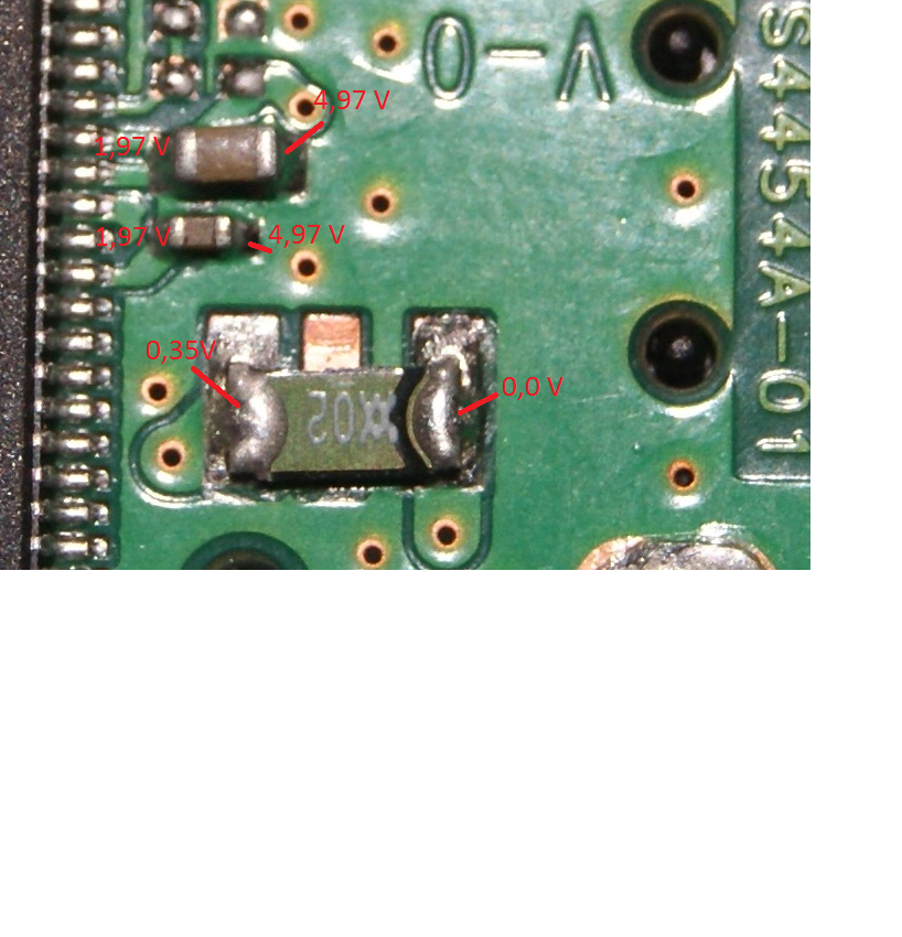

hhddrec wrote:
What points to test
For this one it's worth checking green resistor with "02" on it from the bottom view.
P.S.
What's the vendor / model of this flash drive? Toshiba controller with Toshiba memory chips is quite an infrequent combination.

The "green resistor" appears to be a polyswitch. That's a resettable fuse. It appears to be rated for 200mA.
http://pdf.datasheetarchive.com/indexer ... 070002.pdf
I would also measure the voltage across the 3.3V filter capacitor for the NAND flash. That would be generated by the controller.

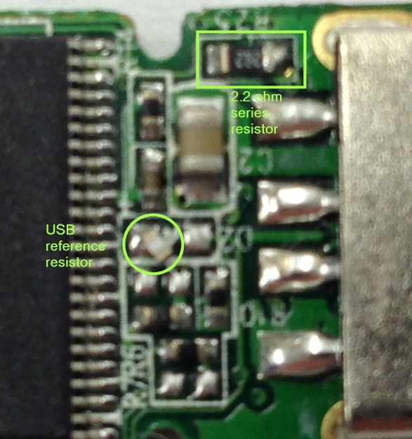

I can't imagine it ever happening, but what would be the symptom of an open USB reference resistor (I'm not sure if I have identified it correctly)?

Symptom of faulty resistor has been windows saying USB device not recognised, LED blowing controller getting hot to Flash Drive not working at all. There were some tutorials(as in "how to REALLY kill your USB") where they say to bridge a resistor with tweezers. I assume this is when a resistor or fuse blows and would work in a small percentage of cases.
Personally I don't think it is useful timewise to look for circuit problems, unless you already are good with electronic troubleshooting, such as someone like Franc that has an understanding of different circuits, their function and what role each part plays.. With most part sizes being at least 0805 and 0603 and many newer ones being even 0402, de-soldering them to check isn't really viable. I don't think checking in circuit is viable either on these as you would have to know what values you roughly should be seeing
 Post subject: Re: how can we testing electronics on Flash pen drives?
PostPosted: May 24th, 2014, 6:07
Posts: 17339
I think you are referring to the low-ohm resistor that is in series with the +5V supply. The component I'm referring to is the 1% reference resistor. Depending on the design, it's value can vary between a few hundred ohms and a few kilohms. It does not carry the supply current.

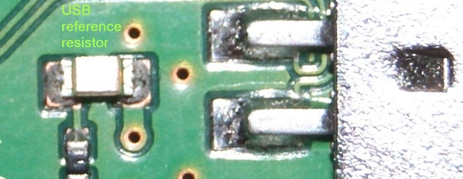

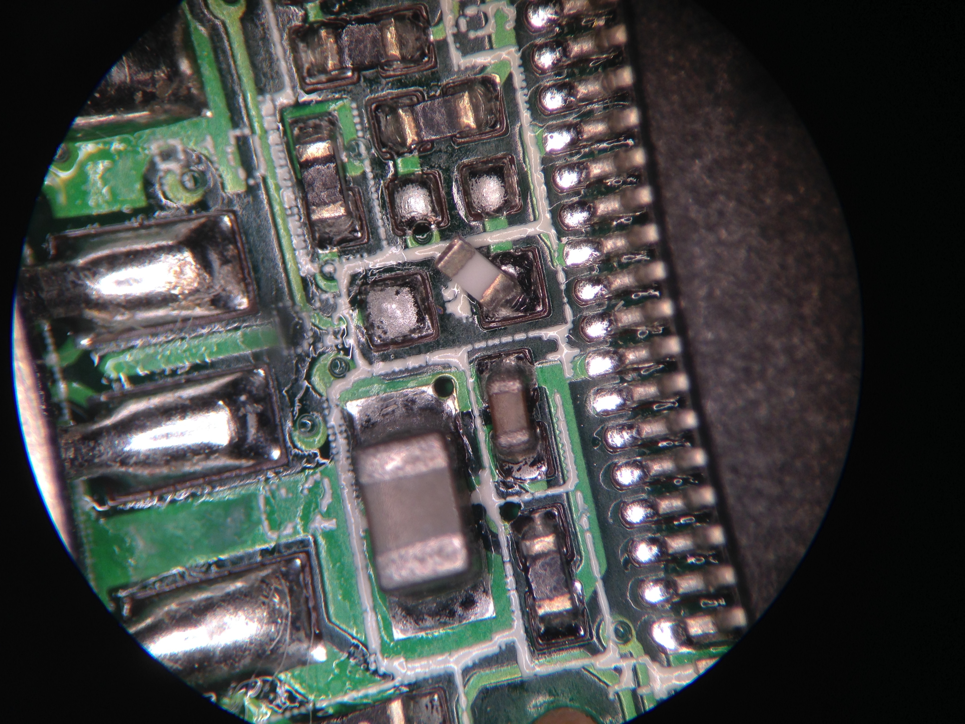

I hope I'm not hijacking this thread (the question appears to be a general one), but here is a reference resistor on a SM3257EN based flash drive that appears not to have been correctly soldered.
Here are both resistors:
I confess that I don't understand it's exact function, but it is specified as a 1% resistor and it is required by the USB section of the controller.

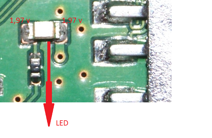

Hi fzabkar!
thanks for your help
about filter cap, i show you in pic
Important about: Reference resistor; This is not a resistor this is a LED.

I atach pics wit measusres
