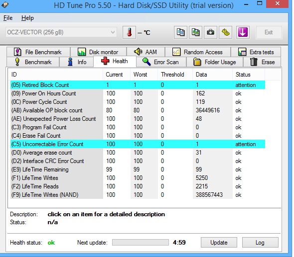

I bought this SSD around a year ago but never got around to using it. I did a clean install of Windows 8.1 and ran HDTunePro and found a few errors which I'm not so sure of:
Also, the benchmark for HDTunePro returned around 180mbps over SATA6, I'm sure this is cause for worry alone?
Any suggestions?

Check it again after about a week of use and see if the bad block count increases. Back up regularly.

I don't understand how a single Retired Block can cause the health of that attribute to drop from 100 to 1, unless the meaning of attribute 05 has changed for this model.

Doesnt look like the util has been updated in 14 months. I am hesitant to trust it on SSD seeing as they are touting improved SSD support back then.. leading me to believe it wasnt all that great before whatever improvements. I guess it is simply reading SMART, but I dont know how different SSD SMART is to Conventional drives.
I would be looking for a current util with good SSD suport

AFAICT, smartmontools has the best SMART support.

For consistency purposes, always check smart values with more then one tool. So many available out there...
 Post subject: Re: What Do These Errors Mean? [SSD - OCZ Vector]
PostPosted: June 11th, 2014, 3:58
Posts: 17339
Every tool should report the same SMART values, although some tools misinterpret the raw values. It's the names of the attributes that vary widely, and that's because the drive doesn't actually report the names, only the attribute IDs.
My concern with many of these tools is that their authors don't understand how the raw values are encoded, and this then leads them to make erroneous assessments of the drive's health. Some authors go one step further and impose their interpretations on the user without displaying the actual raw data.

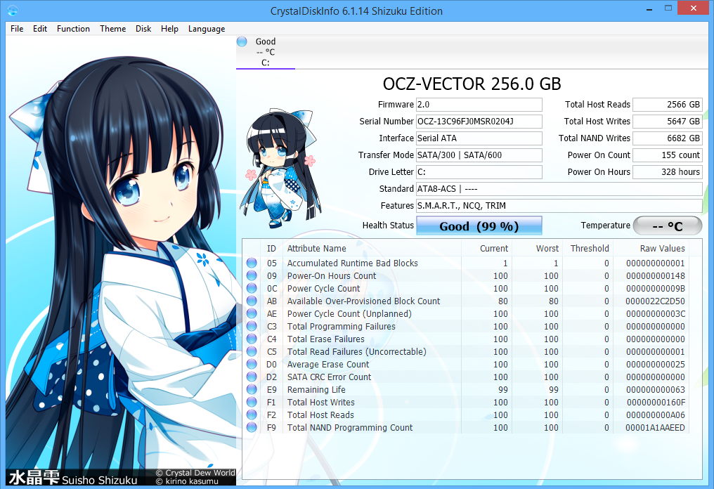

Its funny becuase it says 2.5TB of info has been read and 5.6TB has been written... That is ludacris lol becuase I have only just managed to use up 200GB of the drive. It is impossible to have written 5.6TB of data.
Crystal Screenshot:
PostPosted: June 14th, 2014, 22:54
Posts: 4022
It could be counting testing at the factory, also when you write data to flash devices, there is other operations such as error correcting code, page and block re-writes, optimisations like delayed write and wear levelling. So the data written is not exactly the same size as what is recorded as written.
It does seem a fairly large amount though

Short version:
AFAICT, between the two SMART reports, about 400GB of data have been written to the drive, and about 350GB of data have been read from the drive.
Long version:
AFAICT, the Current and Worst values of the Accumulated Runtime Bad Blocks attribute are raw counts rather than normalised health scores. Comparison with other SMART reports suggests that a drive begins life with zeros for both values.
Here are 3 examples:
http://www.oczforum.com/forum/showthrea ... (unplanned)
http://www.ocztechnologyforum.com/forum ... 13473.html
http://forum.notebookreview.com/solid-s ... -data.html
Also, a normalised value of 80 for the Available Over-Provisioned Block Count appears to be how the drive begins life, even though one would expect that a perfectly healthy drive might show 100 for this attribute. The raw numbers appear to reflect the number of OP sectors (or LBAs) rather than NAND blocks. Also, over-provisioning seems to be achieved simply by virtue of the difference between decimal gigabytes and binary gigabytes.
For example, the OP's 256GB Vector would have 16 x 16GiB NAND chips for a total capacity of 256GiB. The actual number of reported LBAs is not given in either screenshot. However, the 512.1 GB example below reports 1000215216 sectors.
The total number of sectors in a 512GiB array would be ...
512 x 1024 x 1024 x 1024 / 512 = 1073741824
The difference in the decimal and binary capacities is ...
1073741824 - 1000215216 = 73526608 sectors
... which roughly corresponds to the raw value of attribute 171 (73518416) in the example below.
OCZ-VECTOR 256.0 GB
AB Available Over-Provisioned Block Count 80 80 0 22C2D50 (= 36449616)
OCZ-VECTOR 512.1 GB 1000215216 sectors
AB _80 _80 __0 00000461CD50 (= 73518416) Available Over-Provisioned Block Count
OCZ-VERTEX450 128,035,676,160 bytes
171 Unknown_Attribute 080 080 000 - 17907024
OCZ-VECTOR 128GB
171 Available OP block count 0x0000 080 080 18365776
OCZ-VECTOR 128GB
171 Available OP block count 0x0000 080 080 18185552
As for the amount of data written and read, ISTM that attributes F1 and F2 count the amount of data transferred over the SATA interface, whereas attribute F9 records the number of actual NAND writes, including wear levelling, etc. Therefore F1 and F2 should accurately reflect the user's usage pattern.
In fact we could compare the CrystalDiskInfo and HD Tune reports and see whether the differences in the attribrute values correspond to the actual usage over the intervening 10 days.
The Power On Hours Count differs by 166 hours (= 328 - 162).
The Average Erase Count has increased from 31 to 37.
The increase in Host Writes = 0x160F - 5250 = 397GB
The increase in Host Reads = 0xA06 - 2215 = 351GB
The increase in NAND Programming Count = 0x1A1AAEED - 388567443 = 49 388 890
CrystalDiskInfo believes that the Total Host Writes/Reads are reported in GB, and it appears that it assumes that each NAND Programming cycle addresses 16KB.
According to CrystalDiskInfo, 0x1A1AAEED NAND writes equates to 6682 GB.
So ...
6682 gigabytes / 0x1A1AAEED = 16382.3 bytes
Therefore the additional NAND writes between the two SMART reports amount to ...
49388890 x 16KiB = 753.6 GiB
That's a write amplification of approximately 2:1.
AFAICS, the difference in the Average Erase Count would suggest that the entire NAND array has been erased 6 times, which amounts to 1.5TB (= 6 x 256GB). That's twice the increase in NAND writes. Does that make sense, or should the two results be roughly equal, in which case the write amplification would be 4:1, and each NAND programming cycle would address 32KB?
