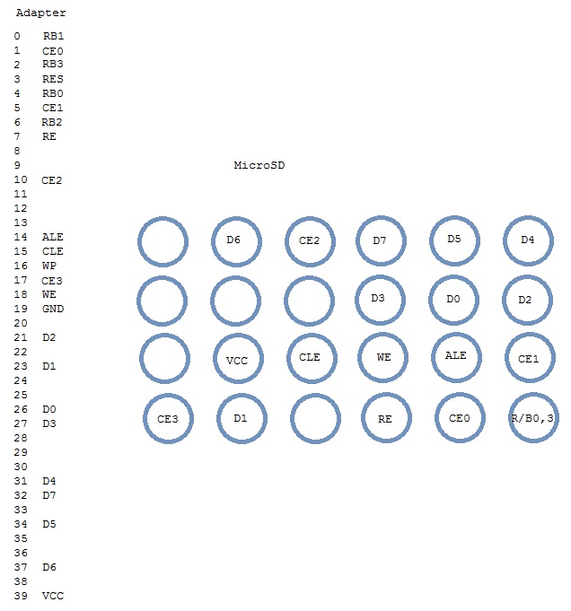

What are the pinouts for the adapter and the monolith?
 Post subject: Re: FE xx_dump.bb Files question
PostPosted: June 19th, 2014, 21:47
Posts: 3936
here tis

ISTM that there must be something wrong with your CE pins. I can't see any way for two banks to read exactly the same unless they share the same select pins.
Have you checked whether any of the CE pins are tied together? What happens if you connect CE0 on the adapter to each of the chip CE pins in turn, and leave the other CEs disconnected?

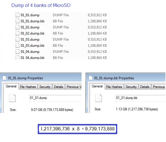

this is a view of the file sizes involved (32GB Device)

ISTM that a NAND dump would consist of sequential pages (raw data + spare area), cycling through each block in turn. This would seem to be borne out by the 1GB example in one of your other threads:
viewtopic.php?t=28896&p=199344#p199344
download/file.php?id=8367&mode=view
However, the size of the main dump file in this thread seems a little strange, ie ...
9739173888 bytes = 0x244800000
If the capacity of each bank is 0x200000000 bytes, ie 8GiB, then that leaves 0x044800000 bytes for the spare area.
AISI, this allows for the following possible relationships between page size and spare area:
    1KB / 137B
    2KB / 274B
    4KB / 548B
    8KB / 1096B
    16KB / 2192B
However, the ONFI spec and the following URL both suggest that such a spare area would be unusually large:
http://www.linux-mtd.infradead.org/nand ... ddata.html
http://www.onfi.org/-/media/onfi/specs/ ... 20gold.pdf
http://www.onfi.org/specifications
For example, an 8KB page size is typically associated with a spare area of 436, 448, 576, or 640 bytes.
Have I misunderstood the structure of the dump files, or is there something different about your NANDs? Do you have any page size, block size, spare area, ONFI/JEDEC parameter/ID information?

The actual capacity of the Bank, chip, drive etc. is only an approximation. Even a new drive is not guaranteed to be exactly the GB it says on the tin, to the byte level.
As you mentioned, this chip has a size of 0x24480000 (9,739,173,888 - the file size).
made up of 0x1000 blocks each with a size of 0x244800 Bytes. Each block has pages of size 9216(0x2400).
The trick is finding out how the controller uses these blocks, XOR, ECC, Mix
The ONFI spec comes into it reading the chip, but that's about as far as it goes. The chips has been read successfully aside from weather or not the 2 bb files are ok or not.
Not cutting the bad blocks from the image has detrimental effect on getting a god image to recover files.
BTW, It has been a long day and I have 4 difficult cases for different reasons. I have probably botched a number of the terminologies, descriptions and such, as I rarely have to verbalise this stuff. I am not good at explaining something that is done on a follow your nose basis.
