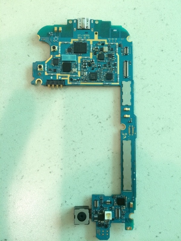

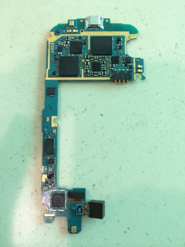

Is bad cel.
The cell that burned. No power. I need to recover data (photos, all files)
model: GT-I9300
Which and the memory chip?

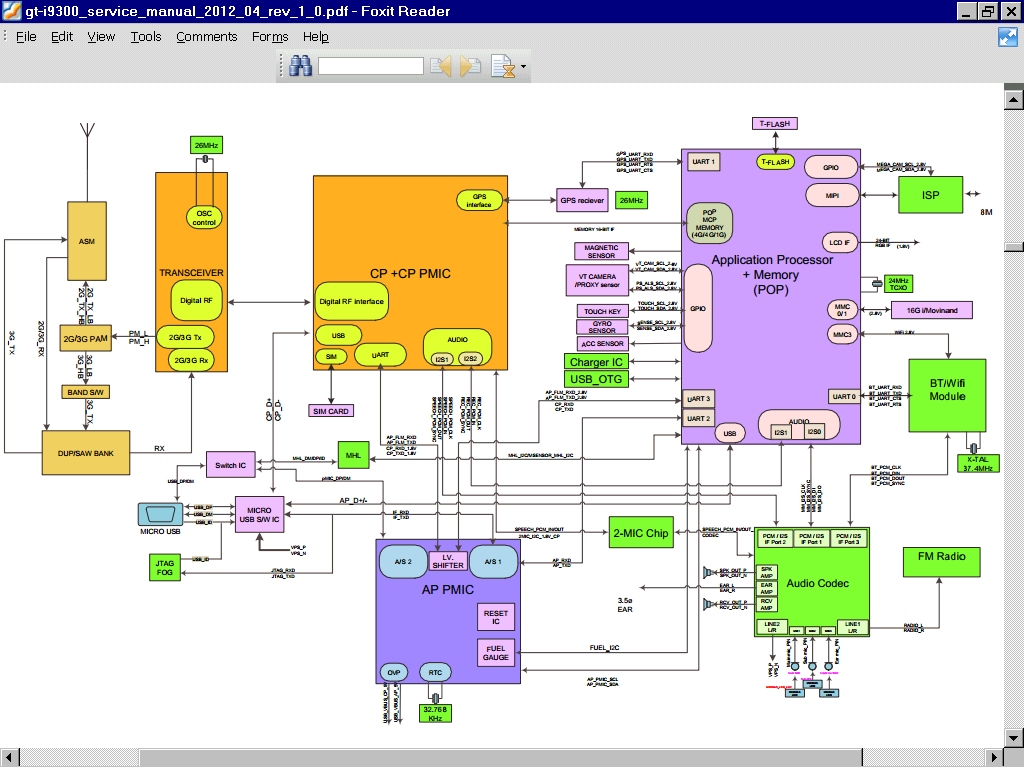

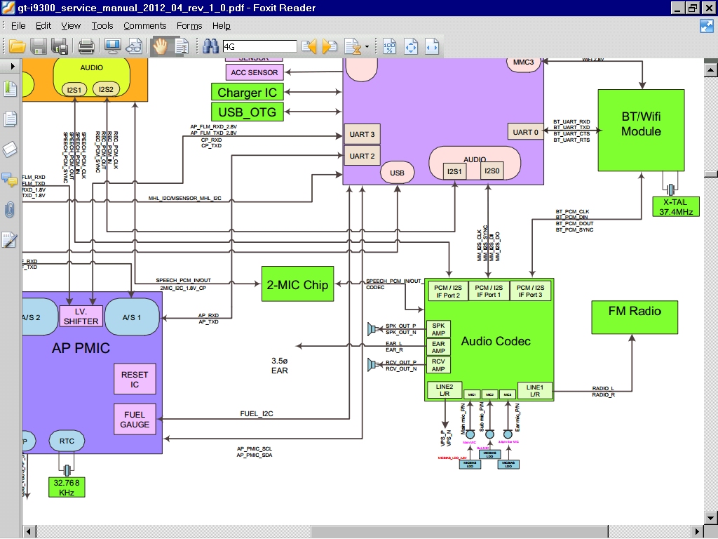

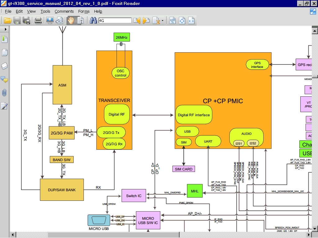

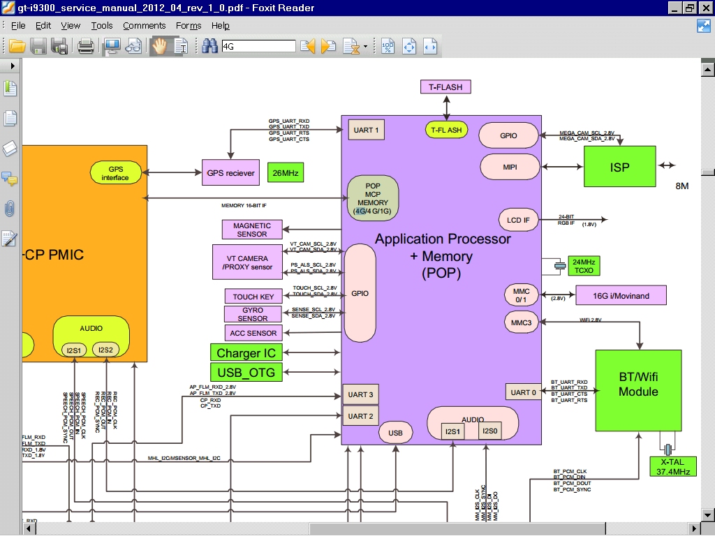

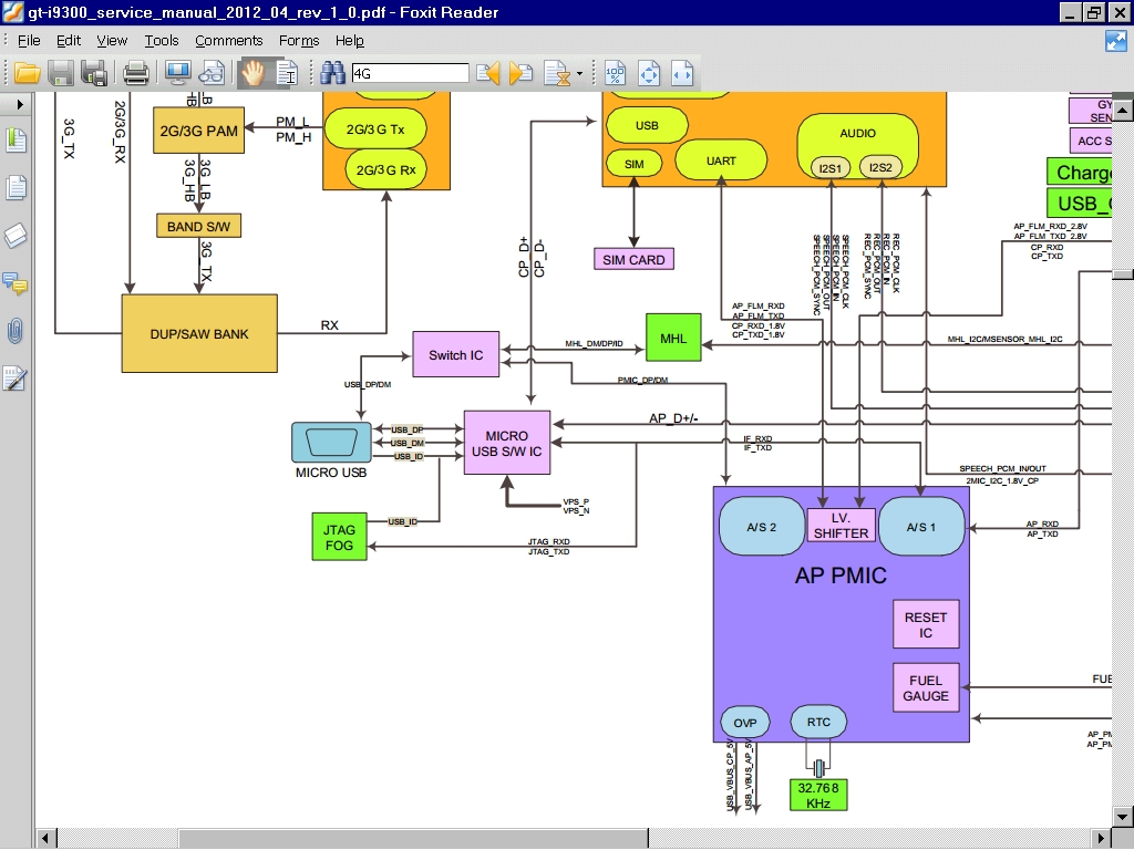

Check the service manual. :wink:
... or this URL:
http://www.electronicproducts.com/Samsu ... t-132.aspx
:wink:
... or check the attached block diagram snapshots (from the service manual).
:wink:

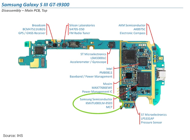

Can you write full name of memory chip? Is it an eMMC?
 Post subject: Re: SAMSUNG S3
PostPosted: July 11th, 2014, 18:30
Posts: 17256
The answer is in einstein9's PCB photos, and in the link to the parts list, and in the service manual.
KMVTU000LM-B503
MCP - 16GB eMMC NAND + 64MB Mobile DDR
Samsung Semiconductor
Main PCB, Top
http://www.samsung.com/global/business/ ... &iaId=2384
http://www.google.com/search?q=%22GT-I9 ... letype:pdf
Samsung_Galaxy_S_III_GT-i9300_Mobile_Handset_-_Main_PCB_Top_MCP.jpg [ 105.56 KiB | Viewed 13604 times ]

So I'm optimistic about recovery from eMMC nand.

Hint: JTAG.
