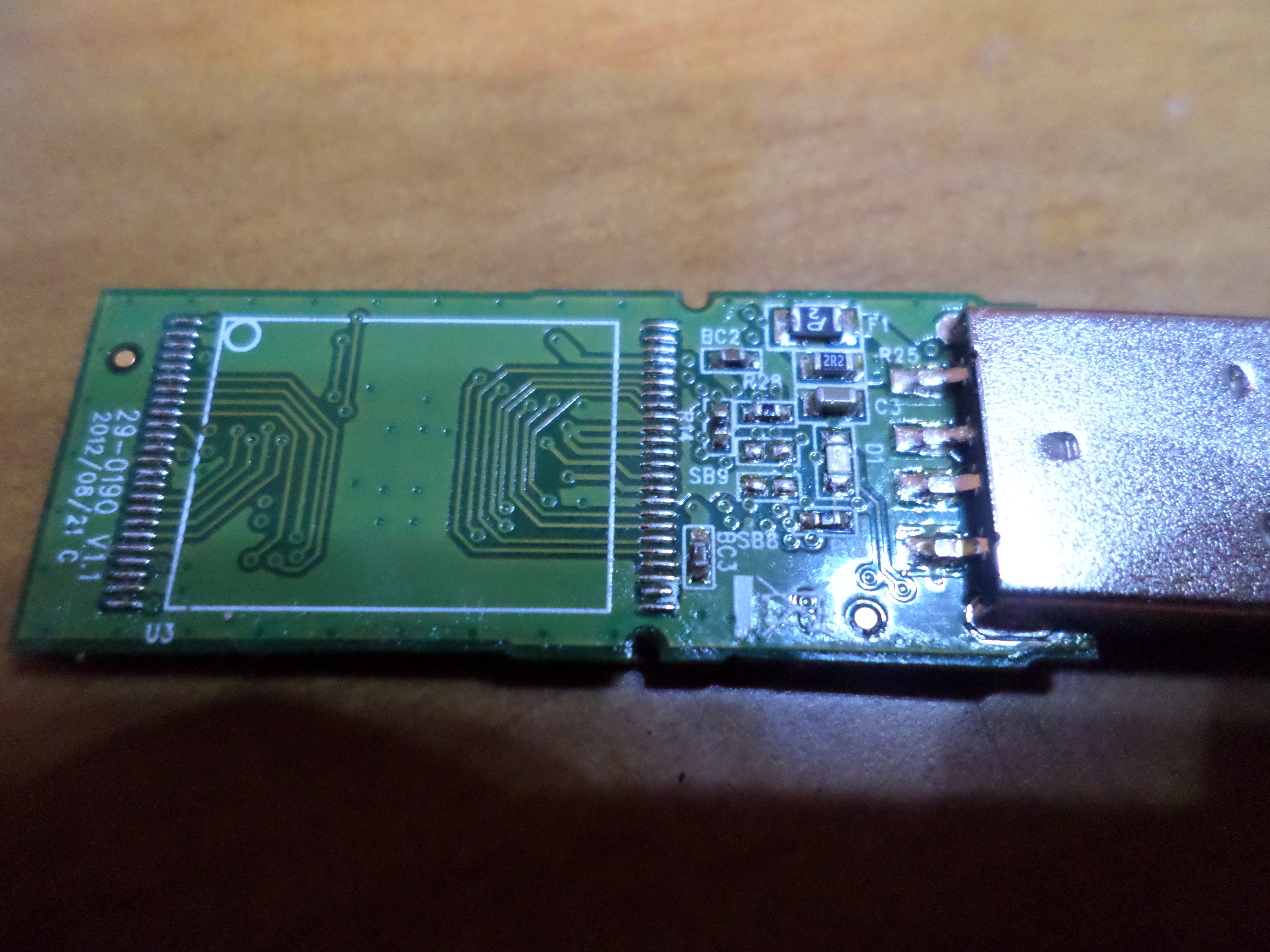

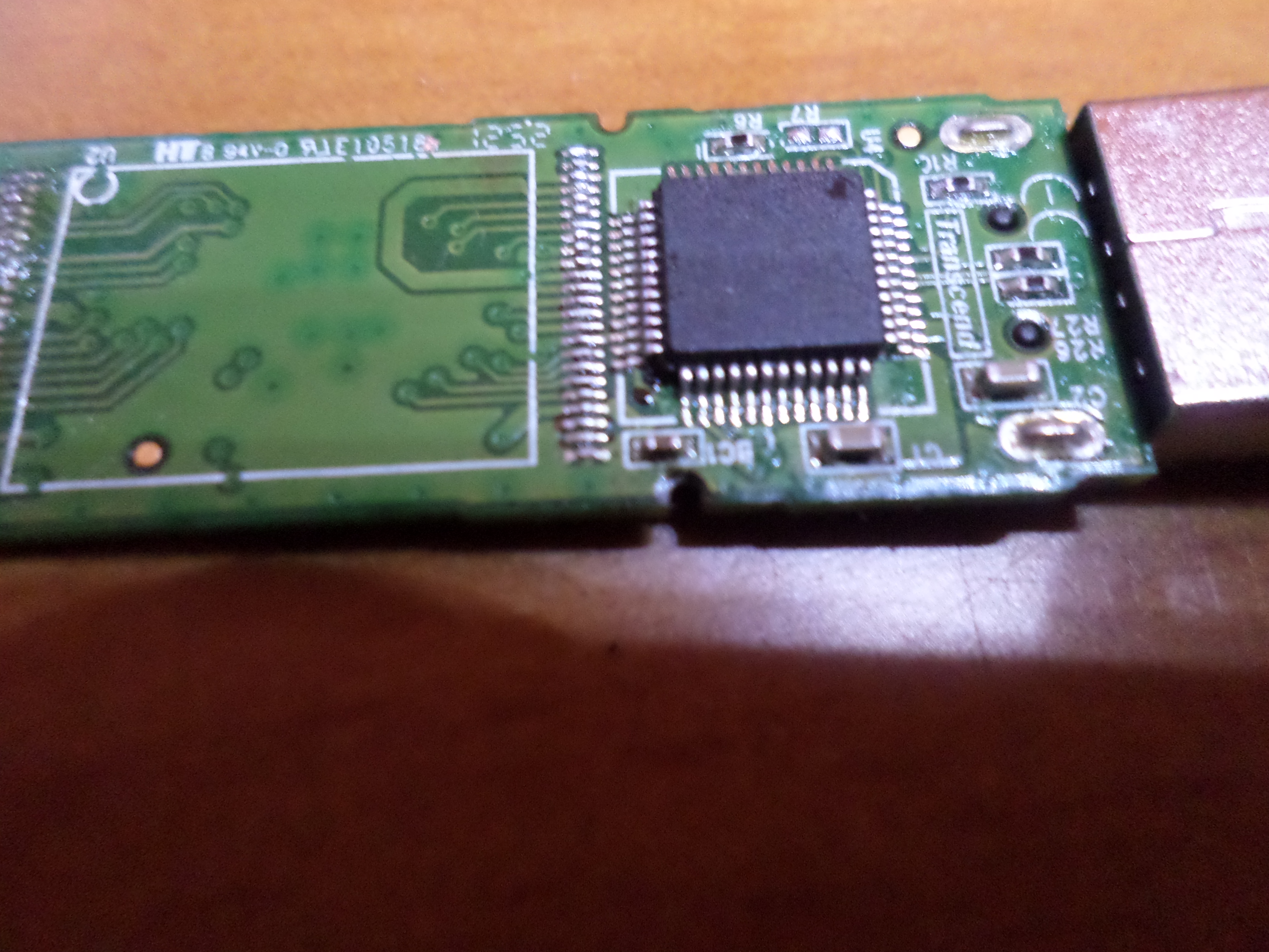

The information on te NAND is:
P12370092
SDTNNMBHSM-008G
WSB526001855
Here I have attached pictures of the top and bottom sides of the PCB.
Thanks for any info.
I ave not yet succeeded in taking a dump as I still do not have the necessary information to get the NAND identified.

Did you try and read the NAND, if so what is the Chip ID? 45 CE 95 32 ? should be a 16-bit chip 8640 page size with 1 8GB Bank. Cant see a problem with reading it

Does this help?
http://flash-extractor.com/forum/viewtopic.php?t=5677
Your NAND chips appear to differ from the following "standard" pinout:
http://forum.soft-center.ru/School/Adap ... 8/chip.gif
For example, there are several NC pins which connect to the controller, plus there are several additional supply pins.
