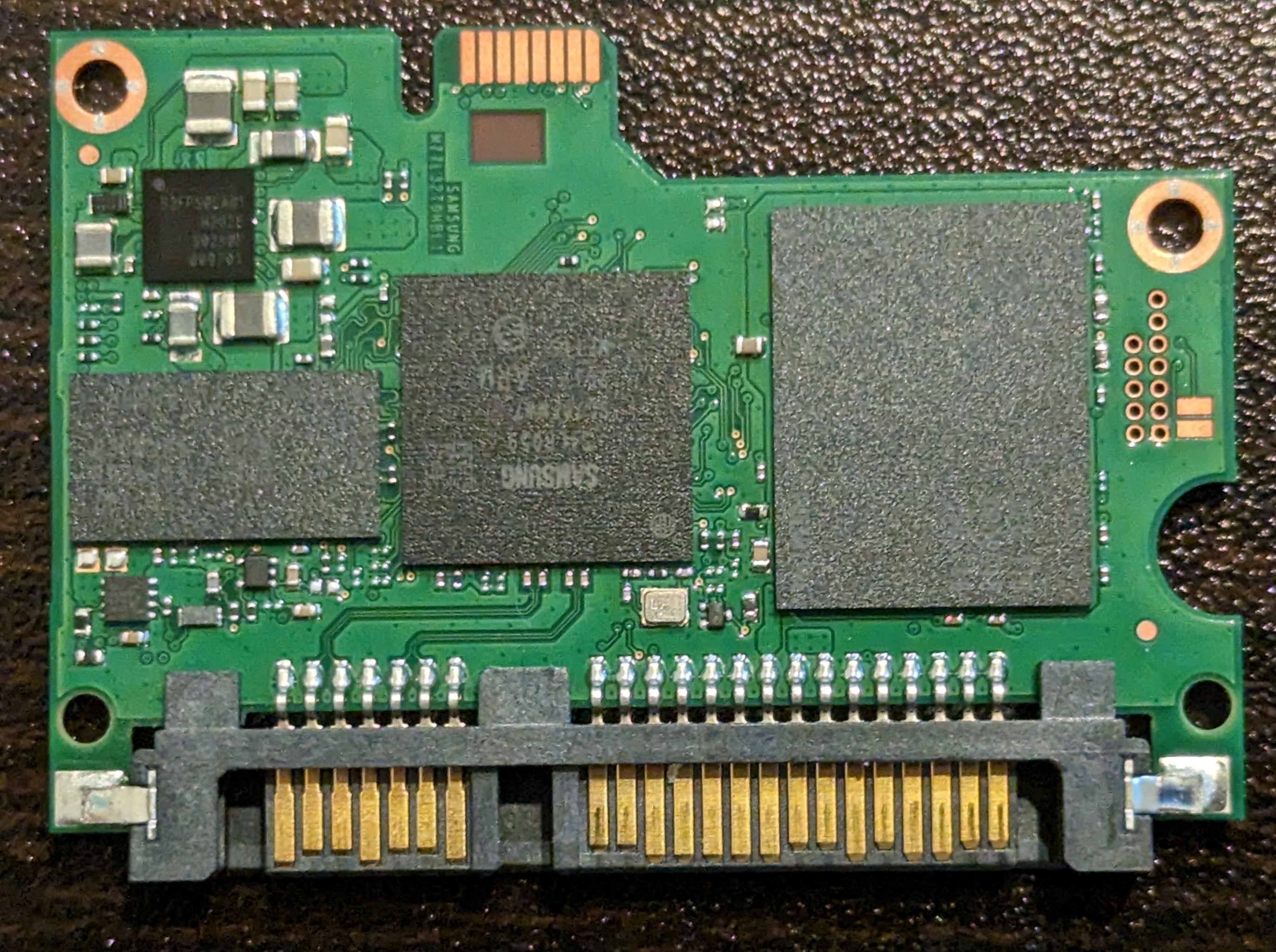

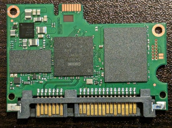

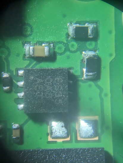

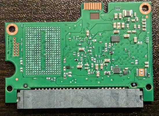

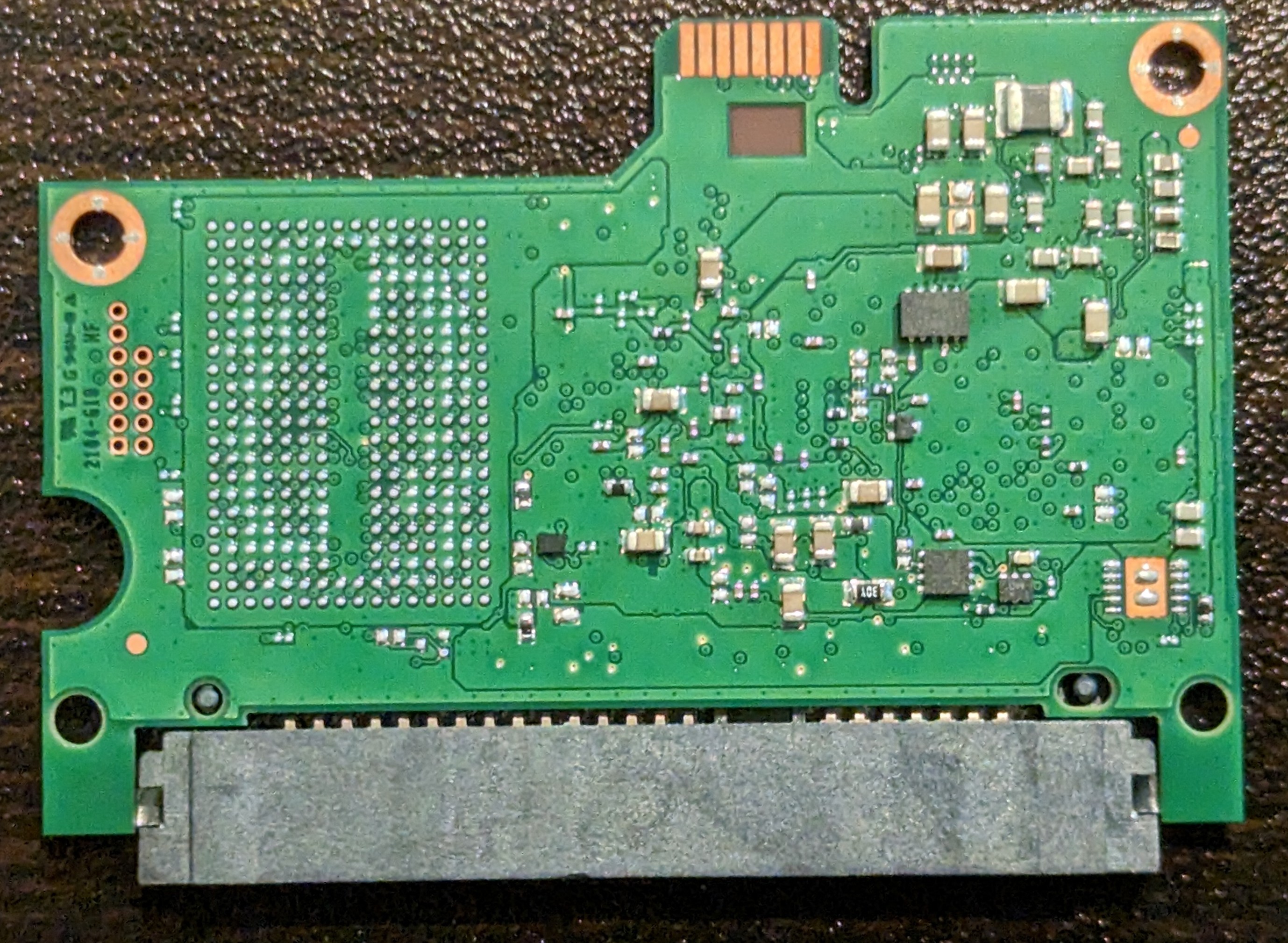

Got a Samsung EVO 870 500GB model. Drive died suddenly. Is not detected in BIOS. Would like to recover the data. Wondering if someone can help with some guidance on probe points and methods to identify the fault. Photos attached. Thanks.
 Post subject: Re: Samsung EVO 870 500GB
PostPosted: October 27th, 2022, 22:05
Posts: 17341
This is sounding like a problematic model:
https://goughlui.com/2022/08/20/notes-s ... e-trusted/
I can show you the voltage test points, if necessary.

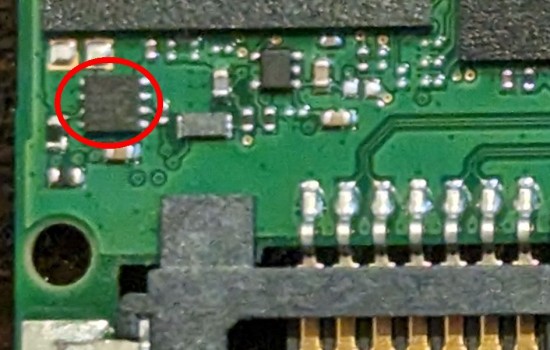

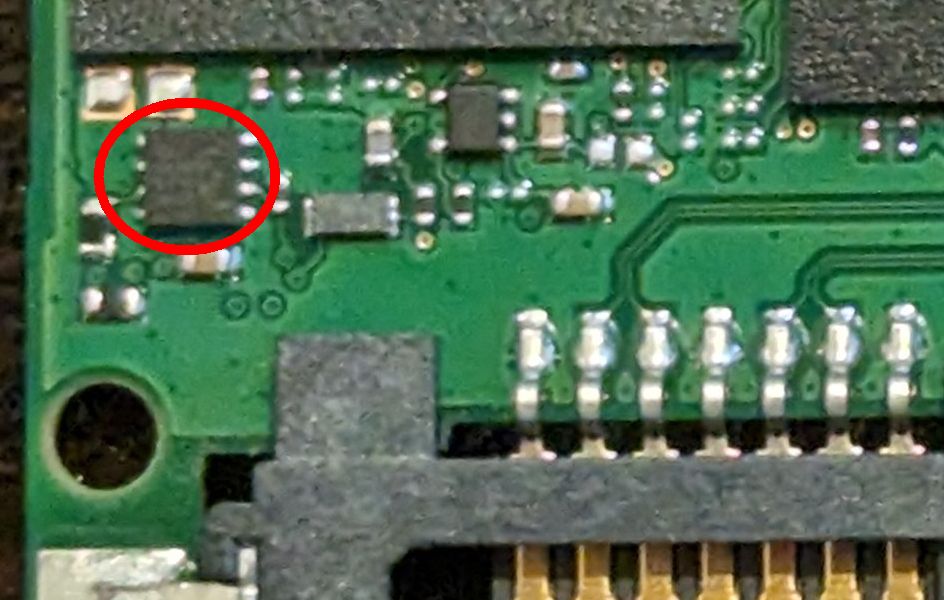

Yes, I did come across that posting. I'm hoping perhaps it's a blown efuse, as seems to have been the case with a number of other Samsung models. Although a lot of those seem to have been caused by incompatible modular PSU cables being used, which was not the case here. Some guidance on probe points would be greatly appreciated. I assume circled chip is efuse?
PostPosted: October 27th, 2022, 22:57
Posts: 17341
It does look like it's in the right position for a 5V e-fuse. I expect that the two unpopulated square pads would be 5Vin and 5Vout.

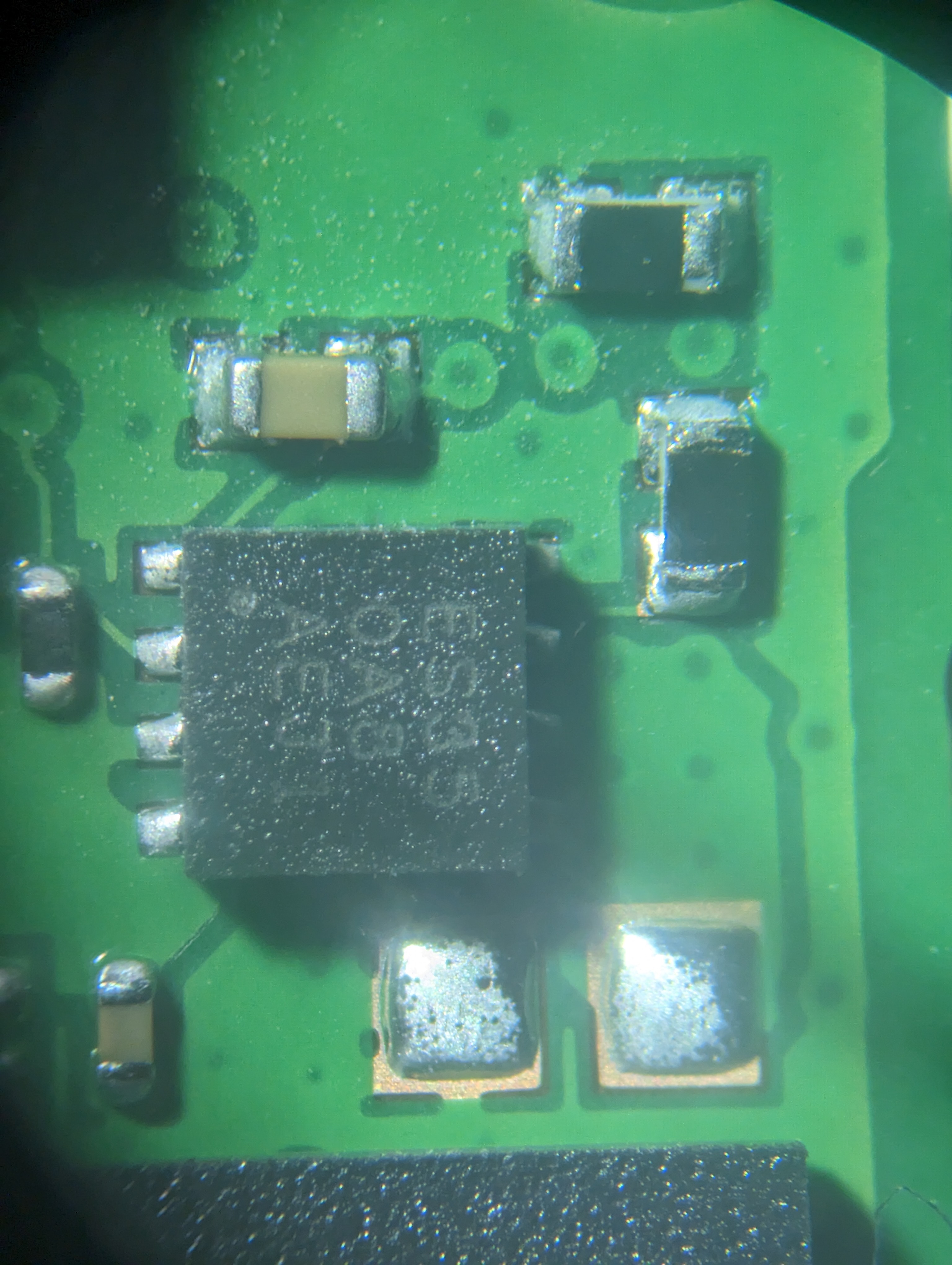

here's a closeup

TPS259535, Texas Instruments, 2.7V - 18 V, 4A, 34-mΩ eFuse With Fast Overvoltage Protection, 5.7V clamp, marking ES35, WSON-8:
https://www.ti.com/lit/gpn/tps2595
I was wrong about the pads. You need to check pins 3,4 and 5.

getting 5v on pins 3,4, and 5. :puke:

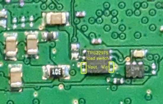

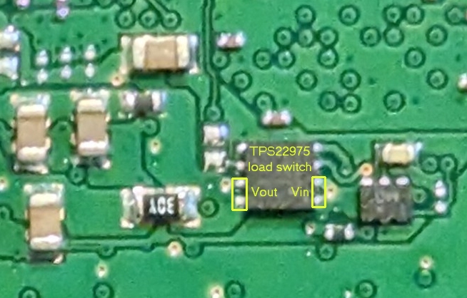

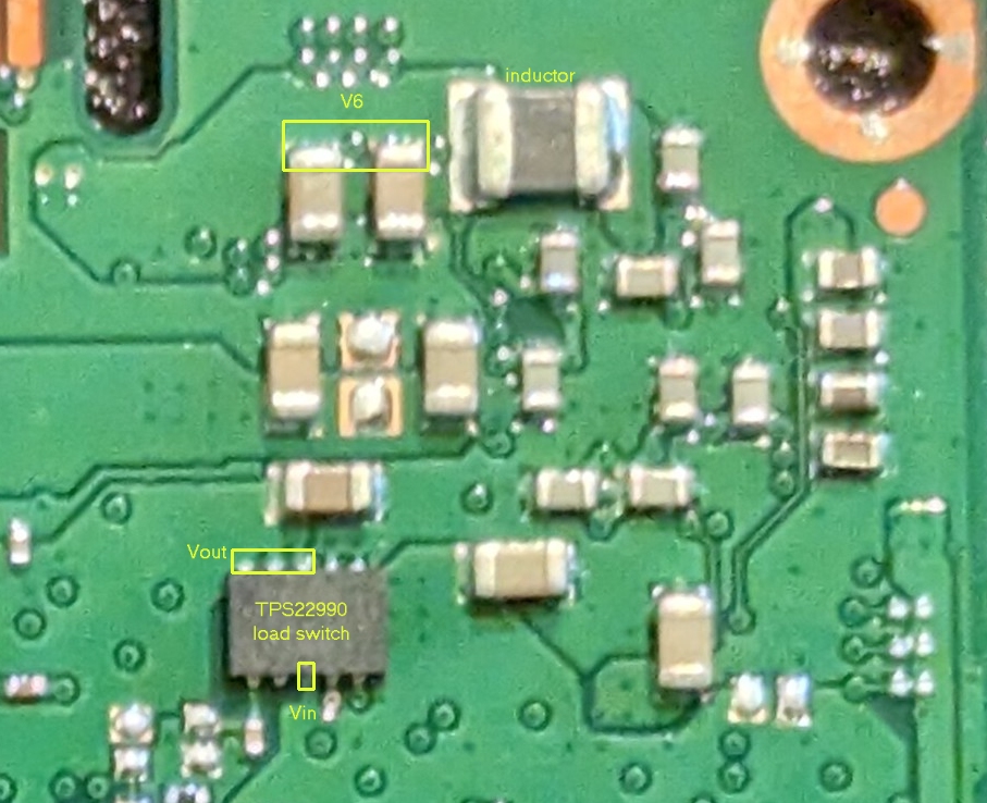

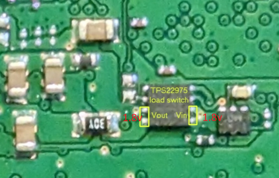

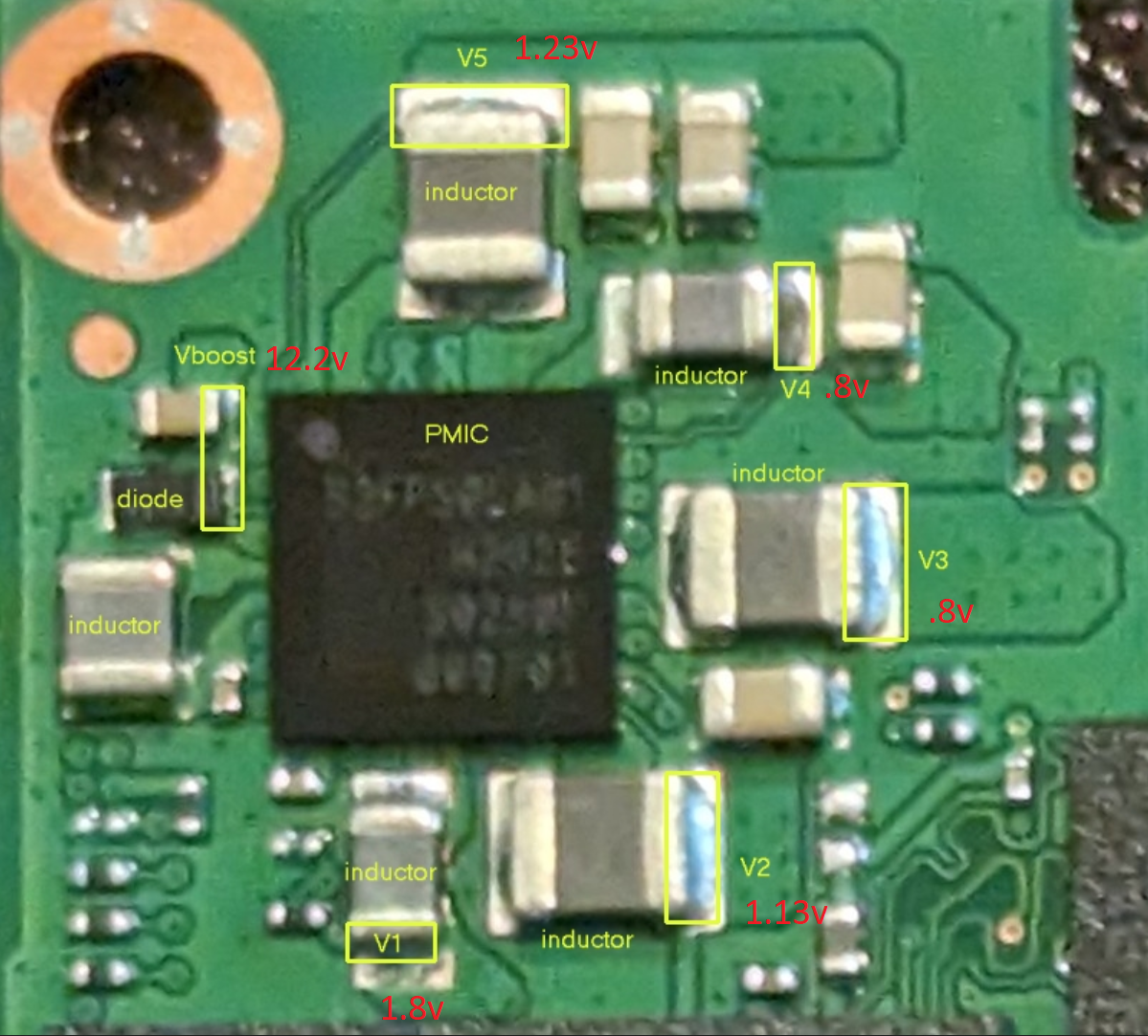

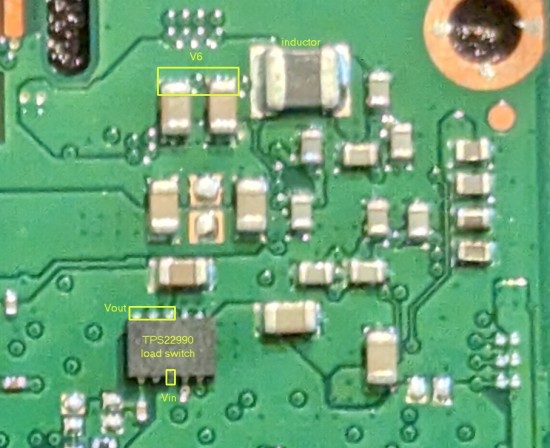

TPS22975DSGR, Texas Instruments, 0.6V - 5.7V, 6A, 16mOhm Load Switch, marking 13XH, WSON-8:
http://www.ti.com/lit/ds/symlink/tps22975.pdf
TPS22990DMLR, Texas Instruments, 0.6V - 5.5V, 10A, 3.9mOhm Load Switch, marking RB990, WSON-10:
http://www.ti.com/lit/ds/symlink/tps22990.pdf

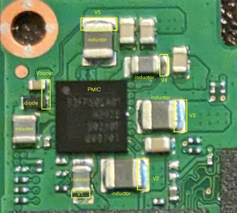

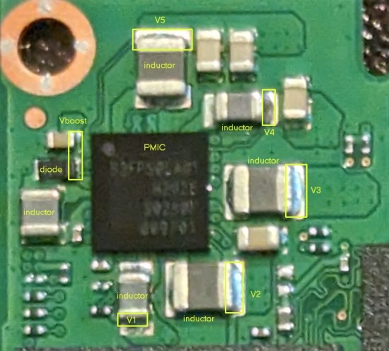

PostPosted: November 1st, 2022, 13:27
Joined: March 24th, 2010, 21:08
Posts: 111

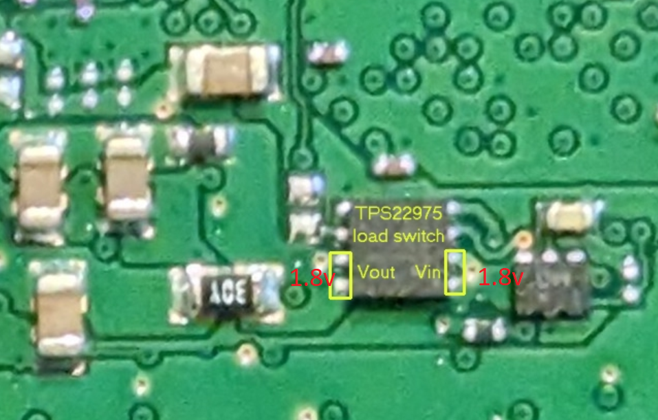

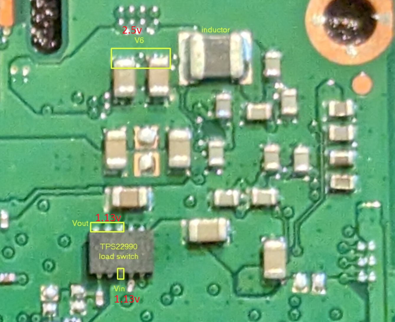

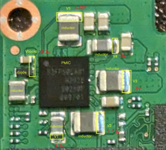

Location: California

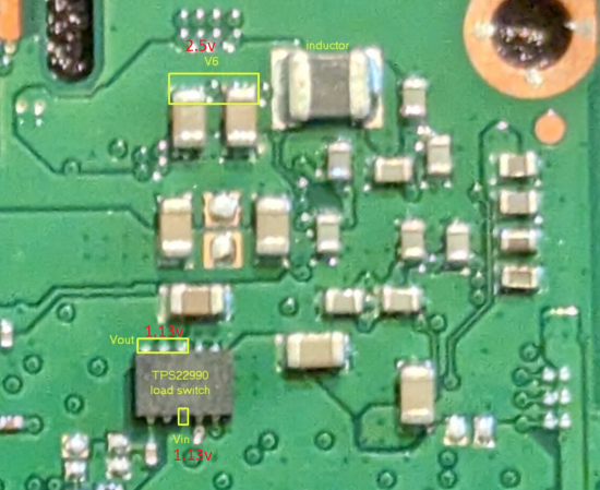

readings attached
PostPosted: November 1st, 2022, 14:15
Posts: 17341
V3 and V4 seem low. Could they be core voltages?

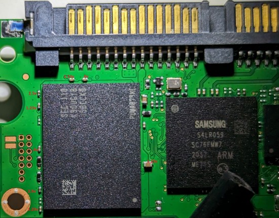

What are the voltages on the tiny bypass capacitors surrounding the NAND flash? Are these supposed to be 1.8V/1.8V NANDs or 1.8V/3.3V?
PostPosted: November 1st, 2022, 21:33
Posts: 111

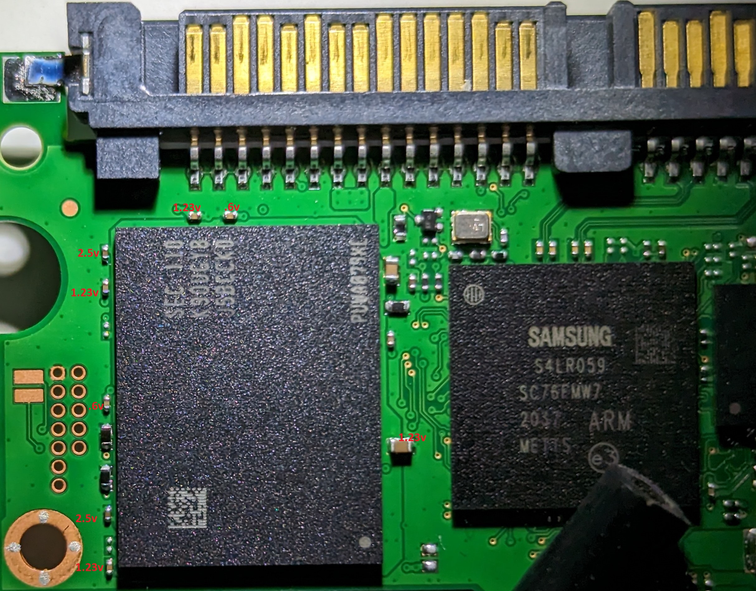

readings attached
PostPosted: November 2nd, 2022, 16:11
Posts: 17341
It looks like this NAND requires 2.5V and 1.2V.
I don't understand the 0.6V capacitors. Could they be the boost voltage (12V)? I have been told that this voltage is present during writing, so perhaps there is a transistor or load switch which is currently turned off.
Internet searches tell me that Samsung's "Metris" controller has 3 cores, so perhaps V2, V3 and V4 are the Vcore supplies. If so, then I would expect that the resistance between ground and each of these test points should be of the order of 100 ohms or less.
In short, it looks to me as if the hardware is probably OK. I think you need to find the ROM/Safe Mode test points.
If you want to exhaust all possible hardware avenues, try to identify the markings on the smallest ICs and transistors. These are located near the SDRAM, crystal, unpopulated NAND, and load switches. I suspect that the small rectangular IC adjacent to the unpopulated NAND may be a load switch for the Vboost supply.

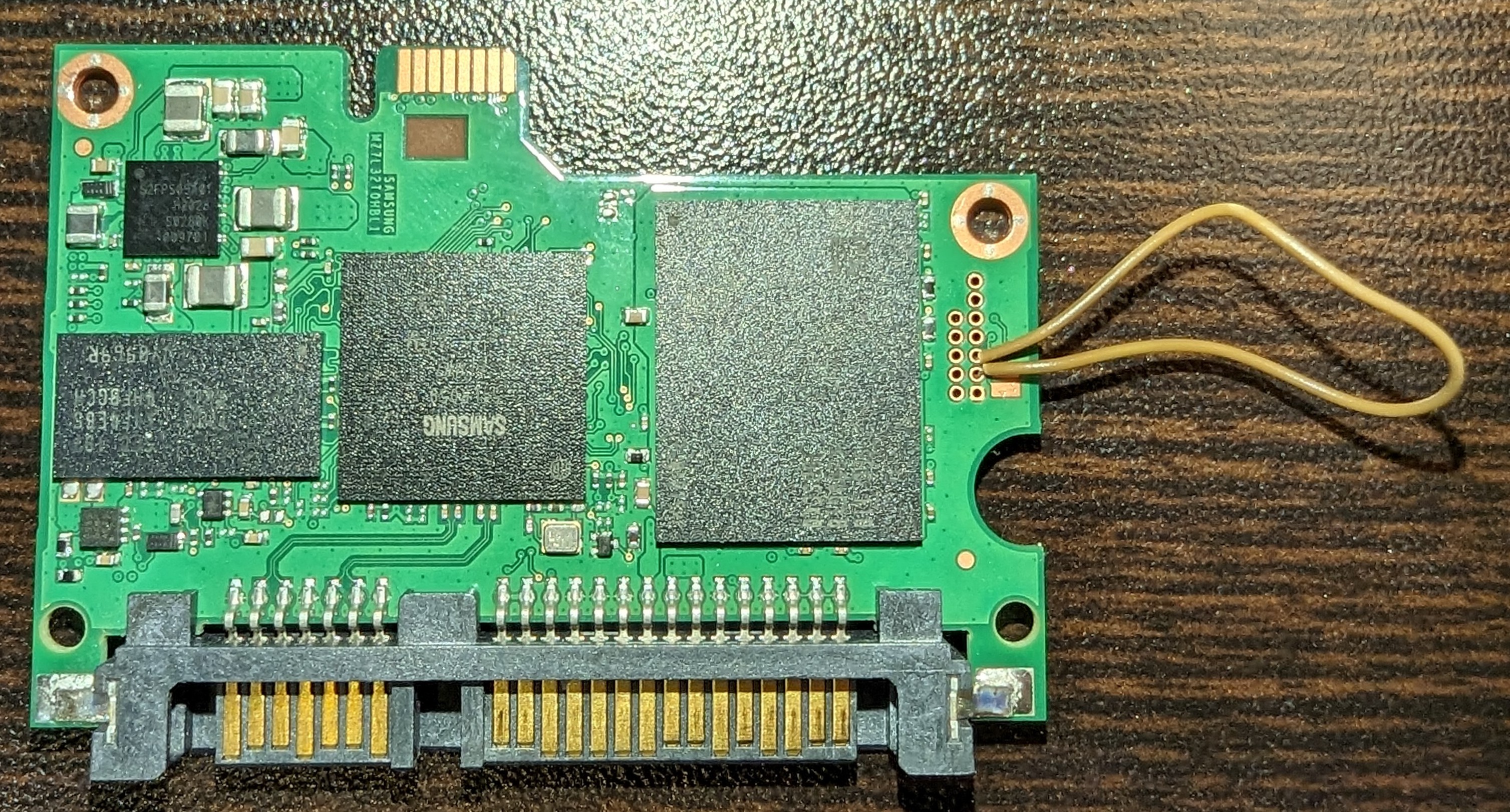

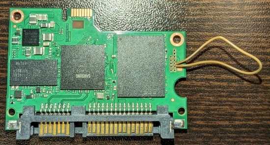

Thank you fzabkar! Probed around and found the safe mode test points, jumped them and gained access to data. ddrescue imaged drive with 99.99% recovery! Here's the safe mode test points
PostPosted: November 4th, 2022, 13:00
Posts: 17341
Did you use some kind of loader??? AIUI, the 870 Evo isn't yet supported by data recovery tools.
PostPosted: November 4th, 2022, 13:17
Posts: 111
No, didn't need to. I assume it was jumping safe mode test points that did the trick, but maybe it just was powered on long enough to finish reallocating bad blocks and come out of busy mode? I was able to remove jumper wire and drive was still recognized for what it's worth.
PostPosted: November 5th, 2022, 3:44
Posts: 1323
I'd be tempted to recheck those low voltages, just out of curiosity.
