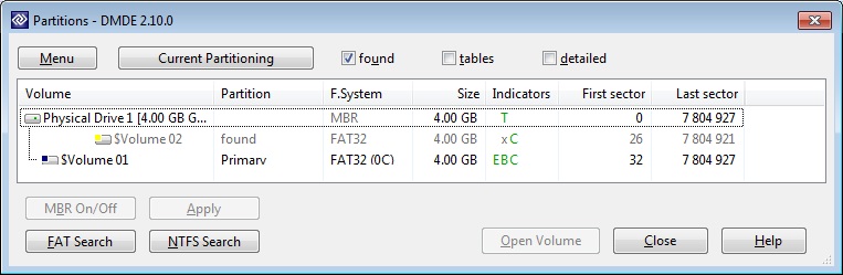

1. Download DMDE http://dmde.com/download.html Install not needed, just unzip.
2. then put the card to a PC and ignore any messages(but hope for one as this means the card isn't totally dead in most cases).
3.start DMDE and if the card is detected, and Physical Disks selected in the left pane, you should see it after clicking down the list on the right. Select it and click OK.
4. on the first window that pops up, you should see something like:
right-click the Physical Drive 1(or equivalent on your system) nd choose create image/clone.
If that works, use any recovery software on the image such as GetDataBack or R-Studio.
if you cant do the above only option is send to someone that does Monoliths.
