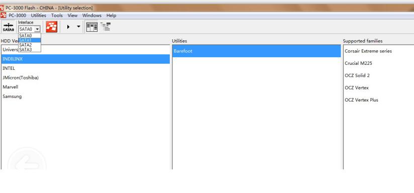

Ace lab PC-3000 EXPRESS+FLASH can decrypt

He most probably wants a FREE solution :mrgreen:
NB. if the problem is reuse the SSD loosing everything on it (TOTALLY) it should be done using vendor tool, otherwise, especially if there is other encryption AND DATA IS NEEDED, need dedicated tools, intervention and..............................
(unless you know / can get master and / or user ATA password)
P.S. do not ask me anything, just in case....
