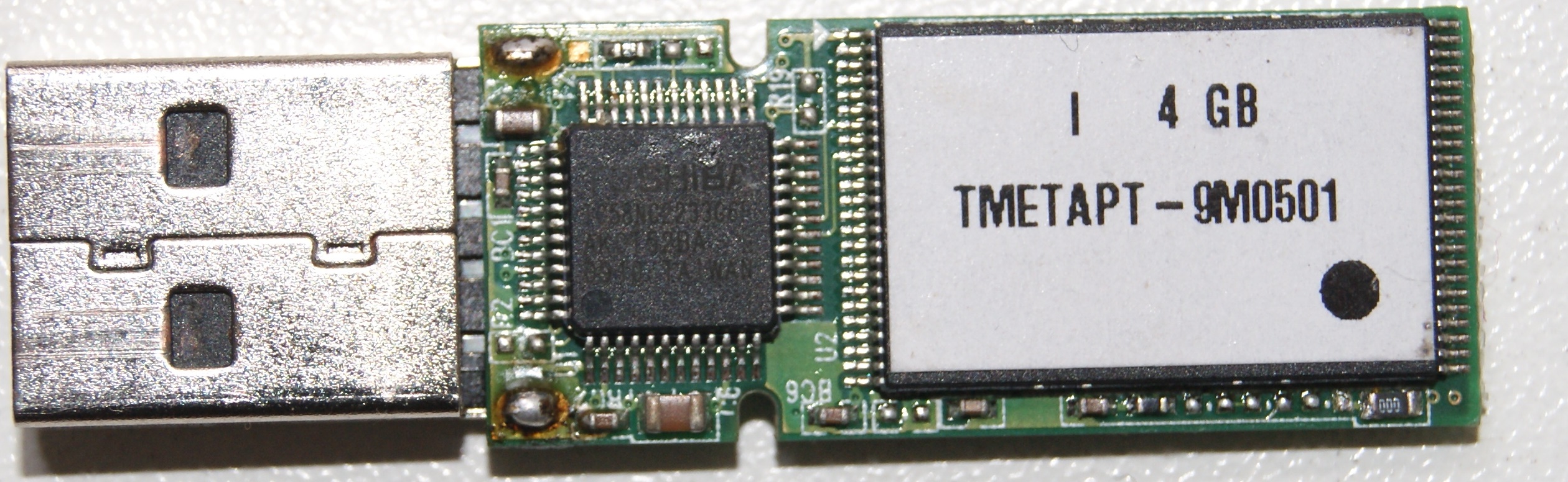

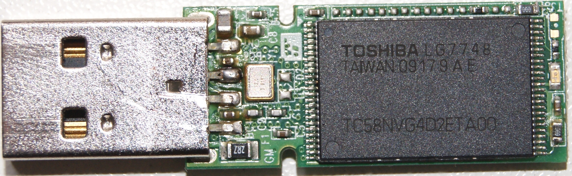

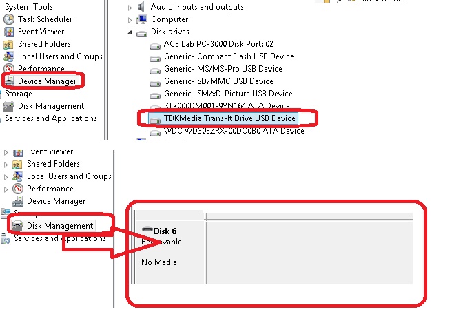

Hi gurus!
Can you help me on USB pendrive testing?
When i plug usb on my computer the LED blinks for about 5 secs, the penDrive is recognized by Windows but no acces to media.
Any help apreciated.

The controller is likely gone stupid. You will need flash recovery tools where you can remove the chips, get dumps and then virtually reproduce the controller and recover the data. If you don't have the tools already (which I am assuming based on this post), you should consider outsourcing to a lab that can help you.
Unless I'm missing something, this should be a relatively straight forward recovery for us.

The only simple tests I can think of would be to measure the voltage across the 2R2 resistor. That will tell you the current draw of the pen drive.
Another test would be to measure the voltage across the capacitors. There should be +3.3V for the NAND flash.
Also check the zero-ohm resistors.

Likely not an electrical issue. I agree with Luke.
You can try and take an image of the disk and the case of the partitioning/filesystem being messed up, this should work.
Follow the instructions I gave in my second post from here:
http://forum.hddguru.com/viewtopic.php?f=10&t=29110
key points, insert your drive but don't click off any windows messages or do anything else apart from the steps..
I think it is a controller firmware/firmware parameter corruption issue. Some of the Parameter of the USB firmware relate to the NAND flash chips properties. if some of these parts are corrupt, the controller can't talk the flash chip, which is where the data is. Other times it is basically disk partition or FAT information that is messed up and you can recover fairly easily.
