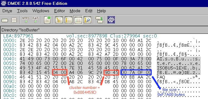

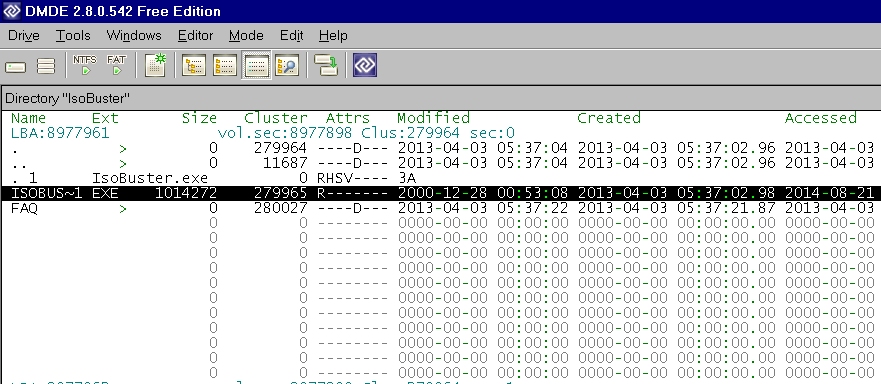

Let's say we start with a bunch of small files.
    file #1
    file #2
    file #3
    file #4
    file #5
    file #6
    file #7
    file #8
Now let's delete several files. This leaves us with holes.
    hole
    file #2
    file #3
    hole
    file #5
    hole
    hole
    file #8
Let's assume that the drive is very full, and that the next audio file is a large one that is laid down as several cluster chains, each filling the next available free space. As you can see, the file is severely fragmented.
    audio data cluster chain #1
    file #2
    file #3
    audio data cluster chain #2
    file #5
    audio data cluster chain #3
    file #8
    audio data cluster chain #4
The file's size and the location of its starting cluster is stored within the file's directory entry. The location of each cluster chain is stored within each copy of the FAT. Formatting a drive clears the FATs, but it leaves the data area intact (apart from the root directory, which is cleared).
When the data recovery software scans the data area, it locates the directory entry. This enables it to identify the file's starting cluster and the file's size. However, the software has no way of knowing that the file consists of several fragments, so it assumes that the file is contiguous.
This means that the recovered file might be assembled from the following consecutive fragments:
    file #2
    file #3
    file #5
As far as the software knows, these fragments might just as well be a single cluster chain constituting a single file with the correct size. If you now fool the software by increasing the file's size, then it will incorporate the succeeding fragments into a larger recovered file.
The recovered file will now look like this:
    file #2
    file #3
    file #5
    file #8
    extra stuff
There will be additional "noise" at the end of the file.
I have attached two screenshots from DMDE. They show a file, IsoBuster.exe, and a subdirectory, FAQ, within a FAT32 directory named IsoBuster.
Here is Microsoft's FAT file system specification:
http://staff.washington.edu/dittrich/misc/fatgen103.pdf
