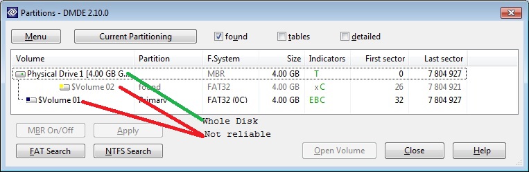

if you use a disk imager such DMDE to take an image/clone of the whole disk, not just any partitions it might find.... and running on the image GetDataBack or r-studio doesn't find any files when told to ignore fat and search for lost files.. then I think you are S.O.L.
You say the drive works, otherwise I may suggest chip off solution, but in this case I think not.

doesn't sound good, but did you take the image of the whole disk, or partition? If the whole disk then I would say probably out of luck. If you did a partition I can only suggest retrying with the whole disk. If the Imaging process worked, it is odd not to find more if the format was only a quick format. If it was a full format, then not so odd.
