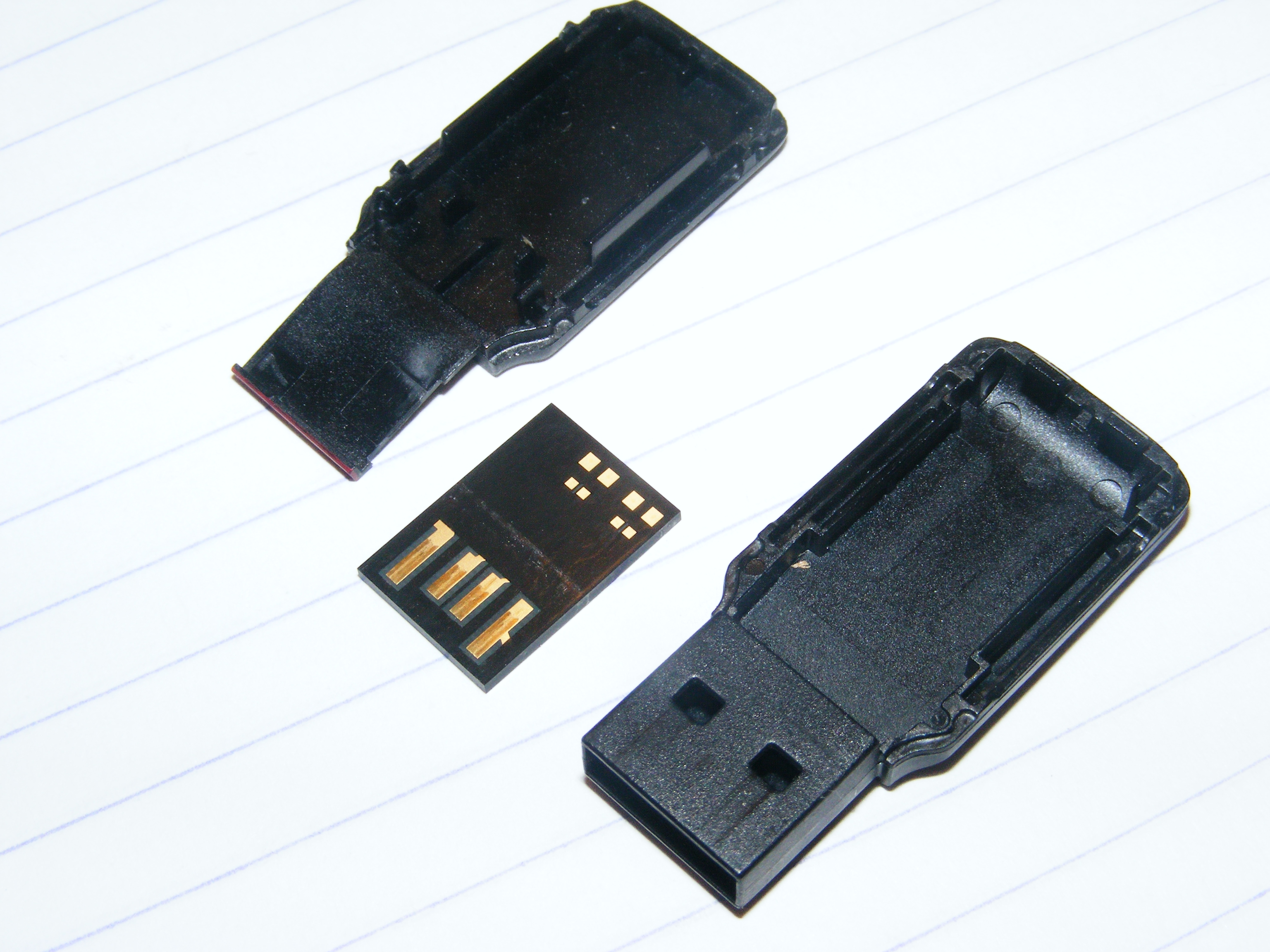

Client bought this to me today, I was fully expecting the more traditional PCB + controller + flash configuration, instead I cracked it open to find just a monolithic PCB, obviously with all the wafers integrated ( very impressive ).
In Linux, when connecting, it's detected but all the information beyond the model type and brand is wrong.

Are there any recovery options?
ddrescue pulls the entire 64MB, but it's just zero bytes the whole way through.

Oh, here's the photo - was meant to add that to the original post.
File comment: USB flash, now in monolith format :(

It looks like controller issues, and would be solved(if not encrypted) by the normal monolith way, if someone has the pinout, and if they are able to figure out the layout/mix.
sometimes these monoliths get a fine crack in the circuit somewhere, I have seen a few photos like it, and I have had 2 in that were cracked.
These monoliths arent easy to deal with! :)

No denying that! :D I actually have requested the client's laptop to search for remenants of the file on their HDD instead of trying to fix this one.
One option I was thinking of was to reflow the monolith, but I suspect that'd actually make things *worse*.

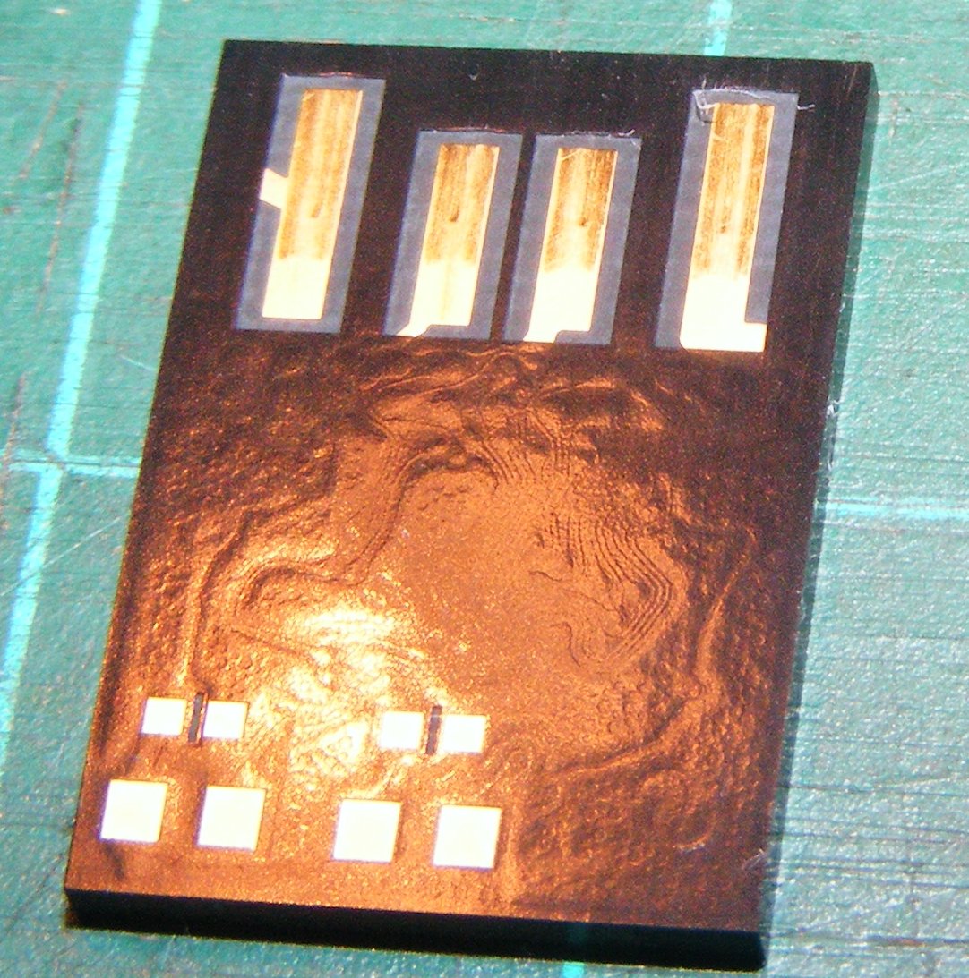

Can you make photo of PCB, that we can see traces under layer?
Or just compare to this: http://www.odzyskiwanie-danych.com.pl/m ... abase.html

This is the best I can offer for now. It's very much like the 32GB Sandisk one already on the page Arvika.
File comment: 8GB monolith

It looks the same. Pinout is under develop...

Have to say I'm quite surprised it was damaged from the physical attack. I can't see any flex/bend on the board. Wondering if it was just purly conincidental that it electronically died at about the same time the person also bent/broke the plastic enclosure.

Thats possible, maybe a slight electrical surge during a connection/disconnection if it was bent in the USB Port.

Yes, according to the client it was knocked out of the socket.
I wonder if a downside of these monoliths is the lack of suitable protection components that are normally present on the normal SMD assembly boards?
