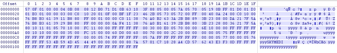

I have made some experiment, on an 8 GB BGA NAND chip, to see if directly heating the chip with a hot-air gun from the top damages the data. with a temperature setting of 230 centigrade, it took about five minutes to get the chip out. The chip was identified and read without any problem; but no further. PC3000 could not identify the ECC the XOR, the Interleaves althoughter.
HaQue wrote:
There are also tips for the hot air station that break the air out into 2 thin lines each side to blow on the pins only. I don't use them though, a little awkward. quite a few different ways, such as Kerns also.
 Post subject: Re: Desoldering NAND memories: Which is better....
PostPosted: August 20th, 2014, 10:12
Posts: 3977
I've been getting a lot of jobs that pc3000 can't do
It may be the XOR and ecc is not worked out yet and even could be dynamic cor or something
What does the data look like in a hex editor or in a bitmap
PostPosted: August 20th, 2014, 11:58
Joined: November 15th, 2012, 17:47
Posts: 226
Here are sector 0, sector 2, sector 67798:

well, sector 0 if you invert it (paste into winhex, then choose Edit--Modify Data --then invert bits)
you get:

and some of the SK controllers are a real pain

If I read the result correctly, I think that the result of the inversion (SKYMED) indicate that there is a high probablity for the existance of Inversion, and the absence of XOR. I do not what else is visible for the trained eye like yours.
Your further input is highly appreciated.

looking at Flash dumps by alone sectors isn't easy. Often there is inversion and XOR, or the SA will be not XOR and rest will, or SA will have different ECC... and an combination you can think of.
But in this case, looks like no XOR, as in the sector 67798 you can see 2 English words "parent" and "Band".
Is it SK6211, SK 6221 or SK6226? Sometimes these have weird structures for SA

It is SK6213.
