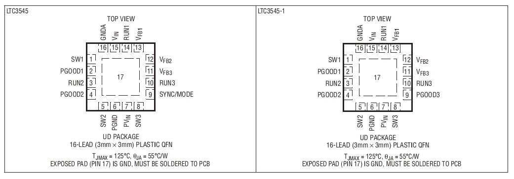

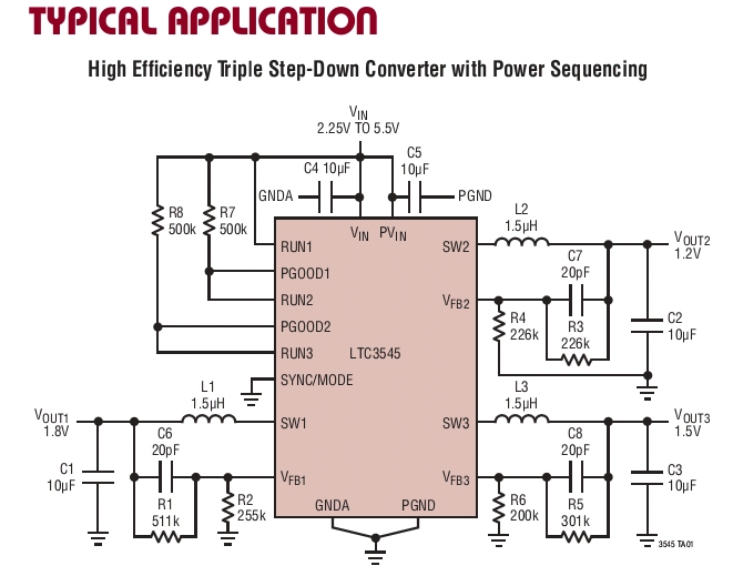

The chip in the hot area is a triple switchmode regulator. It probably generates the 2.5V, 1.0V and 1.5V supplies.
LTC3545, Linear Technology Corp, Triple 800mA Synchronous Step-Down Regulator, 2.25MHz, 2.25V to 5.5V Input, marking LCSR:

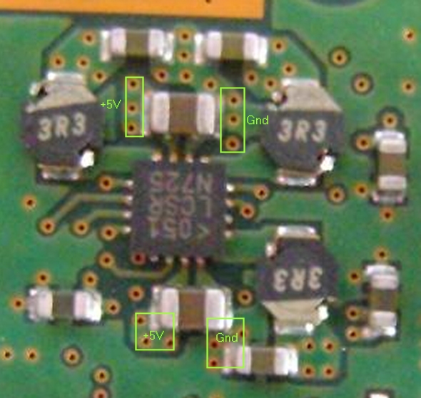

Measure the Vin and PVin voltages at the LTC3545 regulator. They should be +5V.
If they are missing, then it will probably be because 5VF is not present. In fact 5VF may be the chip's supply voltage. It would help if you could supply a detailed photo or scan of this area.

Could you carefully measure the voltages indicated in the regulator photo?
Could you also measure the voltages around the "5VF IC"?

Well, I've tested the regulator voltages, the upper one is giving me 4.70, the one below is giving me 4.76.
As in how to measure the voltages around the 5VF, I wouldn't know how to do it properly, I was trying to read the 5VF IC with a magnifier, but I couldn't read it, instead, I've noticed the IC to be a little inflated, I might be wrong, I would try to upload a high res picture as soon as possible.
