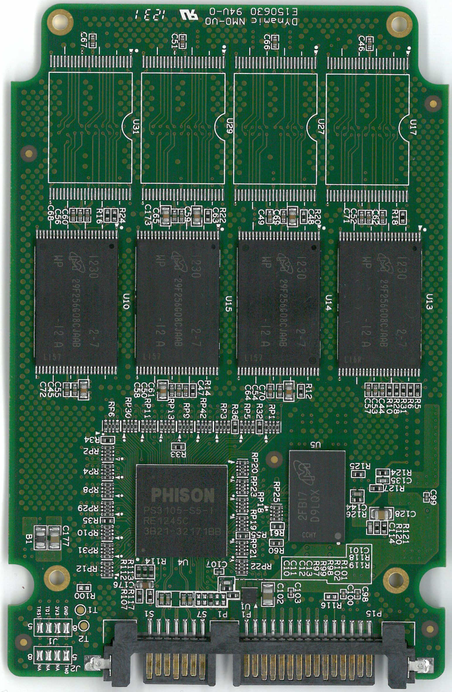

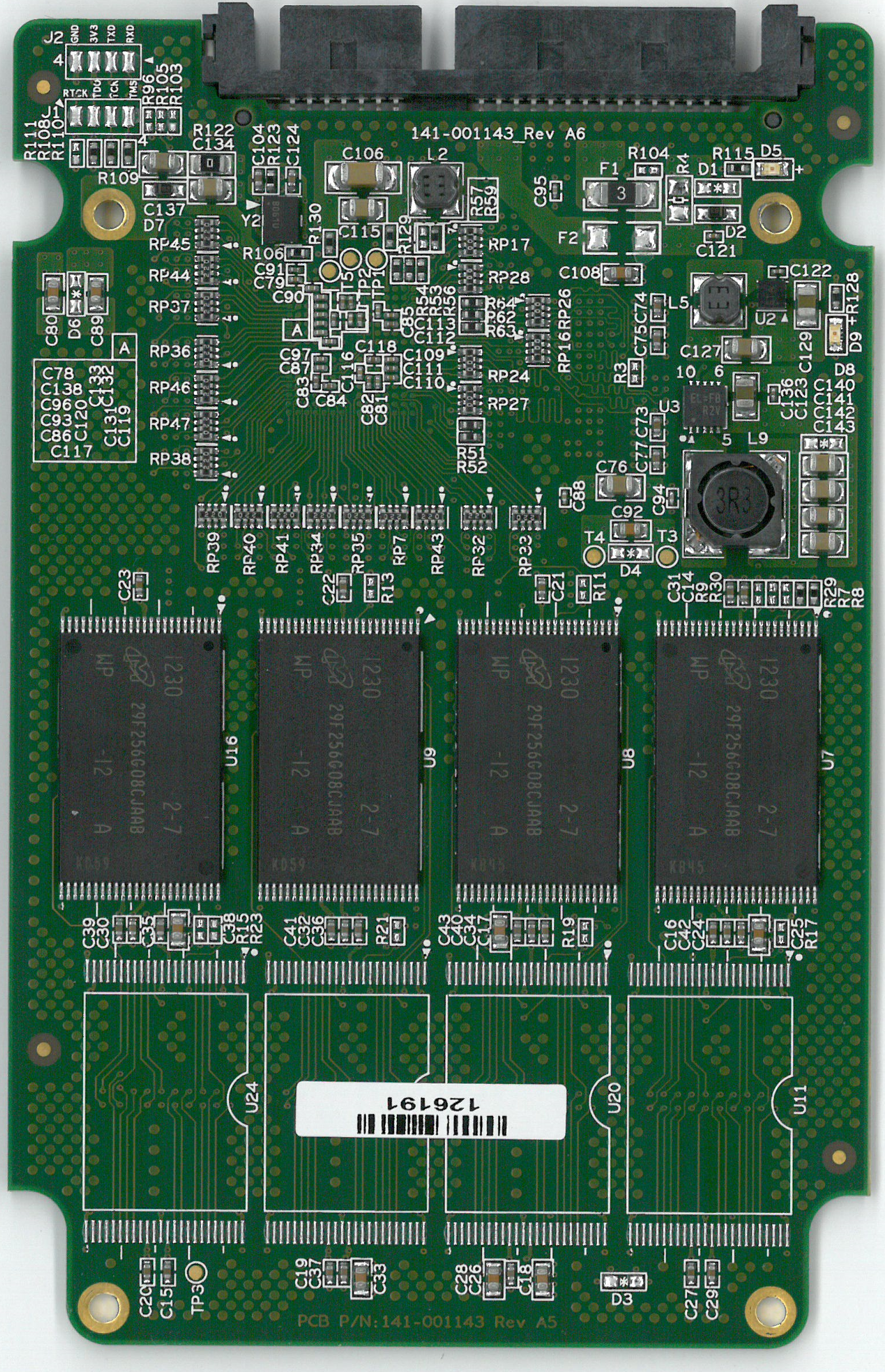

I have a broken crusial V4. The controller is a PHISON PS3105-S5-1. I unsoldered and dumped one chip to see if I could do something.
So it doesn't seem encrypted but i'm having trouble getting the xor.
Can someone confirm (or not) that the xor is [ID=40: BLK=256 PG=8640 (1074-1070x7)] in PC3k Flash. It seems to work on the first two sectors of the page but not after...
For info, pictures of the drive :

what ECC did you detect ?

No ECC detected... that's also a problem...
I'm starting to think I'm playing out of my league.

Just detect page structure.
mostly only first page bigger then other but this controller can have few bigger pages.
After detect all sector lenght in page add this for ECC.
if ecc detected run fix and post structure, page size and block size here.
I will make xor for use in PC3000.

Posts: 922
Structure for this case is: DATA2048_SA8_ECC90_(DATA2048_SA2_ECC90)x3.

Arvika is right.
Considering this chip is MLC chip, block size must be 128 (256) pages = 1105920 (2211840) bytes.

Dear Gurus, thank you for your comments.
Structure given by arvika seems ok but I still can't find and correct ECC... I'll work on that today.
The chip IDed 0x2CA805CB so block size seems to be 256 pages.

Block is 512 pages.

This ECC not has in PC3000Flash.

XOR was found for this case remotely :)
