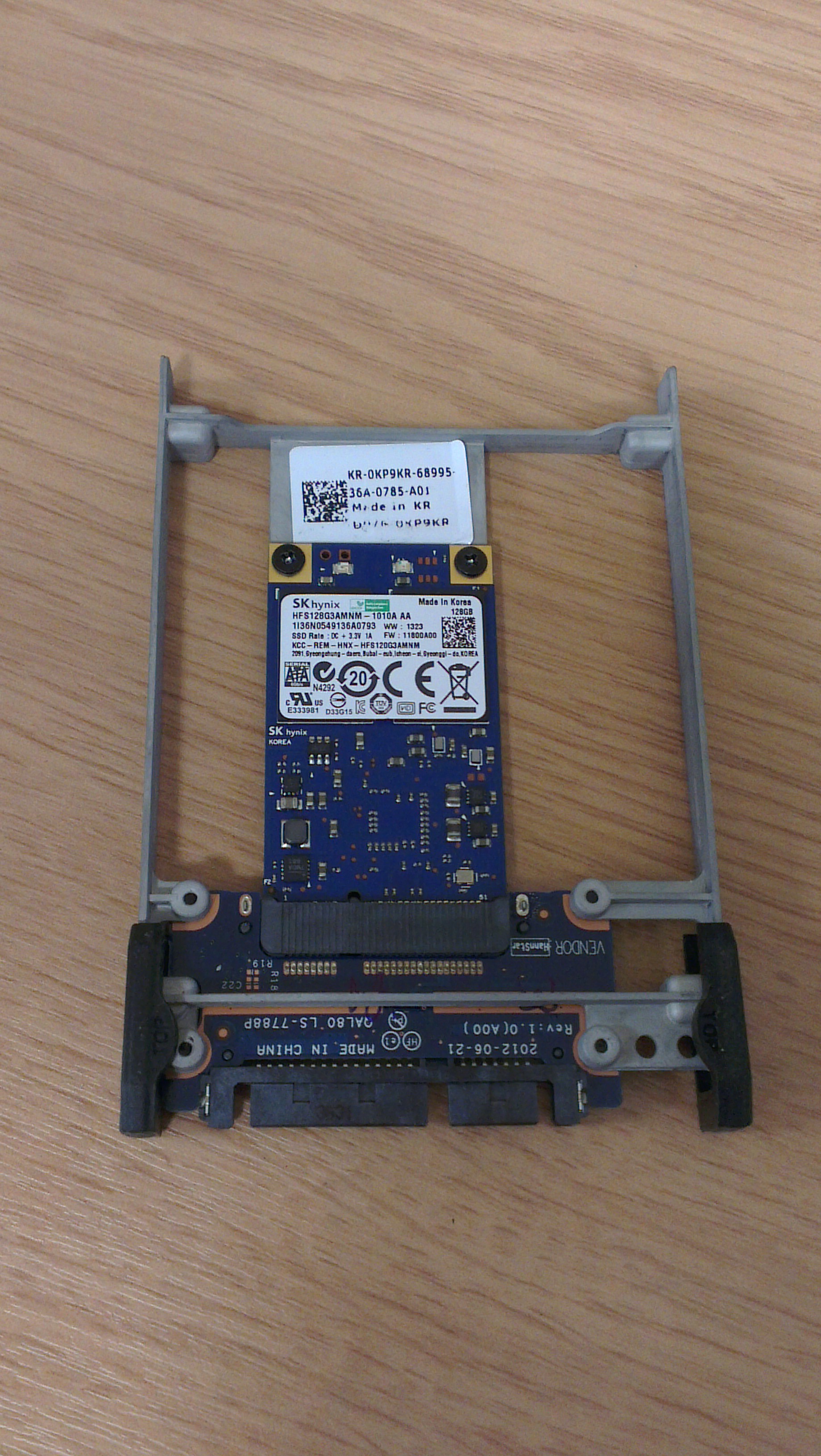

One of my SSD-drives have given up. The data on it is not important (got it on a backup-drive) but as for now I'm curious about what exactly happened to it, and if there is something that can be done to make it work again. Like I wrote, the data is not important so this is a "playground".
See the image. There are two LEDs near the top sticker (activity + power?), none of these two are lit. This gives me two clues:
1) the controller chip is dead
2) the power source (charge pumps) are dead
3) 1 + 2.
There is zero activity in /var/log/syslog when I put the drive in a SATA-cradle.
What can I measure on the boards to find more clues?

Hi! Just one thing I noticed is the main board has F2 written in the lower left corner. A fuse? But of course in real life it can not be so simple. :wink:

It won't help you fix it, but here is a datasheet for the SSD:
Hynix_mSATA_SSD_Datasheet__HFS064_128G3AMNM_(Rev1.0)%5B1%5D.pdf
http://cfile208.uf.daum.net/attach/1376 ... A8D204C214
If the fuse is OK, I could try to help you with some test points, but I would need a much clearer photo or scan of the components. At the very least you would need to tell me their markings.

Unfortunately it wasn't. In the top right corner there's F1 without any components near, and on the bottom side of the PCB there's F3/F4 just right under F1/F2.
I have however played around a bit more now and I can confirm that the board is powerless. Measuring with DMM straight on the SATA-power connector all is well (0V, 5V, 12V [3.3V unused]) but measuring every pin on the mainboard connector whilst powered up yields 0V. That is, every pin is 0V. There must be some sort of a break somewhere, but there is nothing obvious on the top sides. I really had hoped for a blown fuse, but there seems to be none. Only Cx/Rx/Ux on the power board. The two Ux are connected to the data-pins (one chip per data-pair) on the SATA-cable so they're not in charge of the power.

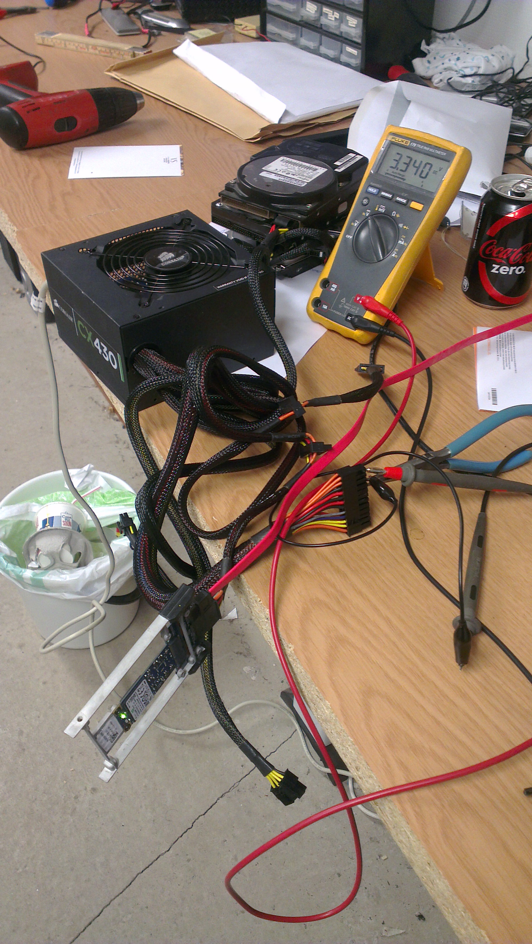

Well what do you know, the datasheet I found said the opposite; 3.3 not used.
Inspecting my cradle, it doesn't provide 3.3 so I hooked up an ATX-psu with 3.3V-sata and the drive-LED starts to flash red!
Still an error ofcourse, but atleast now I know it wwas my cradle that fooled me. The drive still goes unnoticed in the logs but now - with power - I can atleast inspect it a bit more.

There's definately a power problem present. Using a DMM measuring on the orange PSU-cable I see 2.4V, not 3.3V as expected, when the drive is connected. If I remove the drive, I measure 3.3V.
Could this indicate a short circuit of some sort?
 Post subject: Re: Samsung SSD 840 Pro, no activity LED
PostPosted: November 6th, 2014, 17:26
Posts: 17256
Are you loading the PSU correctly? That is, do you have a sufficient load on each of the +5V and +12V rails? A partially loaded ATX PSU may not regulate properly.
PostPosted: November 7th, 2014, 7:54
Posts: 191
Location: Sweden
You know what? I forgot to load the PSU. Now I hooked three old, power-consuming, ATA-drives to it and the 3.3 is balanced. And I can reach the SATA-drive.
