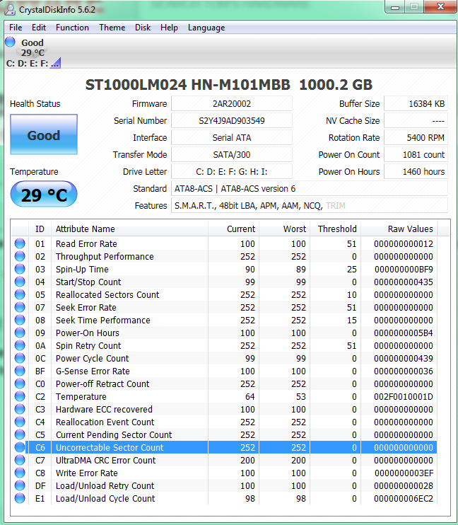

Please see the screenshot. SMART says that the hard drive has read errors, write errors, load/unload retry errors. Is this serious enough to start a full backup at once?

@baghu, ISTM that your SMART report is typical for your model and may not represent a real problem at all. You could compare your results against others: http://www.google.com/search?q=st1000lm ... eallocated |

Your SMART data is perfectly fine. High numbers are good numbers, low numbers are bad. If you see that 252 reallocated sectors number start to drop, then you might have an issue. That having been said, you should always backup. A perfectly healthy drive can be dead in 2 seconds due to a power surge. |
