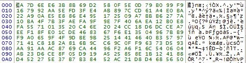

A client sent me a flash drive that he says was encrypted by a virus... any ideas which virus or how to recover?
Every jpeg and doc file starts with the same 16 bytes, all other files are untouched.
Filesystem appears fine otherwise, no FAT table corruption.

Upload your file to http://www.virustotal.com.
The file will be scanned by about 40 AV products.

jeremyb wrote:
..all other files are untouched.
Did you mean to say "all other bytes are untouched", in any one file?
If yes, along with the other details, sound like a Ransomware virus of some sort.

Let me rephrase, the entire file is filled with random data except the first 16 bytes which are always the same...
It sounds like ransomware.

Its not an XOR overlay or USB Error message, the file system is intact, only specific files are targeted. Crypto doesn't appear to be ECB..
I think ransomware is the answer, stupid question but I might as well ask, has anyone ever cracked one?

yes, there have been solutions for a few variants. Companies such as F-Secure has put out tools.
The criminals are learning though... not leaving keys in registry for example.
some of the more recent variants you are S.O.L.

There is a new version recently. It encrypts all image, txt,rar, office, pdf files. It covers all local, network, usb drives. It encrypts the first 2MB, rest of the file is fine. But 2MB is enough to kill all your important files.
It should be AES128 or AES256, I guess no solution at the moment.

Looks some bytes xored 0x08 in Sasha sample. different as Jeremy sample.
