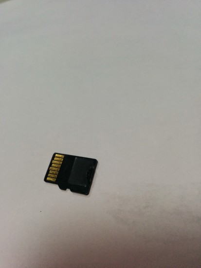

Hi
Another problem with a SD card.
This one has no brand. It's a micro SD card 8GB.
The story:
The client said that she changed the card from a Nokia phone (old one with Nokia OS system) and inserted it into a smartphone with Android. Nothing else.
Problem: the card is only recognized with just 30MB. Can't get it to get the other space.
Can only a swap of phones create this kind of problem? Or could there be still something that she didn't told??
Any hints to access the full size of the card?

I have PC 3000 flash with me .In this case i think see has bent the card .Try checking for a bend dent under microscope please

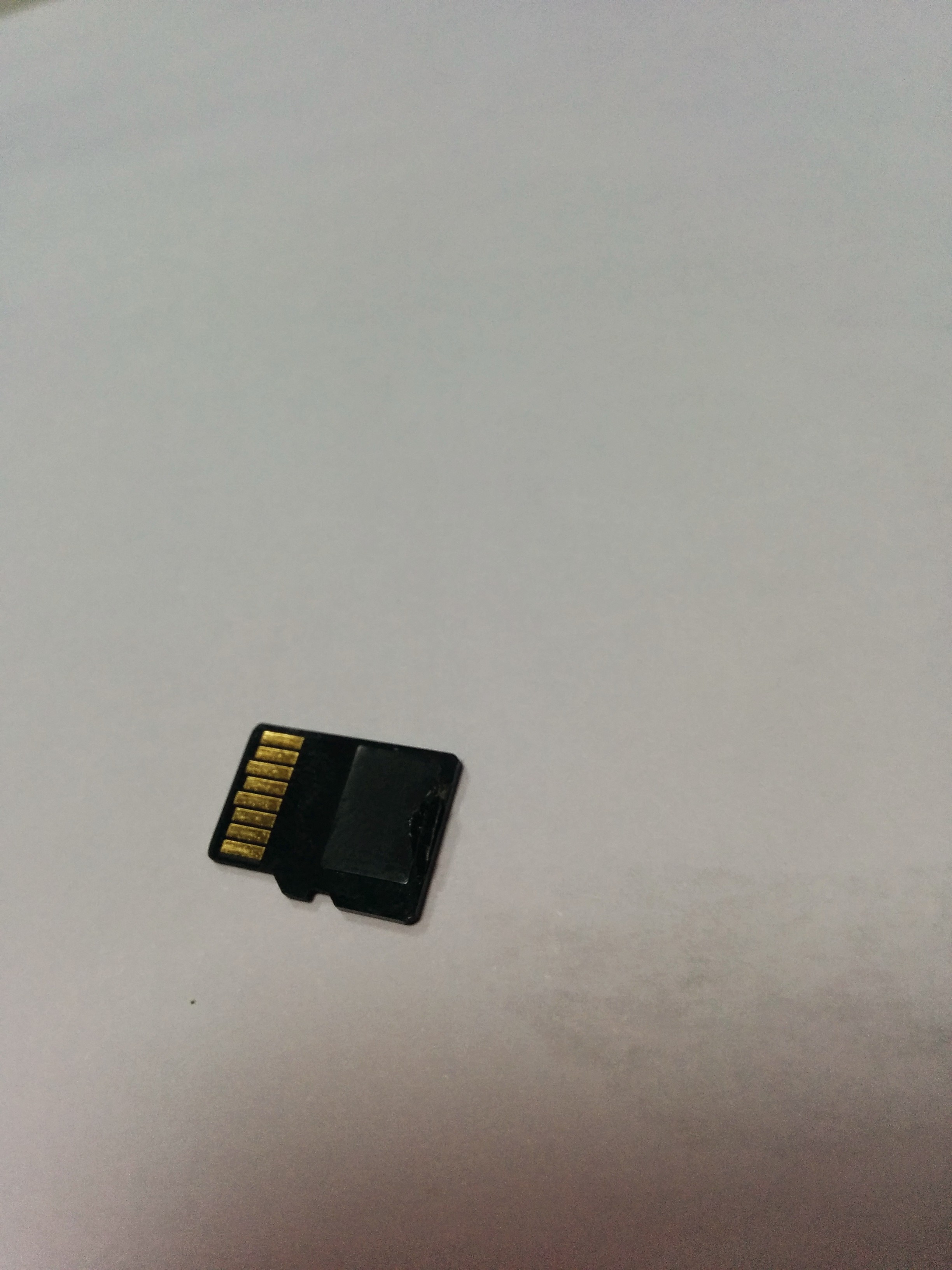

Hi Amarbir
Here's a picture of it.
It has a very small dent on the side, but could this be the reason?

Probably flash memory failure.
 Post subject: Re: Micro SD card with just 30MB
PostPosted: January 8th, 2015, 16:58
Posts: 3977
I have seen this a lot with Kingston MicroSD's.
You will have to wire it to an adapter to read as with any other Monolith, and hope that it isn't what Sean says! I would say it is 50/50 chance to recover because it could be controller failure or NAND failure.
If you remove the little black sticker you will see the pads to solder. you will need the pinout of it. Which Flash DR equipment do you have?
BTW, you are allowed to crop pictures! ;-)
PostPosted: January 8th, 2015, 17:39
By flash memory failure, I meant degradation to a level where the controller cannot perform ECC correction, so the device "shuts down".
If this is the case, then you'll have to do as Brian says. Wire into the memory direct, read the raw data (with the SA data containg ECC data and so on) and then re-assemble the data with software ECC. Easier said than done!!!
