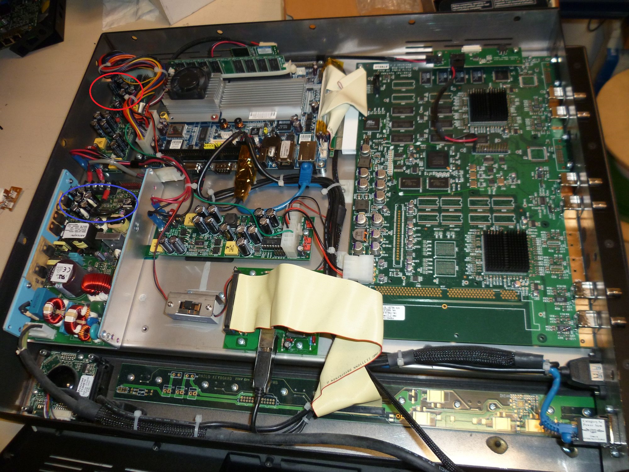

Ok, thank you for your answer. In fact, I just want to recover an old ide ssd drive with only one nand chip (1GB). I already have the hardware for the nand reader, so why not try? If I can't do anything, I will buy another ssd drive, with unknown software already installed.

HaQue wrote:
Is the SSD for some type of embedded system?
You're right, that's a video monitor.
There is a label on the pc motherboard, where it says "Windows XP Embedded". The mystery is lifted.
I had the same problem there is a year or two, I bought a new ssd, and the monitor has booted normally. I thought it was the same thing this time, but I just saw a lot of bad capacitors on the motherboard. It's certainly the real problem. :oops:
Are you referring to bad caps on the motherboard pictured in your post? I don't see any. Did you test them with an ESR meter or something, are you referring to another MB, or am I going blind?
 Post subject: Re: nice article on NAND Flash RE/hacking
PostPosted: January 5th, 2015, 23:04
Posts: 3977
I don't either but I suspect the ones in red circle first and blue possibly second choice. I would have thought the blue circled ones would go first though

Posts: 738
Location: Ottawa, Canada
They look okay to me, although it's hard to see the ones in the corner clearly. Because they appear to be the same size as healthy others on the board, I suspect they are fine. The ones in the blue circle look fine, too. That white stuff is just the gunk they put on them to keep them from vibrating, I believe. (I used to see a lot of that in CRT monitors and sure wish I knew of a source. It's terrific stuff!)
Did you try to access the SSD via an IDE motherboard in a regular PC?
Did you measure the voltage outputs of the PSU at the LHS?
As for the capacitors, I would take LarrySabo's advice and test them in-circuit with an ESR meter.

I made an adapter for my ide/sata to usb converter, and the ssd is fine, I can see files and directories.
So I have to change the bad caps and see what happens.

Posts: 738
They are clearly bad. I hope new ones help clear things up.
