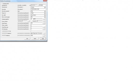

Hi to all ,
i have s flash 16 gb sp with controller sm3257EN Q with two chips toshiba
i can read this two chip with soft center nand reader id 98 DE 94 93 but have many bad sectors
but i can't read id code any one of two chips with nand reader for pc3000 flash while another memories can read
message in log pc3000 flash nand reader

hi again,
in section manual mode in parameters i selected this id chip 0x98DE9493 and afetr read chips but files in winhex are 00000000... to end of dump
i want read these tow chips with pc3000 nand reader
any one help me?

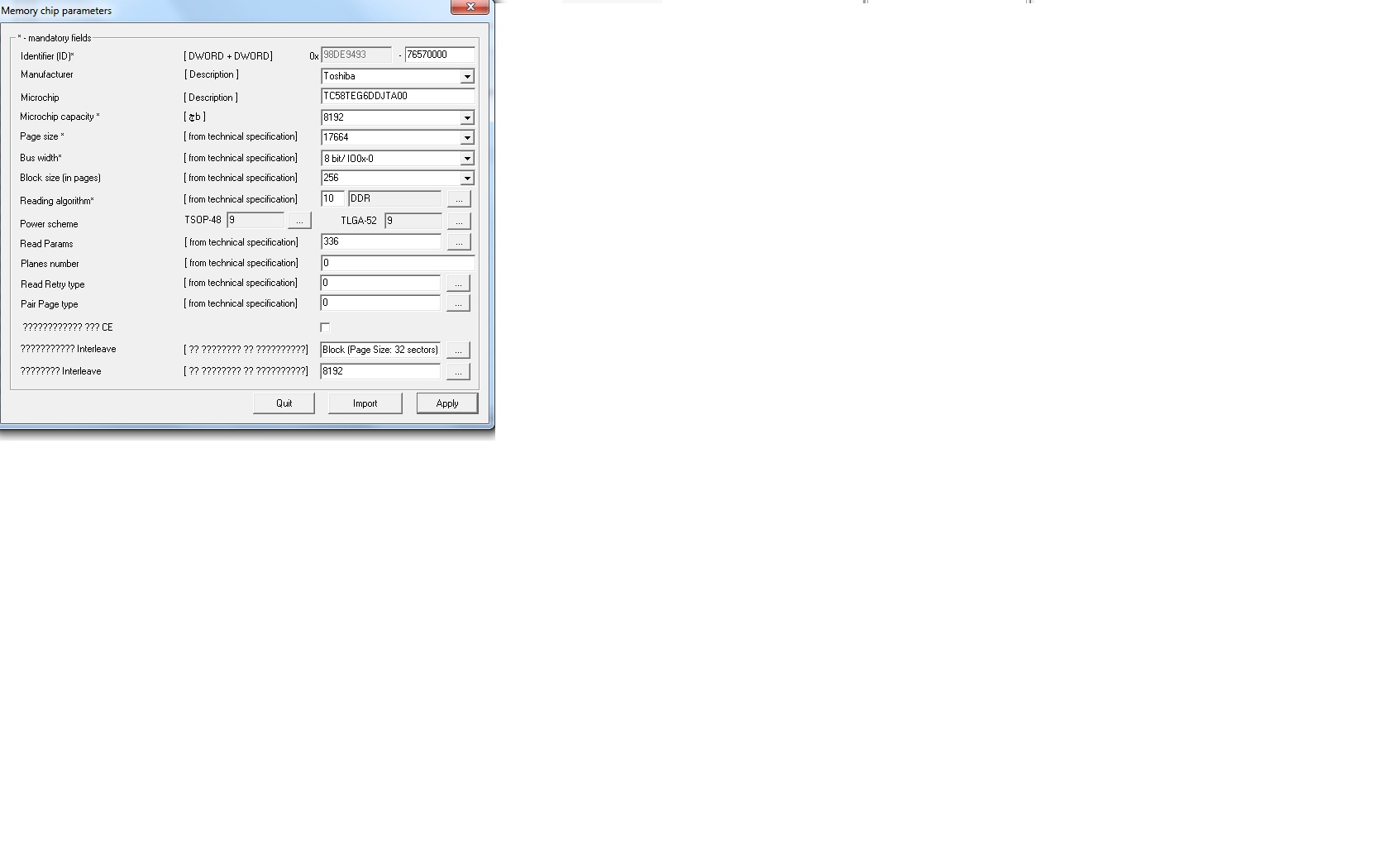

and pc3000

 Post subject: Re: pc3000 can't read but soft center nand reader can read
PostPosted: January 18th, 2015, 5:15
Posts: 3977
In the PC3K settings, is that shown this is trying to read using DDR? I think this chip is not DDR.
I really do not know the PC3K tool..
PostPosted: January 19th, 2015, 1:22
Joined: January 23rd, 2009, 6:29
Posts: 110
hi HaQue,
thyanks for guide
yes, i testing with another chose except ddr (sdr, col2 row3,... ) but no result
i'm doing another work , replace dumb soft center with pc3000 flash and now correctting data with ecc on
PostPosted: February 16th, 2015, 2:38
Joined: April 11th, 2011, 5:02
Posts: 8
Location: RussianFederation
There is an issue with initial power mode for some chips.
Try this trick:
1. Reconnect PC-3000
2. Create new task
3. Insert chip into reader.
3. Start read ID and stop it immediately.
4. Set power modes 9 and 109.
5. Read ID and chip.
