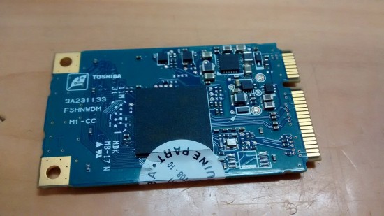

anyone deal with this SSD? seem like SSD turn in to Panic mode.. drive got ready when power on but busy reading id
This drive needs to be switched into technological mode.
The problem is the commands to do so.

Dmitri wrote:
To the best of my knowledge, nobody has figured this out, yet.
