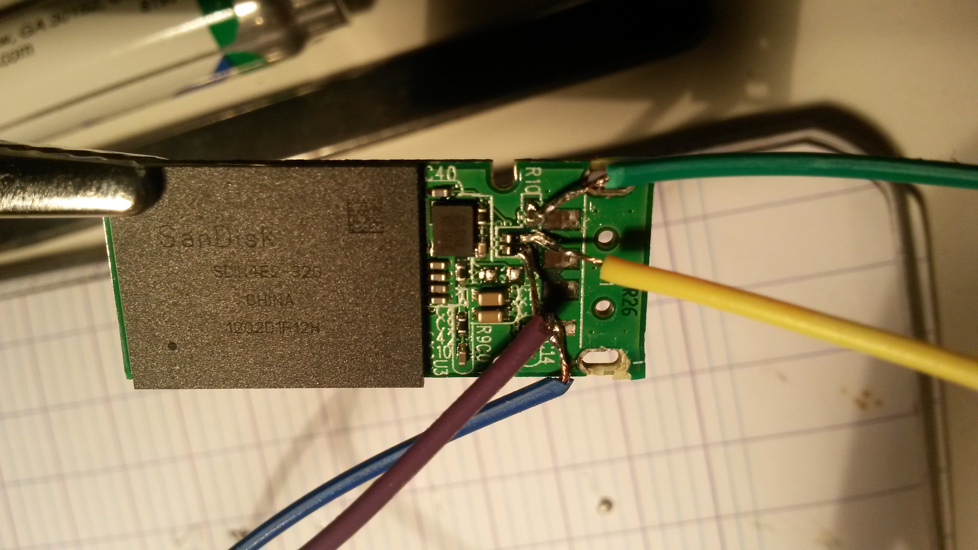

A friend wants me to repair his USB key which has a broken USB connector.
I have soldering the wire from the right to left (5v, d-,d+,gnd) but Windows says that USB key has a problem and can't use it.
Indeed, with geniuscheck, i see that PID and VID are both 0. I think le controller is in a bad state or bricked.
I suppose for this key the VID is 951 and PID is 1642 but I am not sure because on flashboot.ru (http://flashboot.ru/index.php?name=iflash) I can't find the right ship.
My controller chip is skymedi SK7831 and memory chip SanDisk.
Someone can help me? Or can provide me the firmware to reprogram the contoller?

It appears that the SanDisk SDIN4E2-32G is an iNAND eMMC.
I would measure the voltages across each of the capacitors (Cx). One or more should have 3.3V or perhaps 1.8V. If 1.8V is present, then I would expect to see a 1.8V LDO regulator, otherwise the Skymedi controller may have an embedded 1.8V regulator.

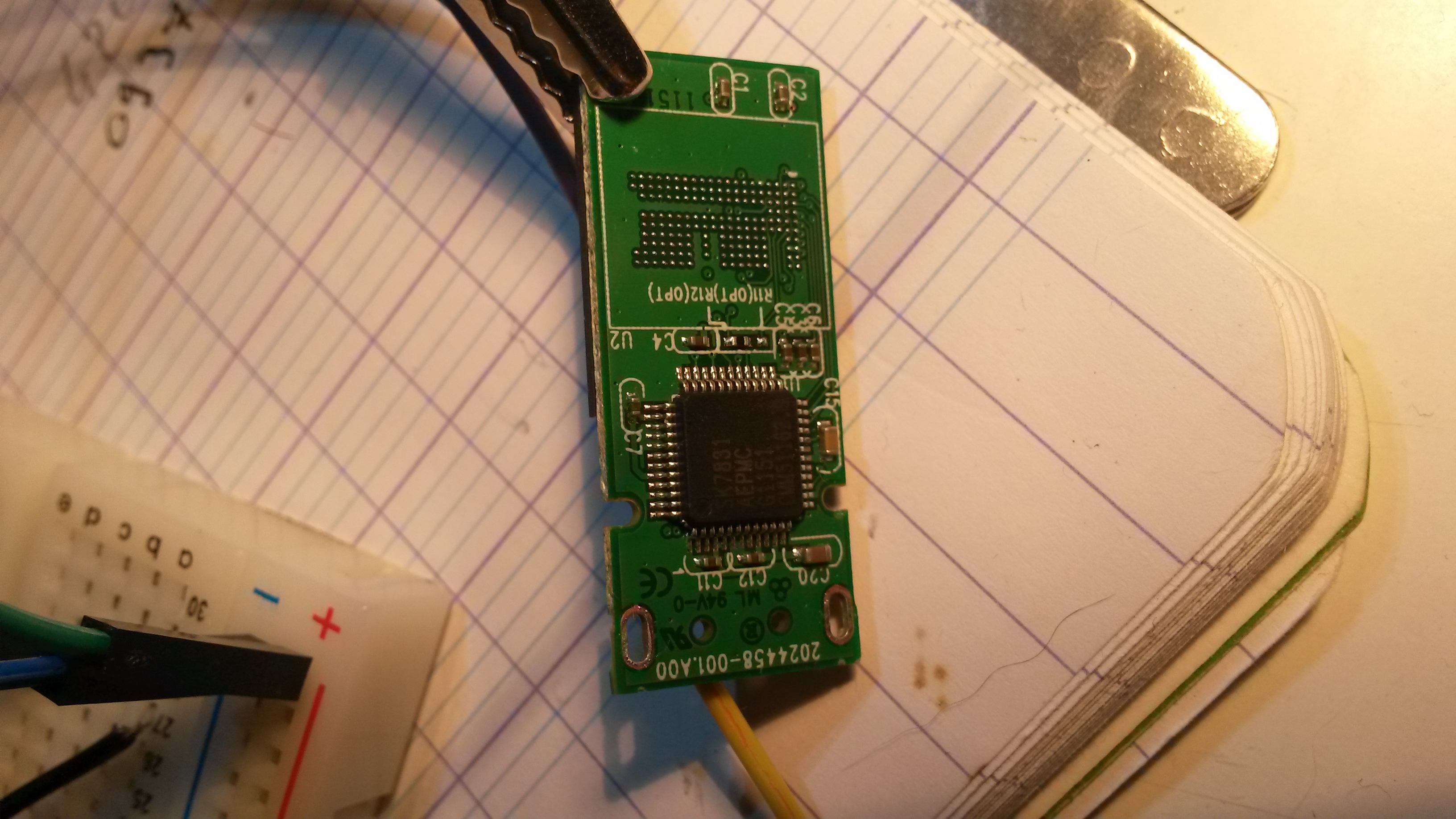

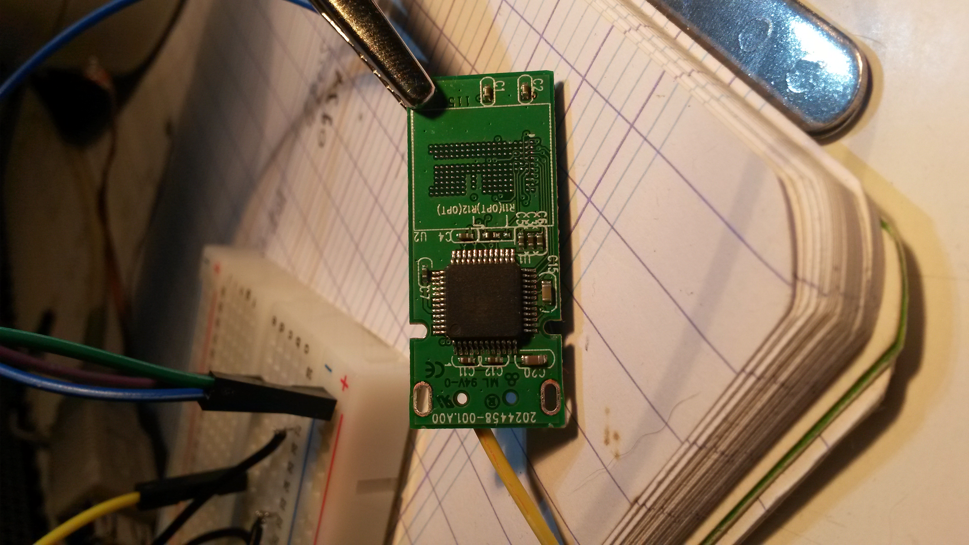

Please find the other side with the sk7831.
The black component near nand has 12.000 and 10 101E (not sure about the first 10) write on it.

The black component with 12.000 on it is a 12MHz Crystal Oscillator. It is what provides timing to the USB circuit(laymans terms)
If you don't know what is what, testing is still possible.. 5 minutes and you could do something like this(example of ficticious values):

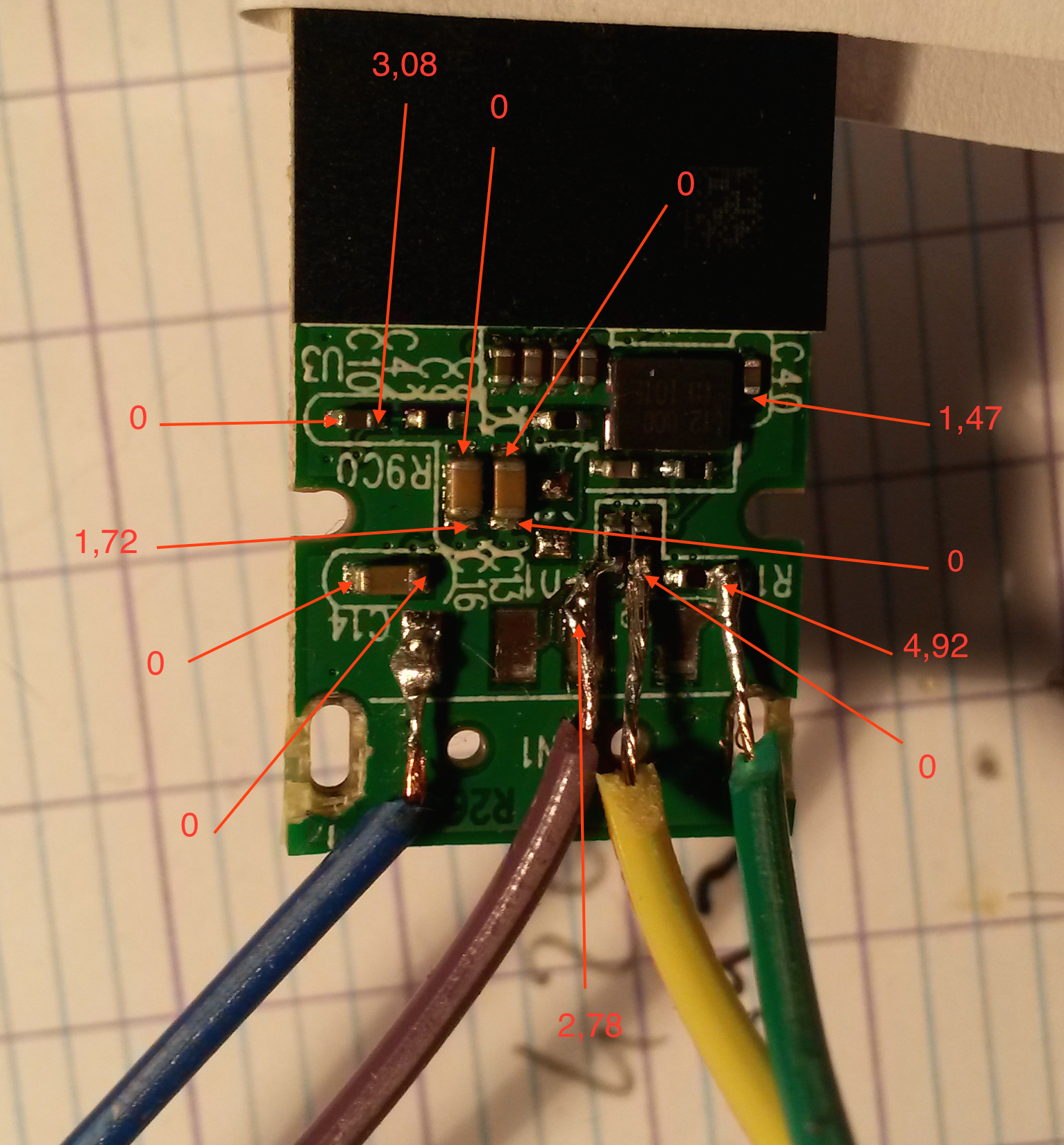

R10 should be +5v, not 0v.. are you sure about that?

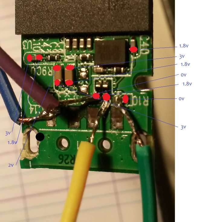

Please find the values.
Indeed something is wrong.

Hi
Does it help you ?
I have to measure all components to find which is burned starting from +5v?

I don't think this issue is to do with components. often when the USB header gets snapped off, this happens... windows cannot communicate. Issues such as BGA/LGA chips breaking pad connections, NAND cracking inside or components having internal damage. I also think that the electrical surges that happen during the event can damage firmware of controller.
Your best solution is to get the chip read.
