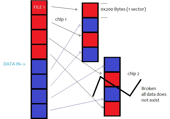

I have somebody who step onto her Emtec SD card and broke it.
When I opened the SD card, 1 memory chip was broken into half and the other was not broken.
On that SD card there are very important pictures, she absolutely want to get back.
After doing some research, I found out that the data was striped over the 2 memory chips.
I started to compare it a little bit with a RAID0 (striped) set of 2 hard drives, from which 1 hard drive was missing.
Is it possible to recover part of the pictures, when 50% of the information of the pictures is missing ?
Is it possible to rebuild those pictures ?

It depends on mixes. If client have lucky it will be possible recover some part of data. If for example mixes will be join by byte - there will be no chance.
What controller? Can you post some pictures?
 Post subject: Re: 8GB SD card, 1 memorychip is broken, the other not
PostPosted: February 13th, 2015, 6:25
Posts: 3977
Just did a SD Card with 1 broken chip.. had join by page in the mix and really there was no recovery. Very minimal files (all corrupt) were recovered and only by thumbnail was there a picture.
SD Cards have mostly mixes that would make it quite low chance.
But do as Arvika says and maybe you are lucky

This controller use Join by Page 0x200 (one sector) so IMHO recovery will be impossible without one nand.

a VERY simplistic view of what is going on. Bear in mind after the Join by page 0x200 there is other mixes applied, making it even more disastrous.
You cannot be missing half the DATA.
In SOME chips, data is not mixed, or mixed between the chips making it possible to retrieve some files. But even then it is not easy work.
