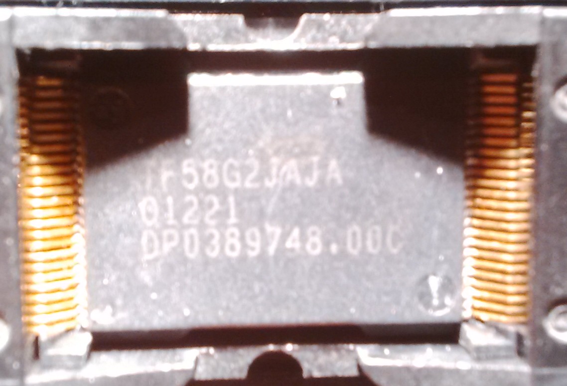

Hello I have this chip
TF58G2JAJA.
PIN 1 is marked on the "wrong" corner and unfortunately this chip has a lot of broken pins due to a drop/fall
So we had to do a surgery operation :-) to sold it on adapter.
Adapter (which is not the best Ace product) + weird pin position on the chip, makes it hard to guess which is it correct PIN 1 (the read chip ID attempts failed)
Having the string TF58G2JAJA oriented correctly (readable) the pin is in the low left corner of the chip instead than on top left corner (as expected)
So... which is it the correct PIN 1
The other two corners (top left and low right) have two identical circular depressions.
Thank you for any hint
Cor
File comment: The deep small pin (hard to see) is in lower left

@Corsari
Is it possible the chip was fitted upside down? The written identification would be on the wrong side and not be viewable in your reader. That way pin one would be in the expected position. I have seen this configuration in the past.

So you do mean that the chip marking TF58etcetc is burned at bottom of the chip instead than on top as usual? Or what?
Pins were bended but their original shape has been figured out (looks like correctly)
Yes that's right.
There are a couple of different scenarios here:
1) The chip has a blank top face without markings or the markings were removed.
2) The chip was mounted directly on top of a second chip. In a kind of piggy back style? Not sure how the connections would work but it might mean a chip is missing?
Sorry this is not my area of expertise, I'm just mentioning these possibilities in case it helps you to find a solution.

@ fazbakar! Nice to read you! It was some time now. The customer carried here only part of the circuit and chip was completely detached from it.
mmmmh...
Now that you write this...
Aren't the others two circular depressions typical of the tsop48 chips' bottoms?
Could be. The pendrive was a 32GB and according to what is written in the previous posts of this thread looks like it was a single 32GB chip.

I don't know about NAND flash, but some chips are produced with both a "normal" pinout and a "reverse" pinout.

I have a few chips with the pin 1 mark on the "wrong" side. The chips are still inserted in reader "as normal", not upside down, so pin 1 mark is at pin24 position. example http://flash-extractor.com/forum/viewtopic.php?t=6922
BTW, "JAJA": , I believe first J denotes WL chip and second J denotes DDR chip.
GAJA would be standard data rate, DDR
GAHA would be Standard and SDR,
JAHA would be WL chip and SDR.
I haven't been through my research catalogue but I think this is how it goes.
These chips may need additional VCC supplied to other pins
they should also ID ok, so check each pin carefully
The other round circles(larger) are just marks from the mold of the package, and sometimes a factory mark for batch ID used internally
