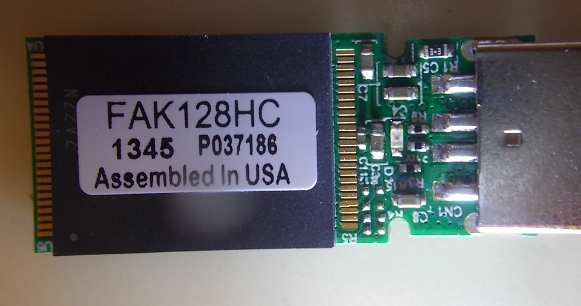

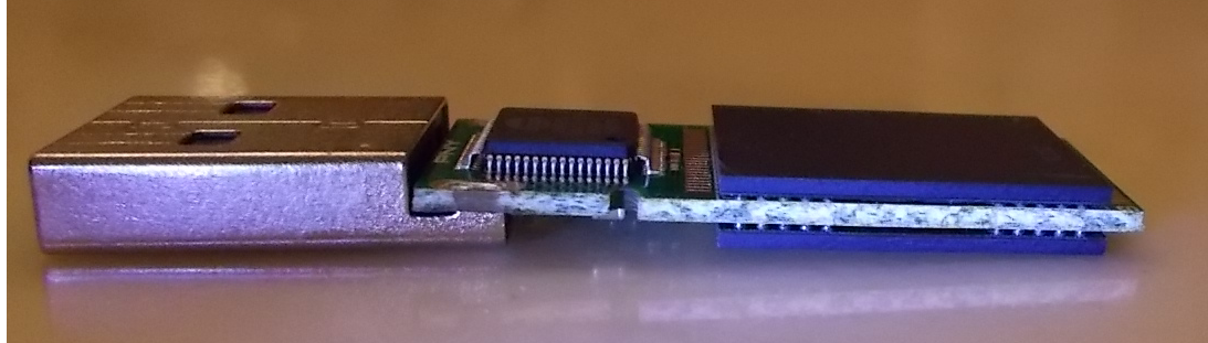

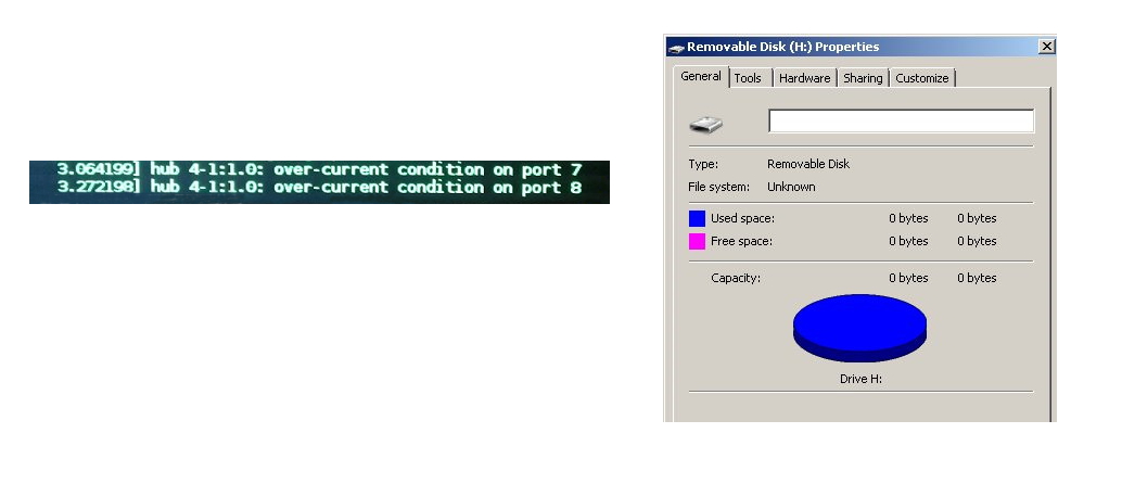

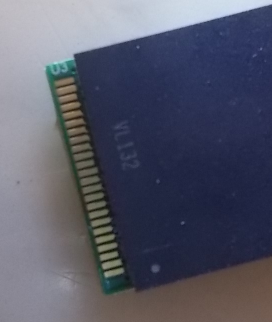

I am a new member of HDD Guru Forums, but I have enjoyed the articles and posts on and off for awhile. I appreciate the quality of this forum and its membership. Storage media and data recovery have been an interest of mine for years, during which time I've had a small number of DIY DR successes. No failures yet.

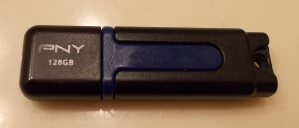

I have a PNY 128GB USB stick that failed immediately when it was connected to a high end, expensive Dell workstation running Windows 7. I connected a sacrificial USB stick to the same port and it developed the same problem. After booting a Linux O/S, I discovered over-current conditions in the system boot log for that USB port. I have no record of the drive's contents except that it contains 80+ GB of work-related files. Some of the data may be proprietary company information. Again, no clear record of that.

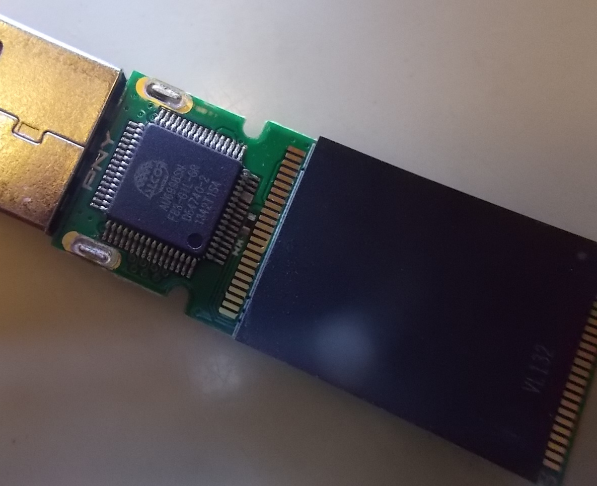

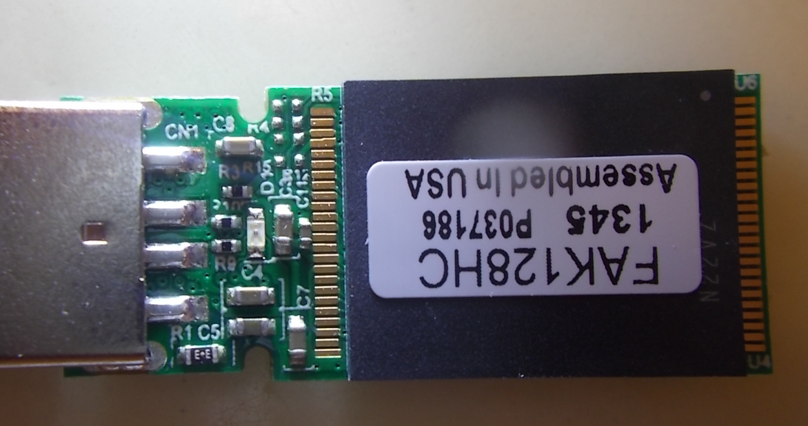

I do not see a fuse on the circuit board, nor do I see any physical defects under magnification. The controller is an Alcor AU6998SN with an integrated fuse and oscillator. I believe it may be damaged.

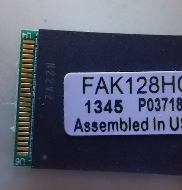

There are two 64GB ball grid array (BGA) NAND chips. I assume these are 8-bit. I'm not able to find information about these chips since they do not bear comprehensive markings. There are no markings underneath the paper sticker. I can get the chips off the board and onto a pogo pin fixture, but I assume that the chip pinouts are not standardized across the industry.
It's likely that successful DR will require chip-off procedures. I am familiar with the work of Bjoern Kerler, Joshua Wise and others. Countering that, I understand the excellent points made by Dmitry in his DIY post here http://forum.hddguru.com/viewtopic.php?f=16&t=12671 This should be a sticky. I realize there are complicating factors that differ with each job and the work should be left to DR professionals, but I do not have budget or clearance to farm the work out at this time.
A few questions for anyone who can spare the time to answer:
    Does my analysis seem to be reasonable up to this point?
    I have another controller chip (identical) but I assume that a controller transplant may be useless or even unwise, correct?
    Is it possible to find data sheets, or even just pinout information, for the NAND chips used in this device?
    This seems like a straightforward recovery, since the chips are intact. What might a commercial data recovery center charge for this?
    Where would I find a competent DR provider in the United States, Canada, or Europe?
    Are they better (training, experience, results) in some countries than others?
    Why do DR agencies think it is their right to retain customer data? This is something I do not see enough discussion on.

you can try to image the drive first. Using a known good windows system with at least 130GB free , insert usb, open DMDE and see if the drive is detected there. ignore any windows messages, and in fact "this drive needs formatting" is welcome at this stage. Don't close the dialog box if it appears.
if drive appears, select drive (not any partitions, but the drive) and try and create an image of it. If it images, then use any recovery software like R-Studio or GetDataBack.
If this does not produce results, then Chip off is required. Without knowing chip it is going to be hard to give any advice.
You are welcome to send to me in AU, PM me for details.
You can try and troubleshoot electronics, but components are not marked well, and may be quite difficult.
transplanting controller is not an option. each one contains firmware configs for the specific nand chips on each device, "set up" individually during manufacture.

I would confirm the voltages present at the Dell USB port. This will tell you what killed the sticks. BTW, have you tried the "sacrificial" stick in another machine?
There is a 3.3 ohm resistor (R1) in series with the +5V input. The voltage drop across R1 will tell you the current drawn by the stick. However, I would prefer to measure the resistance between R1 and ground.
I would also measure the resistance of each capacitor (C3,C4,C5,C7,C8,C11). These capacitors would be filtering the +5V input and the +3.3V supply for the NAND chips. The 3.3V LDO regulator would be embedded within the controller. A low resistance across the 3.3V supply would cast doubt on the health of the NAND chips.
As for the flash pinout, ISTM that a "chip-off" recovery may be unnecessary, even if the controller is dead. I say this because AFAICT the PCB appears to be a dual purpose type that can accommodate NAND chips with either TSOP-48 or BGA pinouts. You could confirm the TSOP-48 pinout by starting with the known (?) pinout of the controller and then testing for continuity between the controller and the TSOP pads. You would then use a fine saw to cut through the PCB between the controller and NAND pair, leaving just the TSOP stub.

Controller transplant is not so save for data. Nands model in this case is BGA152. You can check electronic, like fzabkar suggest, but I think in this case chip-off recovery will be needed. This controller like use bad columns even in standard chip, so it could be tricky solution.

aside from what Arvika has already mentioned, there is added complexity with BGA chips. The pinouts of these can be mirrored with 1 set of control and DATA separate from another and in some cases 4 different sets of pinouts. the TSOP pads do not simply route to the BGA pads on a 1:1.
If a TSOP is soldered on, the Mass production tool is configured so, and appropriate discretes used in conjunction if required. If a BGA chip is used, then this can have other routed traces going to extra channels on the controller. many PCBs have various configurations of controller revisions, NAND chips and support components factored into the design. you see this by a TSOP/BGA mix board and unpopulated component pads.
The easiest method for this recovery is a flash recovery person to unsolder BGA chips and go from there.
some common BGA chips have some issues with reading that need to be addressed, only possible with commercial chip reading gear and their associated configuration settings, or I guess buying other flash reading tools and copying the commercial ones methods.
the data is going to need a XOR Key applied and mix of wear levelling sorted out, along with any corrections to blocks that are in conflict.
Does my analysis seem to be reasonable up to this point?.
I really don't see any analysis done yet, aside from no defects noticed when magnified. Rarely do you see a flash drive with components "blown" visually. And so far, it is quite unclear how many cases have been from failed components, or components out of spec. I am meaning any real provable evidence.
correct
If you can identify what it is, you may be able to.
This statement is false, the chips being intact has no bearing on how successful the recovery might be.
What might a commercial data recovery centre charge for this?
Anywhere from $150(very low) to $800 at a rough guess, but there is no way to know without going through the process with a chosen company and getting a quote/price.

Thanks. I now notice that arvika mentioned BGA-152. Your post prompted me to look more closely at the OP's AU6998SN controller. I see that it has 64 pins and is the GIL version whereas I had been looking at the 48-pin GHL version:
http://gif.datasheetbank.com/image/Unsp ... 139859.gif
The latter supports TSOP and LGA flash chips, and its 8-bit reference circuit (http://www.users.on.net/~fzabkar/AU69XXGHL_ref_cct.rar) does appear to have a 1:1 correspondence. I can't find a circuit or pinout diagram for the GIL version, though.
That said, I wonder if it would still be easier/safer to remove the controller and gain access to the NANDs via the controller's pins.
I also notice that there are two supplies, 3.3V and 1.8V, rather than a single 3.3V supply.

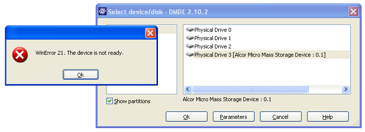

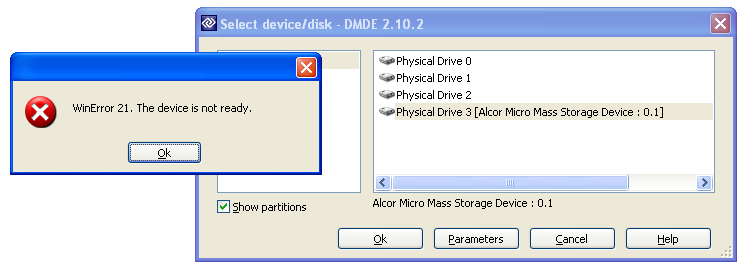

Good advice. I already tried to mount the drive on a Linux system to image it there, and I couldn't get it to mount. Same type of problem with DMDE in Windows--the drive is never ready. DMDE allows a parameter to not wait if the drive is not ready, but the 'OK' button on that window is grayed out (because the drive is not ready). The drive can't be mounted.

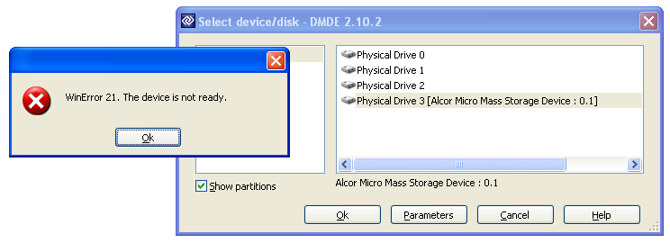

I must agree with Amarbir about poor product quality for Dell, and not just for this case. This machine was less than one week old when the incident happened. But it was the third machine delivered by Dell because the first two were built wrong compared to the order. The workstation has other problems in addition to the USB port (which is now sealed against further use). Video problems, hard drive problems.. our enterprise sees low quality (but high priced) Dell workstations all the time. This one is a T3610, not supposed to be a cheap machine.
There is a 3.3 ohm resistor (R1) in series with the +5V input. The voltage drop across R1 will tell you the current drawn by the stick. However, I would prefer to measure the resistance between R1 and ground. ... I would also measure the resistance of each capacitor (C3,C4,C5,C7,C8,C11). .. As for the flash pinout, ISTM that a "chip-off" recovery may be unnecessary, even if the controller is dead.
I did try the sacrificial stick in another machine. It came up as an unformatted unknown device. Same as this one. I haven't connected anything else to that port ever since, but I can check the voltages on it.
From my DMDE screenshot, the Alcor controller is recognized. So not completely dead as I thought it was, but I get a Device Not Ready error constantly. Same problem in Linux--the device can't be mounted.
I will also take some resistance readings as suggested.

DM Disk Editor can see the flash drive, and recognizes the controller (somehow). But the device is not ready and can't be made ready. I had the same problem when I tried to image the drive in Linux. It wouldn't mount.

IMHO, this is just a chip off recovery.

AFAICT, PNY drives should report a USB Vendor ID of 0x154B whereas Alcor's VID is 0x058F. I have no knowledge of flash devices, but whenever a USB bridge IC reports the bridge manufacturer's PID and VID rather than the OEM ID of the device, this usually indicates a firmware or hardware problem.
I would measure the voltage across each of the capacitors. You should find +3.3V, +1.8V and +5.0V. The voltage across the 3.3 ohm resistor would be a useful indicator also. If either the 3.3V or 1.8V supply is missing, then test for a shorted capacitor.
