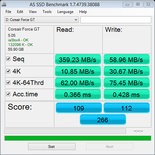

Is it normal for this device to have such big discrepancies between read and write? Firmware up to date, everything installed and normal, it just doesn't want to work. Am i missing something ?
as-ssd-bench Corsair Force GT 26-Apr-15 16-22-51.png [ 29.27 KiB | Viewed 9637 times ]

I have never bothered to familiarise myself with the numbers, as flash varies so much. but reading flash is always a lot quicker than writing. same with USB drives, SD Cards(these often have speeds on the labels/packaging). reading Flash is straightforward. reading and writing are different electronically, and operating system-wise in flash.

Would such a symptom be consistent with a drive that was running out of spare blocks?
Does the SMART report look OK?

Hello nicolae788
For this model of SSD,
A> You are getting quite good performance numbers. :D
B> for the lower capacity model (60GB) This is normal..
This is a generation 1 Sandforce SSD which uses Dynamic write compression, which means your write speed will vary depending on how compressible the data is that you write to it.
AS-SSD writes incompressible data for its benchmark stream and so you are looking at the worst case write scenario. (this is the performance you would get writing a large MP4 file or similar)
With compressible data (big txt files or documents) it could jump up to 150 / 200 MB/s
Unfortunately on the 60GB model you are bottle-necked by the fact that internally the drive only uses 2 write channels. the 120GB+ uses 4 and so the write performance increases exponentially.
