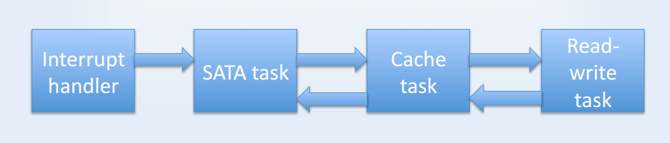

I have been playing around with some SSDs. Remember I don't have PC3K, so anyone that knows all this, give me some slack!
I have a Indilinx IDX300M00-BC
with J3 1-2
Baud 115200
console output:
sata_task started: S= DRIVE_IDLE_STATE
drive state: DRIVE_SEND_ERROR_STATUS_STATE
Anyone know any unbricking hints for this drive, has seen this output before and can give me some info?
Thanks in advance

This may sound silly, but is there any chance that the fw is corrupted ?
I ask this because:
