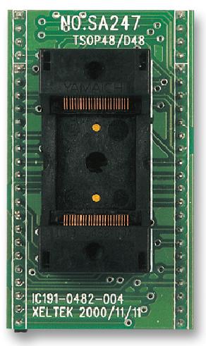

Hey guys, I've bough this adapter with the hopes of connecting it to a FTDI2232H breakout board for some testing.
Perhaps due to my lack of understanding on electronics I'm not able to understand the pinouts of the Xeltek TSOP48 SA247 ADAPTER.
Is there a datasheet I'm not being able to google anywhere ?
Thanks! :roll:

http://www.microport.com.tw/product-dm/ ... 7-b005.pdf
http://wiki.laptop.org/images/1/1b/CL1_NAND_Hynix.pdf

Well, I didn't find very hard inserting the nand chip on the adapter, I just don't understand how to connect it to the FTDI board.
Take for example this pdf, figure 13. (I'm having trouble wiring this)
https://www.blackhat.com/docs/us-14/mat ... fit-WP.pdf
thanks in advance for sharing your knowledge.

I don't understand your problem. I would think that the adapter's PCB and socket pinouts would have a 1:1 correspondence. You can verify this with a multimeter.
So pin #1 in your photo would be at the top left corner, pin #24 at the bottom left, pin #25 at the bottom right, and pin #48 at the top right corner.
You would then connect your FT2232H to the NAND as per Figure 6. Of course the NAND requires a 3.3V supply.
I'll check it with a multimeter, but I think I can sort it out now.
I'll post some pictures after I got it done :)

today I've soldered the remaining wires, thank you fzabkar for your help!
I'll post some photos once I'm in the office!

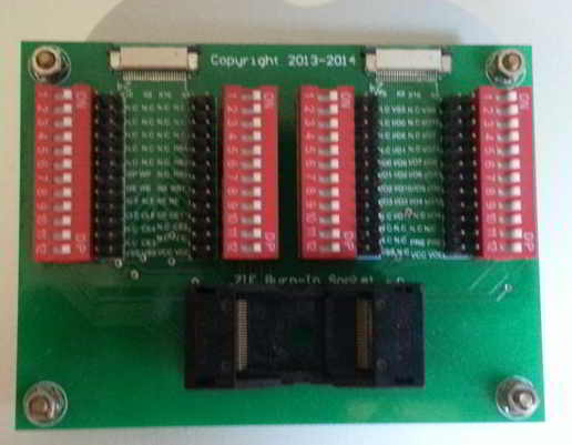

Rather than screwing about I built this baby... it takes/exchanges sockets, and allows switching of signals for fault finding:
I then just build the attachments I need, yep that is a 'bus blaster', but I also have custom FPGA boards as well.

That looks nice, how well does it work ?
