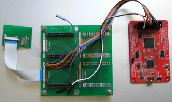

Rather than screwing about I built this baby... it takes/exchanges sockets, and allows switching of signals for fault finding:
I then just build the attachments I need, yep that is a 'bus blaster', but I also have custom FPGA boards as well.

code_slave wrote:
DRUG wrote:Hey guys, I've bough this adapter with the hopes of connecting it to a FTDI2232H breakout board for some testing.
Perhaps due to my lack of understanding on electronics I'm not able to understand the pinouts of the Xeltek TSOP48 SA247 ADAPTER.
Is there a datasheet I'm not being able to google anywhere ?
Thanks! :roll:
That looks nice, how well does it work ?
