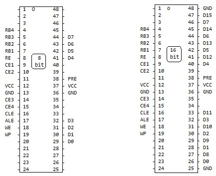

Does anyone has the pinnout for this chip ?

should be standard 8-bit ONFI pinout with 2 CE's I think

One thing, in the 8 bit onfi standard CE1 is pin 9 and RB1 is pin 7 right ? I'll just have o struggle on where does that connects on the FTDI.

FTDI BDBUS6 --> NAND CE (9)
FTDI BDBUS7 -->NAND RB (7)
from BH Talk pdf

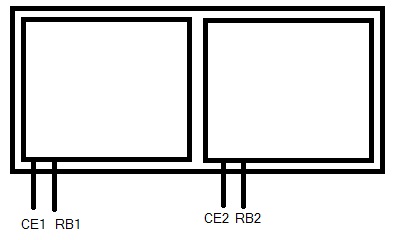

oh yes, I wasn't understanding that BH was blackhat, what about CE2 and RB2 ?
don't make it so hard
FTDI BDBUS6 --> NAND CE (10)
FTDI BDBUS7 -->NAND RB (6)
 Post subject: Re: HYNX HY27UV0BG5M
PostPosted: June 1st, 2015, 21:26
Posts: 3975
just to expand on jermy, you read with
then disconnect from NAND chip 9 and 7, then read again with:
1 chip, but 2 dumps

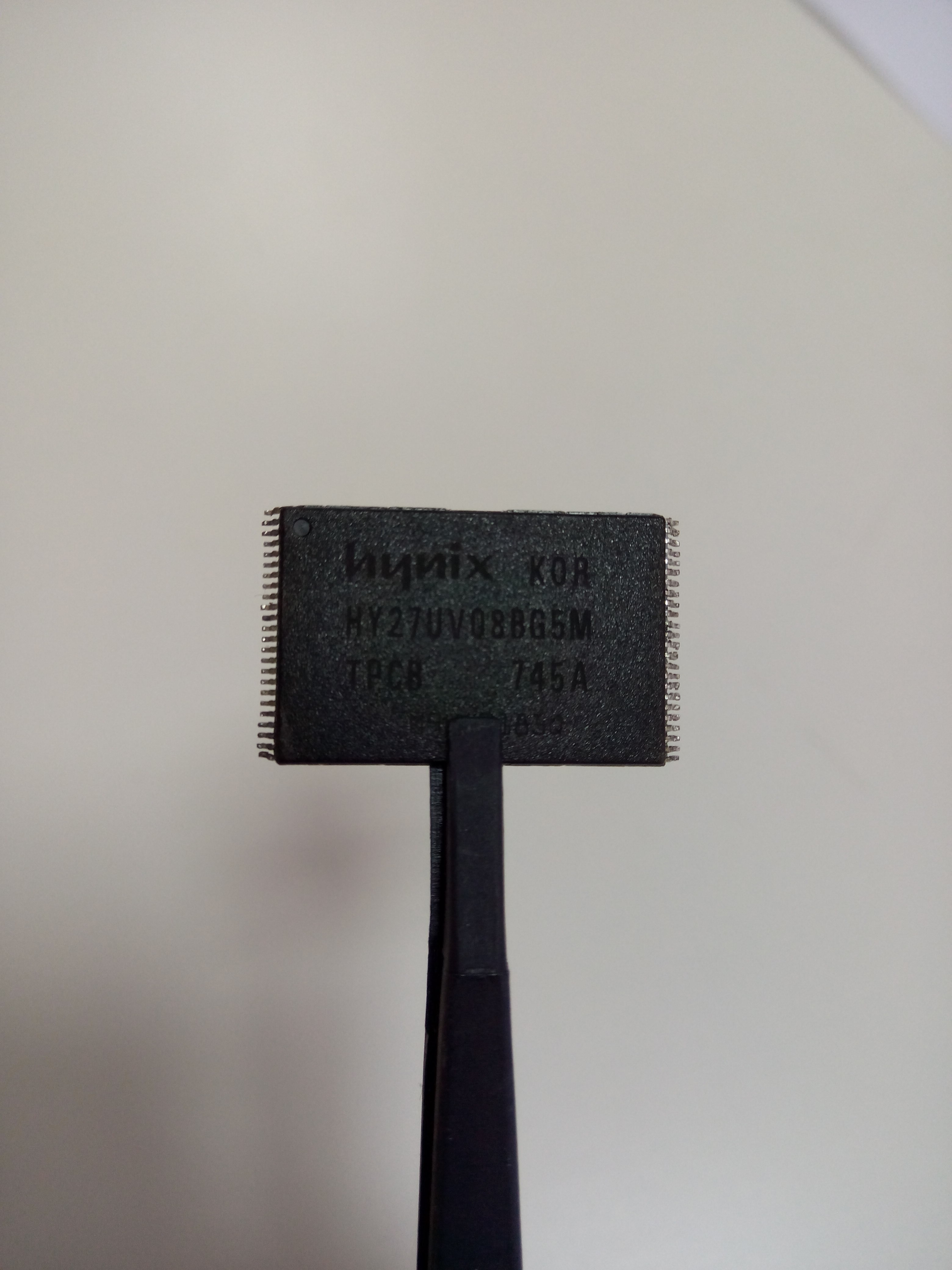

mr DRUG.. can you put up a photo of the chip?
Here it is:
PostPosted: June 2nd, 2015, 6:35
Posts: 3975
Ok, thanks for pic. just an observation on the pins.. do you have a microscope? I would be checking between the pins for shorts and cleaning them a little. I use a sharp box-cutter knife blade and some 1200grit wet&dry sand paper. scraping the blade really gently to shave off the solder is the way, and be extremely careful.
