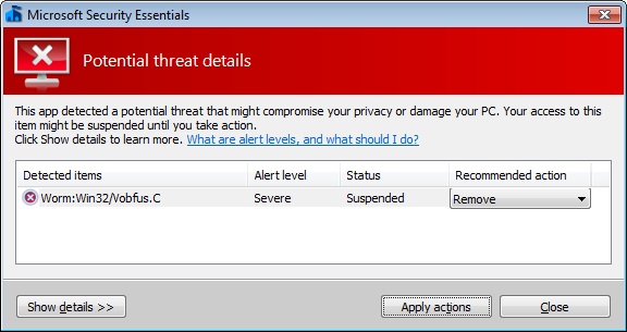

First, 2 1GB "EasyDisk" flash drives with an interesting bonus.. 2 separate types of malware! One of them was an interesting one with its own VM, the other a fairly standard hidden extra set of files. Both didn't look very new and I wouldn't be surprised if the seller had no clue, and probably has malware running rampant.

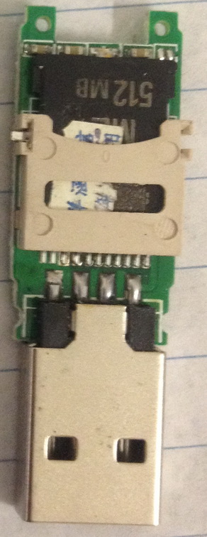

the third one was quite interesting. Opening it up and I see the controllers I've started seeing around, IDE5019SN-G-2 which looks like a rebadged Alcor, or rip-off of them.
NAND was strange, looks like a MicroSD card that hasn't been shaped into one.. haven't done any testing on this one yet.

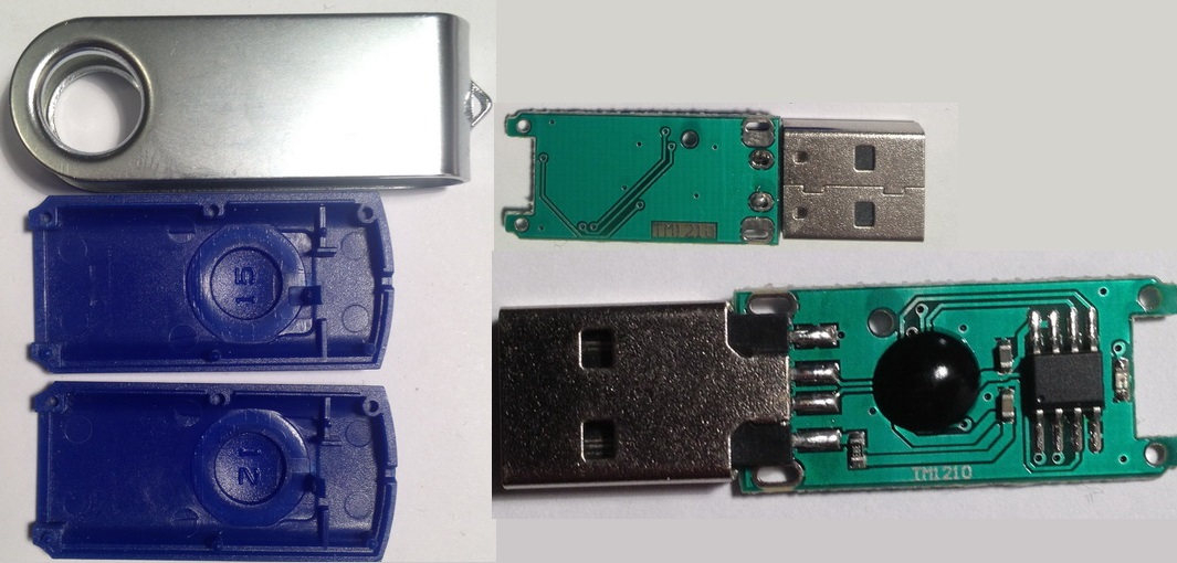

The last one definitely deserves a mention. opening it up and you know straight away there is Shenanigans afoot.
Definitely not what is reported!!

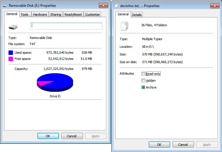

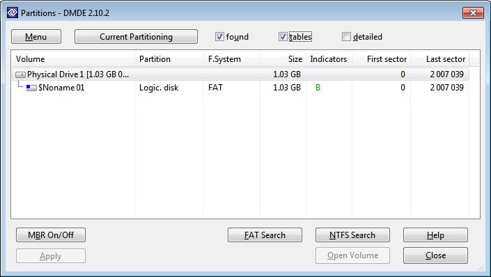

Testing failed.. no surprise, but what it did with files was interesting. I copied 900 or so GB to it, which succeeded, and the device showed the files on there after a re-insertion. but selecting all and asking for the size showed wrongly.
trying to copy files off it, well it did copy files, some actually were intact, but folders were empty, and most files, even though showing correct size, were full of 00 00 00's.
funnily enough, DMDE imaged it.. though full of zero's !
It seems like a lot of effort to go to coding up a thing like this?

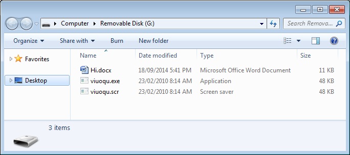

Got a few more coming, would be interesting to see what they bring. 2 today, a 16GB Sandisk, hoping it sported a controller I didn't have, but no already have a few. the 256MB one was interesting. first I thought maybe it was on purpose, but then I remembered around 2012, every 2nd USB stick had malware on it.. literally was everywhere. So I am not reading too much into this one, and didn't bother contacting the seller.
interesting fies.. I am NOT opening the docx ;)
oh yes :)

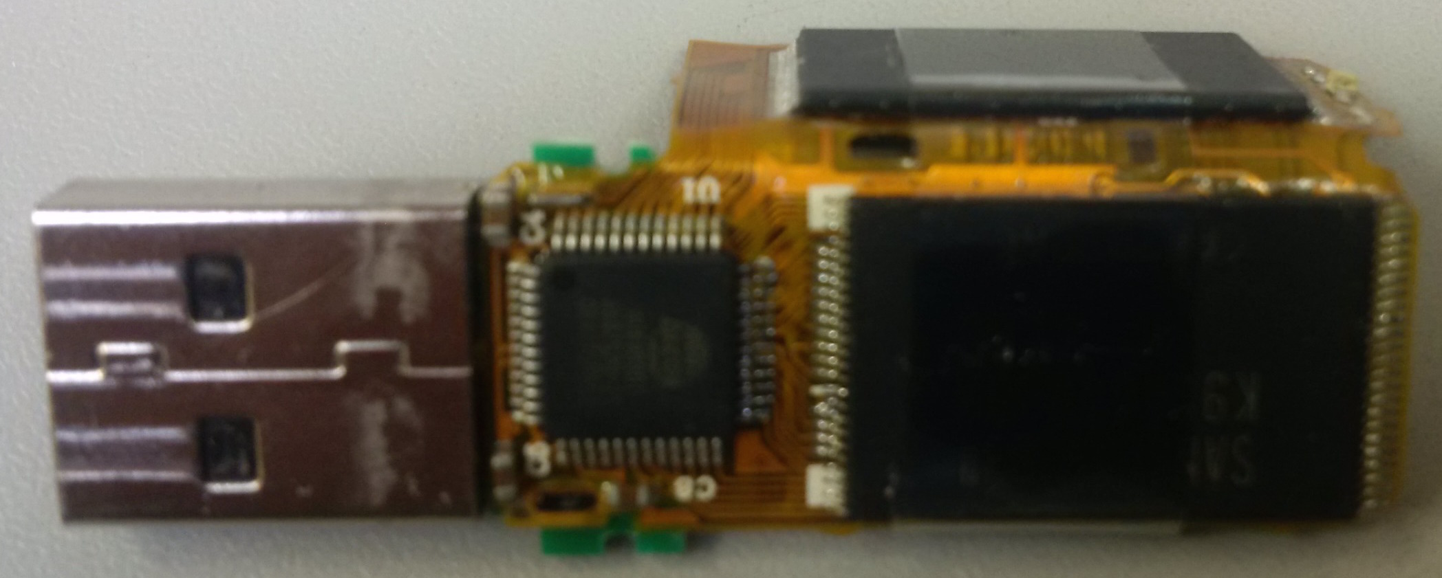

I'm not sure where the client bought this 8GB thumb drive, but felt it was worthy to add to the wall of weird:
Kingston did something weird like that for their 64GB USB 3.0 Flash Drives, two PCB's sandwiched between a flex pcb.
Recover My Flash Drive
 Post subject: Re: Strange things from eBay
PostPosted: June 16th, 2015, 4:13
Joined: August 8th, 2014, 4:31
Posts: 37
Location: South Wales (UK)
that last one....
I would say approx 2 years ago I was getting things like that quite regular.. 3-5 units a week
Those Flexi PCB / Ribbon substrate things went in and out of fashion very quickly.
and Im glad about it :)

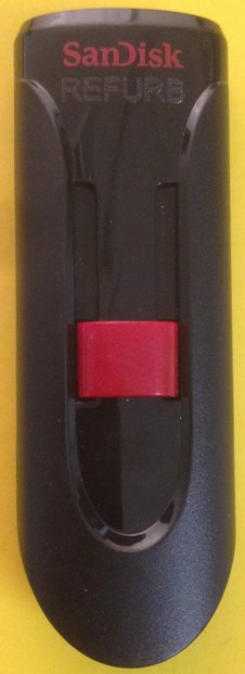

Never seen "REFURB" lasered onto the outside of cases..
This one is 32GB, with an original Sandisk Controller and NAND chip, seems to have full capacity and works fine.
PostPosted: July 3rd, 2015, 4:01
Posts: 922
HaQue wrote:
...seems to have full capacity and works fine.
But how long? ;)
PostPosted: July 3rd, 2015, 6:13
Posts: 3975
Good Point!
I am trying to get as many Sandisk as Possible to build up a stockpile of all controller revisions. But alas this was a very common 82-00514-5 that's around in 1/2 of the current stocked shelves
