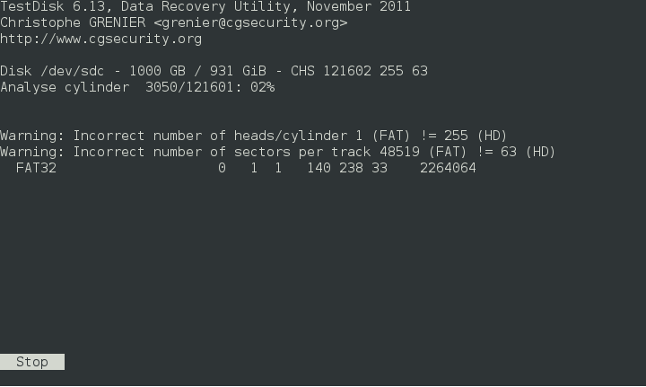

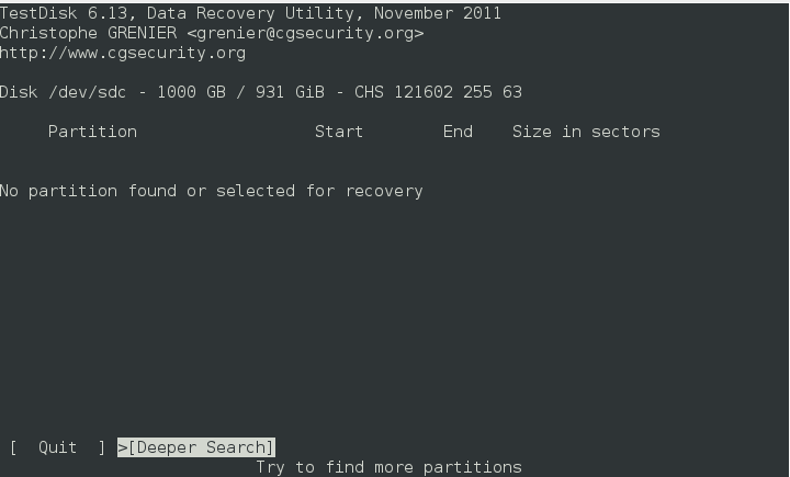

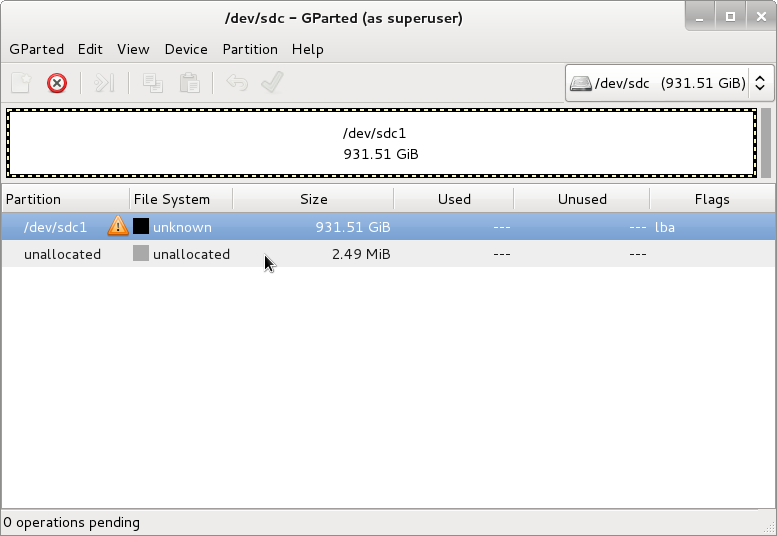

Hello.
My External HDD become Raw and I can't open it, In Windows OS to show me "Format disk" and I want to know can I fix it without format?
I attached some photos and need your advice.
How about below link :
http://html5.litten.com/how-to-fix-exte ... ecame-raw/
I did it and show me "Deep Search" without any partition and I did Deep search.
Can it lost my data?

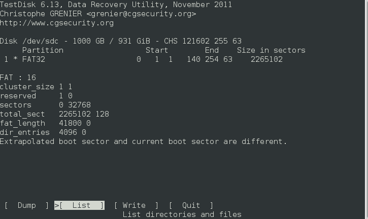

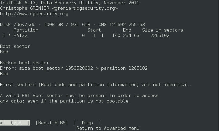

it is Silicon Power.
After Deep search it show me "Rebuilding BS" and after it when I select "List" not any file shown
Ok, not 100% but from I know about these, they don't have any encryption. Is this correct?
 Post subject: Re: External HDD become RAW and I don't like to format it :(
PostPosted: July 7th, 2015, 11:59
Yes, if photorec isn't at least finding some files in RAW it's likely an encryption issue. Can you provide a picture of the original USB bridge board?
That or this is a simple sector size issue. Are you directly SATA connected, or using some sort of USB adapter? I know that some adapters can't handle 4K sector drives properly.
