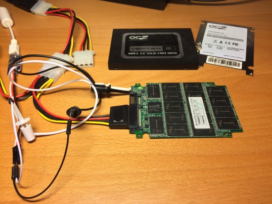

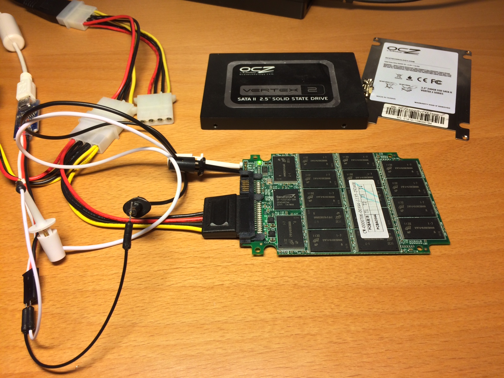

Hi
My OCZ Vertex 2 240GB died, i.e. it's not recognized anymore through the SATA interface.
I opened that brick, and hooked it to a USB UART to see the following output (115200,8,N,1)
CLI> PINRST
*** ROM 106 Mar 12 2009 20:29:35 ***
FW_SRC 0 SHA PASS!
*** EEPROM 207 Jan  3 2011 18:36:47 BuildServer:FW_Common_Critical_Fixes:P1_EEPROM_2_0_7_drop-290232 ***
IMFT25 Timing EPch
*** Patch 1.4.1 Apr  8 2011 01:02:02 BuildServer:P1_3_6_1_MP4_Patch1_20110408:P1_3_6_1_MP4_Patch1_20110408-305073 ***
IMFT25 Timing EPch
RCPch SAK0
GetRootRecord(): Failed to read Root FID=2, IBA=7!
IMFT25 Timing EPch
... followed by ca. 2kB binary stuff ...

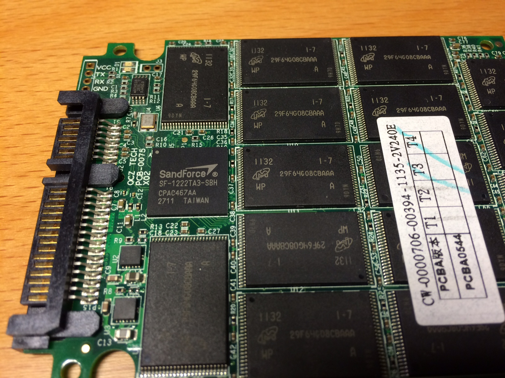

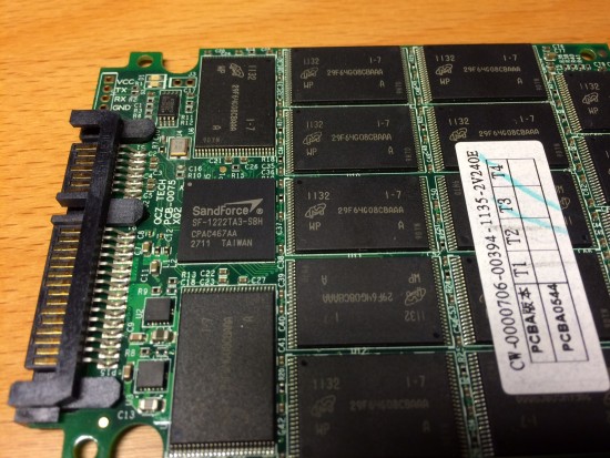

Does anyone know what this error means (what's FID and IBA?), or has an idea how to proceed?
OCZSSD2-2VTXE240G
SandForce SF1222TA3-SBH, production 2711
ATH116 2ECL EEPROM
No JTAG interface on the 240GB PCB anymore -- or are the testpoints on the backside the JTAG IF?

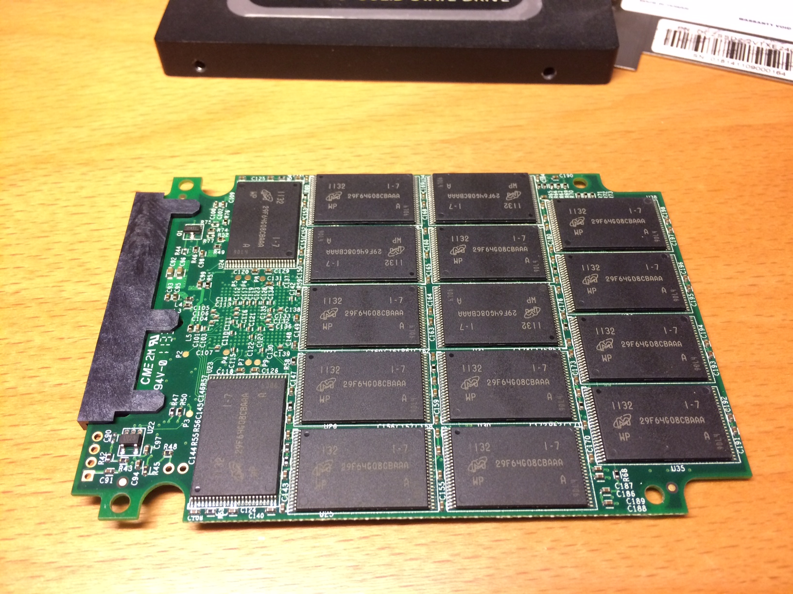

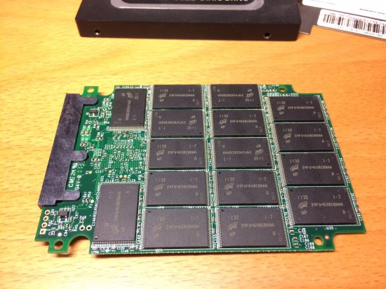

Top side detail, bottom side with testpoints. Not much space left on the PCB :lol:

It is not clear what is the main goal, data recovery or repair. Incase of repair it is easy to do with Genesis tool.
Regarding JTag , you need purchase specific one from Latice, and it is usefull only to reprorgam supewiser chip which sends Reset to MCU and operates with all POWR regulators.
