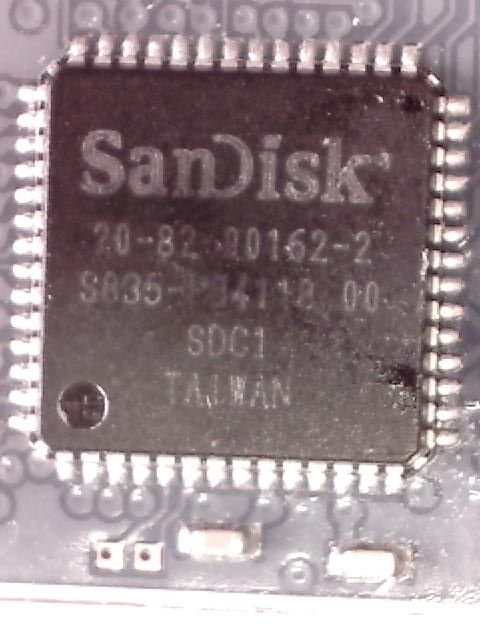

Hello, I'm trying to recover data urgently off of a Sandisk USB drive. The PCB has a crack in it near the port (no surprise). I was able to trace where all the connections go except for the VCC. It seems that it's not making it to the controller and it ducks under to a lower layer in the PCB where I can't visually trace it.
Here's a picture of the controller:
Can someone tell me where the VCC goes to on it? I know this may be a noob question, but I'm not typically a flash guy (usually I send the difficult ones out, but no time on this one).

I know it's usually the bottom right corner, but I don't want to take a guess and be wrong..

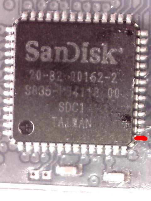

Controller 20-82-00162-3 has VCC in this place (red mark). It should be same in 20-82-00162-2.

Ok, thanks a million. That's the one I though it was, but wanted to be sure.
Unfortunately even after powering there, I still get nothing from the thumb drive... I'm thinking that the PCB may have shorted the controller when it cracked and now it might be toast...
Any ideas?

@jermy: this controller crypt data so PCB must be repaired.
@data-medics: you must use microscope and verify the traces and controller pads. Sandisk sometimes has traces inside PCB and it could be quite problematic to regenerate but from my experience usually it is possible.

As Brian said, Sandisk flash PCB quite often have few layers of traces, even inside PCB. To repair it you must check damage under microscope, find where is broken and make shorting with thin wire.
